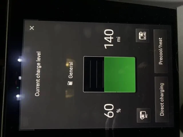

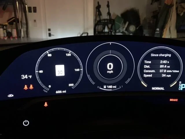

Ok more data from driving in Range mode. Temps were a little warmer around 45F. I drove around for 90 miles, charge started at 100%, ended at 60%. So by actual usage my total range would be 225 miles. Drove gently but not slow again, and full comfort settings, with 2 preconditioning before leaving while car was parked. Car shows a range of 140 miles remaining, so a GOM total of 230 (not that far off my calculation). Mixed driving conditions.
This is much better than the EPA mileage implies.
