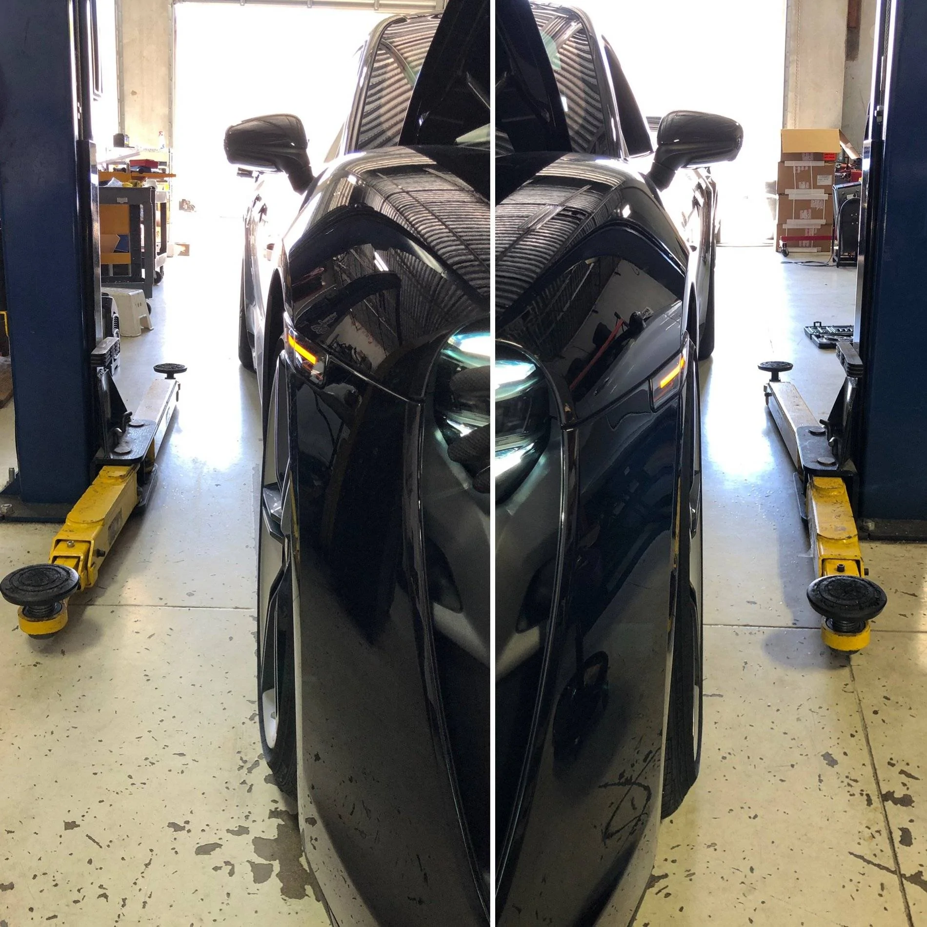

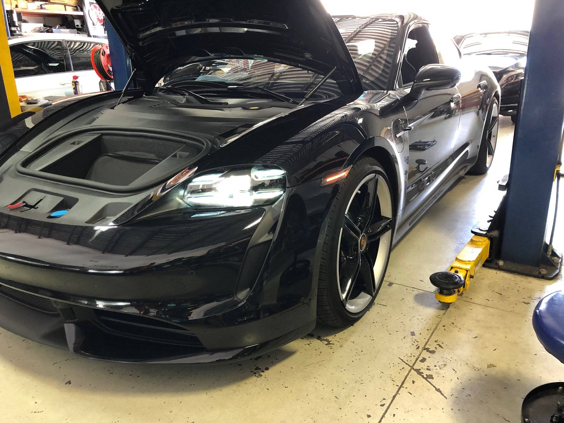

I ended up passing on the spacers. But here are 2 pics showing what they look like installed. On the split photo the right side shows the rims with spacers installed and left side is stock. So I just did the window tinting and PPF (Suntek Ultra).

Sorry to disappoint you @Chowster but I ended up passing on the spacers. But here are 2 pics showing what they look like installed. On the split photo the right side shows the rims with spacers installed and left side is stock. So I just did the window tinting and PPF (Suntek Ultra).

Thanks so much for the photos. I guess there wasn't any driving done with the spacers on to test for rubbing and clearance? The front looks a bit too much.... maybe 10mm on both front and rear might be the way to go for me.
