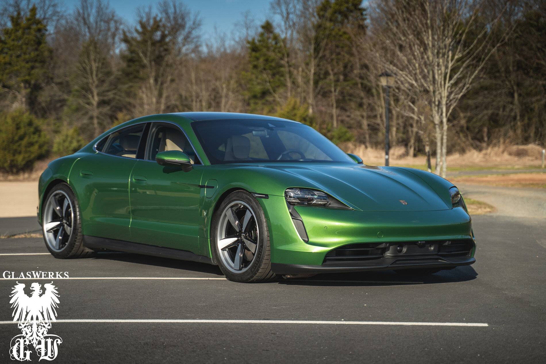

I'm told these are the largest rear tires ever installed on a Taycan, and they work perfectly. Here are the details compared to the original 20" Turbo Aero wheel set.
Porsche Taycan Taycan Wheel & Tire Specs -- Bolt Pattern, Center Bore, Thread Size, Offsets, Tire Sizes 855492F3-A7E6-421E-82DE-923204C33B74
