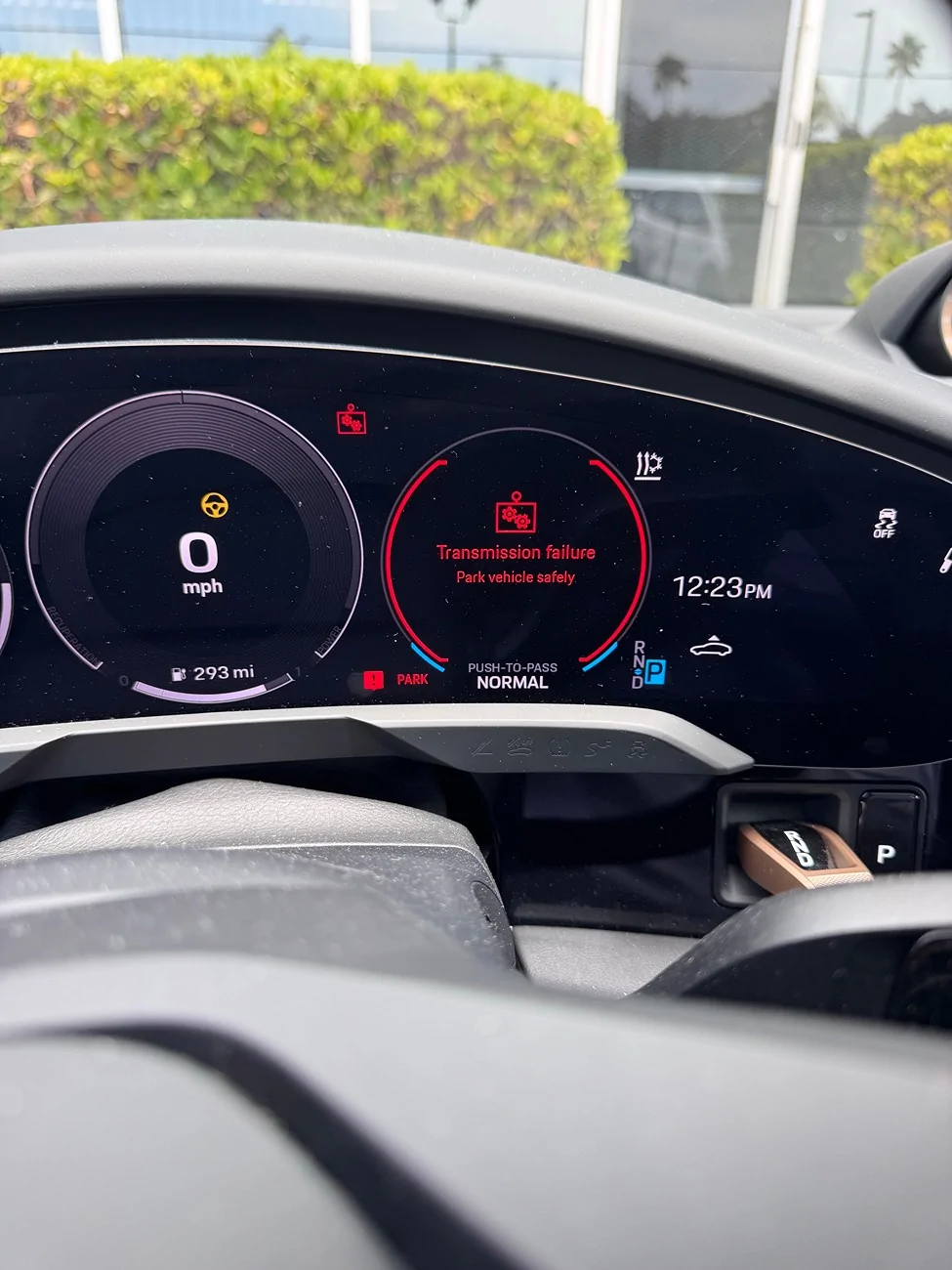

I finally received my car back and learned the motor and transmission were both replaced. Curious if others have had both replaced. My car has under 6,000 miles on it

Sure that would have been a special bill. Did they say what happened?

The invoice indicated that after they checked the wiring harness faults remained so they were advised by manufacturer to replace transmission. Faults still remained so then they were advised to change the motor which cleared the fault messages. All covered under warranty but I have no engineering details as to what the underlying issue was

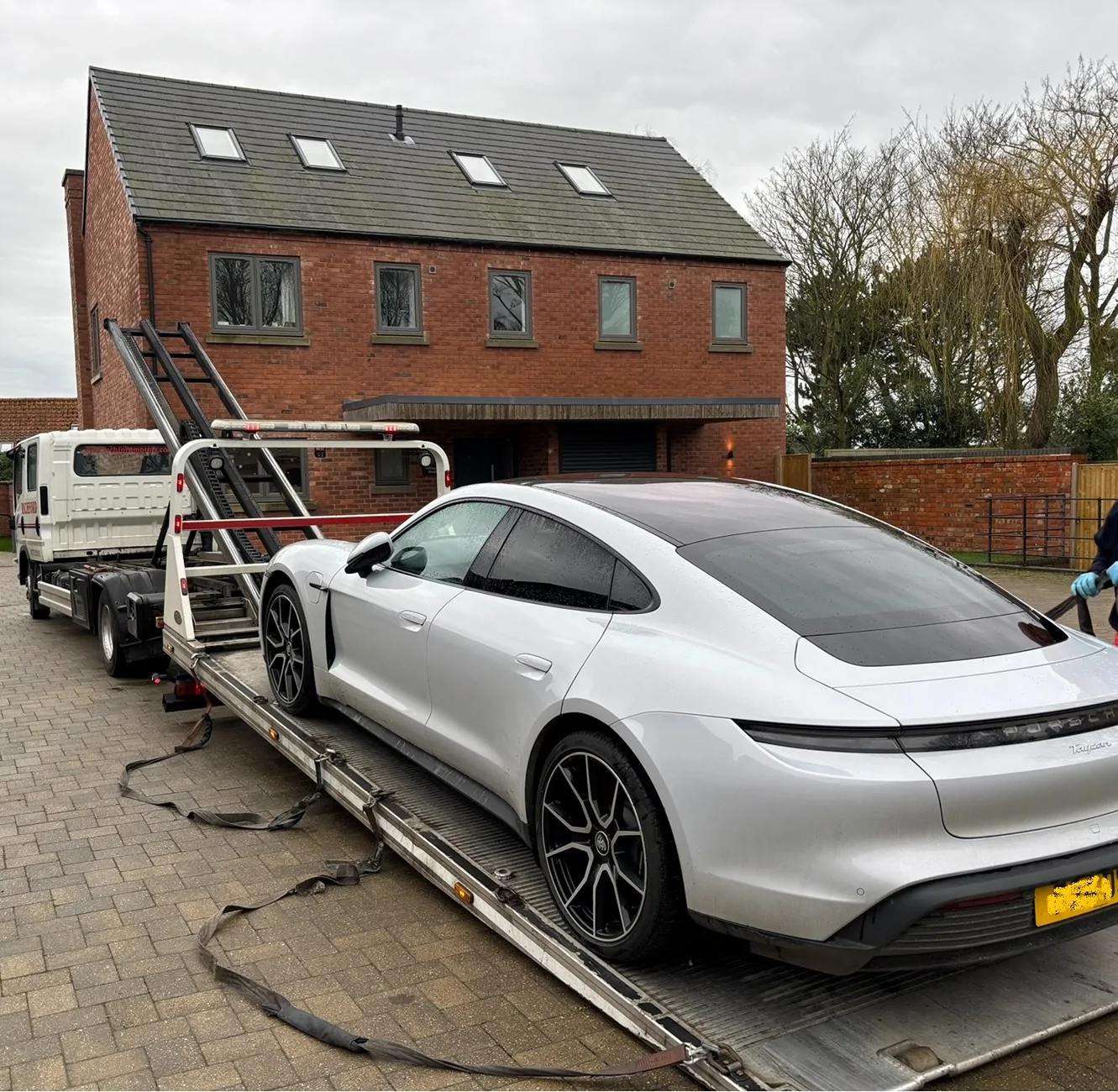

Got the same transmission failure warning light. Porsche assist sent out the AA who checked fault codes and disconnected 12v then reset fault codes. Warning message still on but i can put it into drive so drove down the road, warning stayed on and the car is in limp mode. Looks like a recovery back to the dealership tomorrow.
Reading the many threads on this and the many instances of this happening, the conclusions are more limited. The OP's fix was a new motor, is that the most likely outcome or have others had a software or senor reset at the dealership? Luckily still in warranty, but I'll be extending the warranty anyway, this has confirmed the decision when i get there.

Porsche Taycan Transmission warning light taycan recovery jan26
Now at the dealership awaiting diagnosis! Got a loaner Mecan, first petrol car I've used since I sold my Z4 in 2012. Recovery driver who contracts for Porsche assist said he has picked up quite a few Taycans recently.
Update - the fault was a loose wire in a connector to the transmission fluid electric pump.
