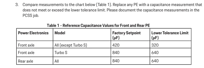

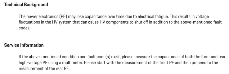

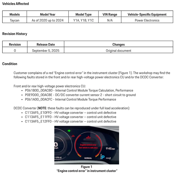

Customer complains of a red “Engine control error” in the instrument cluster (Figure 1).
https://static.nhtsa.gov/odi/tsbs/2025/MC-11023947-0001.pdf
Updated TSB: https://static.nhtsa.gov/odi/tsbs/2025/MC-11024070-0001.pdf
Updated TSB dated April 16, 2026: https://static.nhtsa.gov/odi/tsbs/2026/MC-11032386-0001.pdf
Updated TSB dated May 11, 2026: https://static.nhtsa.gov/odi/tsbs/2026/MC-11033593-0001.pdf
