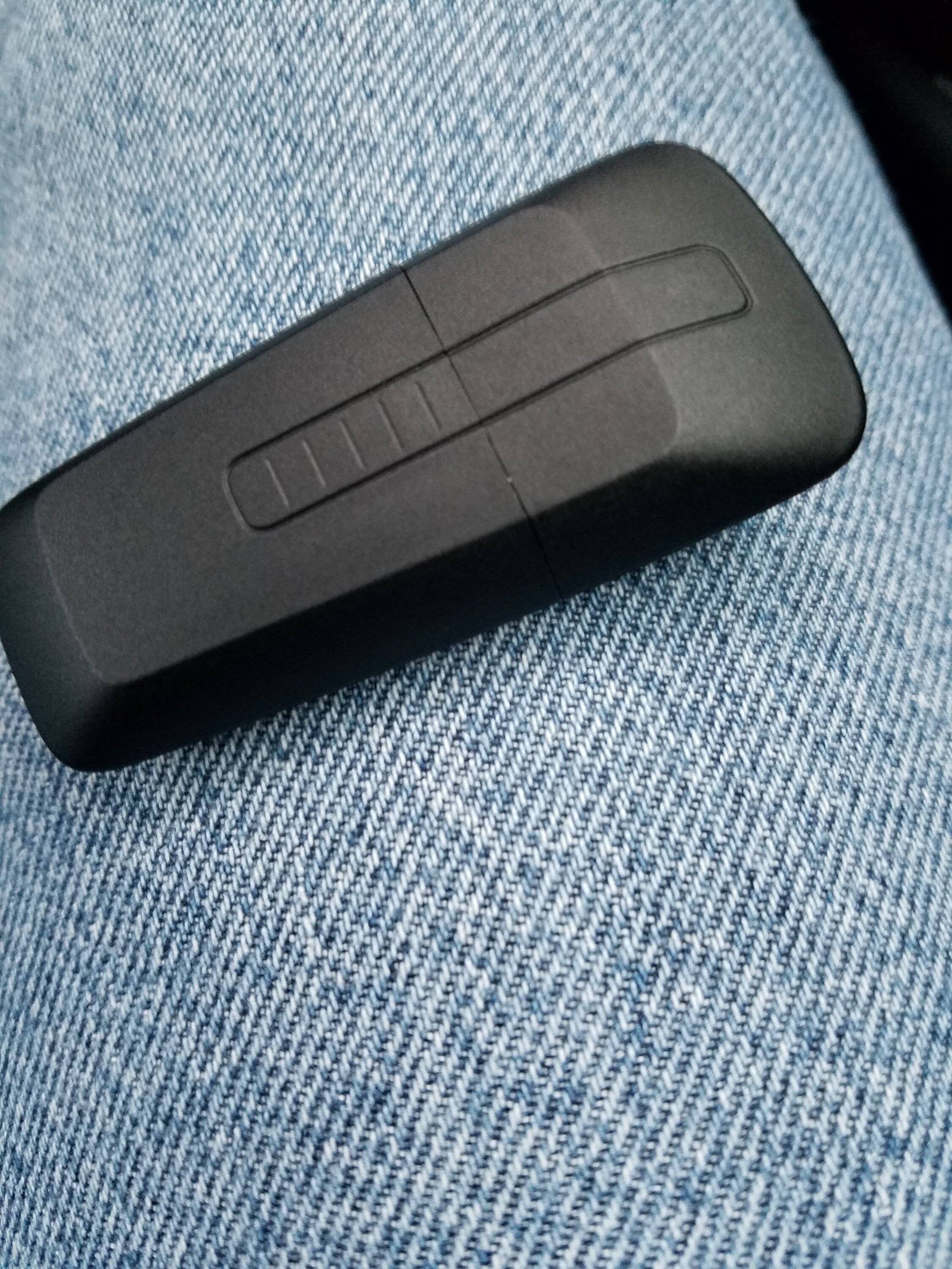

Found this two objects in the glove box. Can anyone tell me what is it?
This is the Porsche tracker fob. You would have paid for this at new car collection time (circa €310 in Ireland)
I would have expected the Porsche Centre would have talked through this, it’s features and how it worked on receipt of the car. I’d recommend contacting the dealer to confirm it is active.

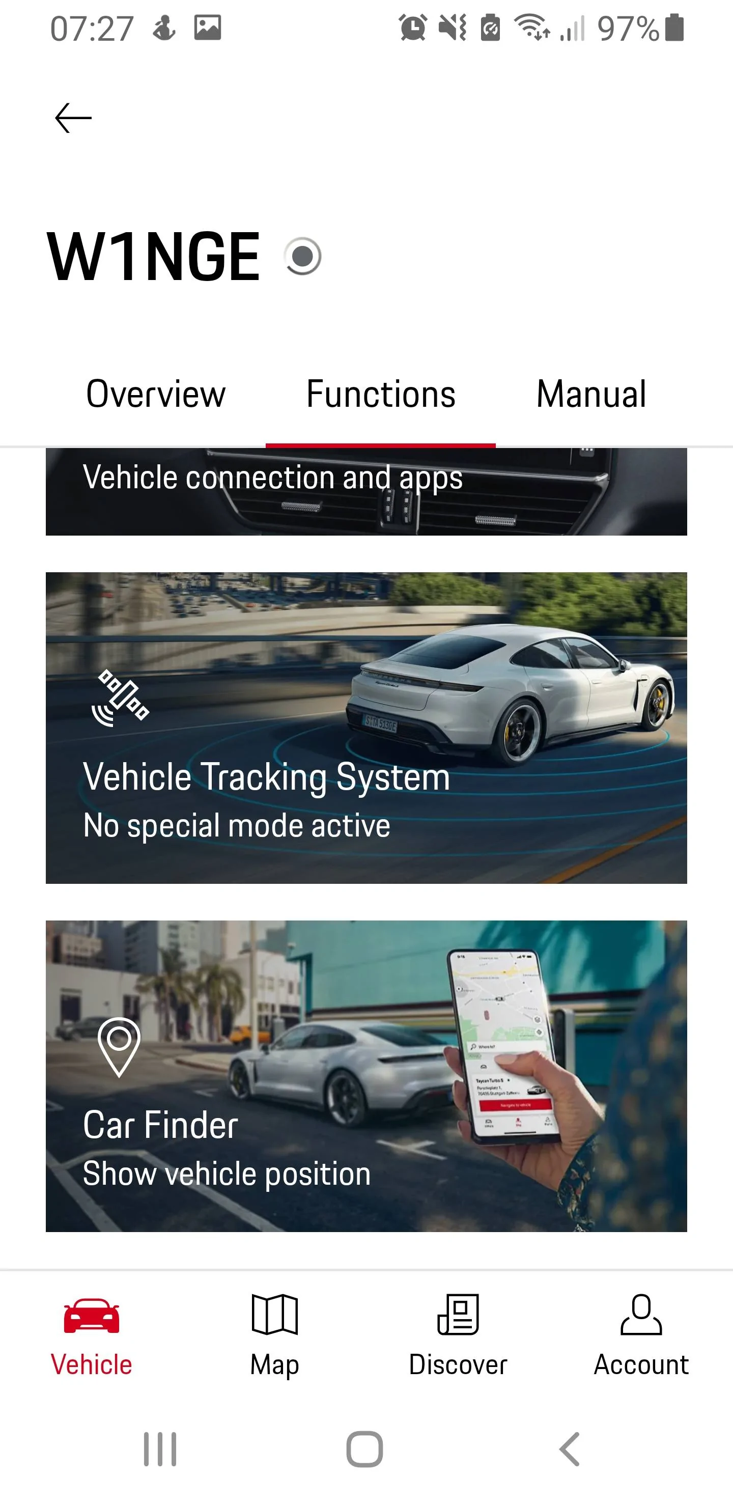

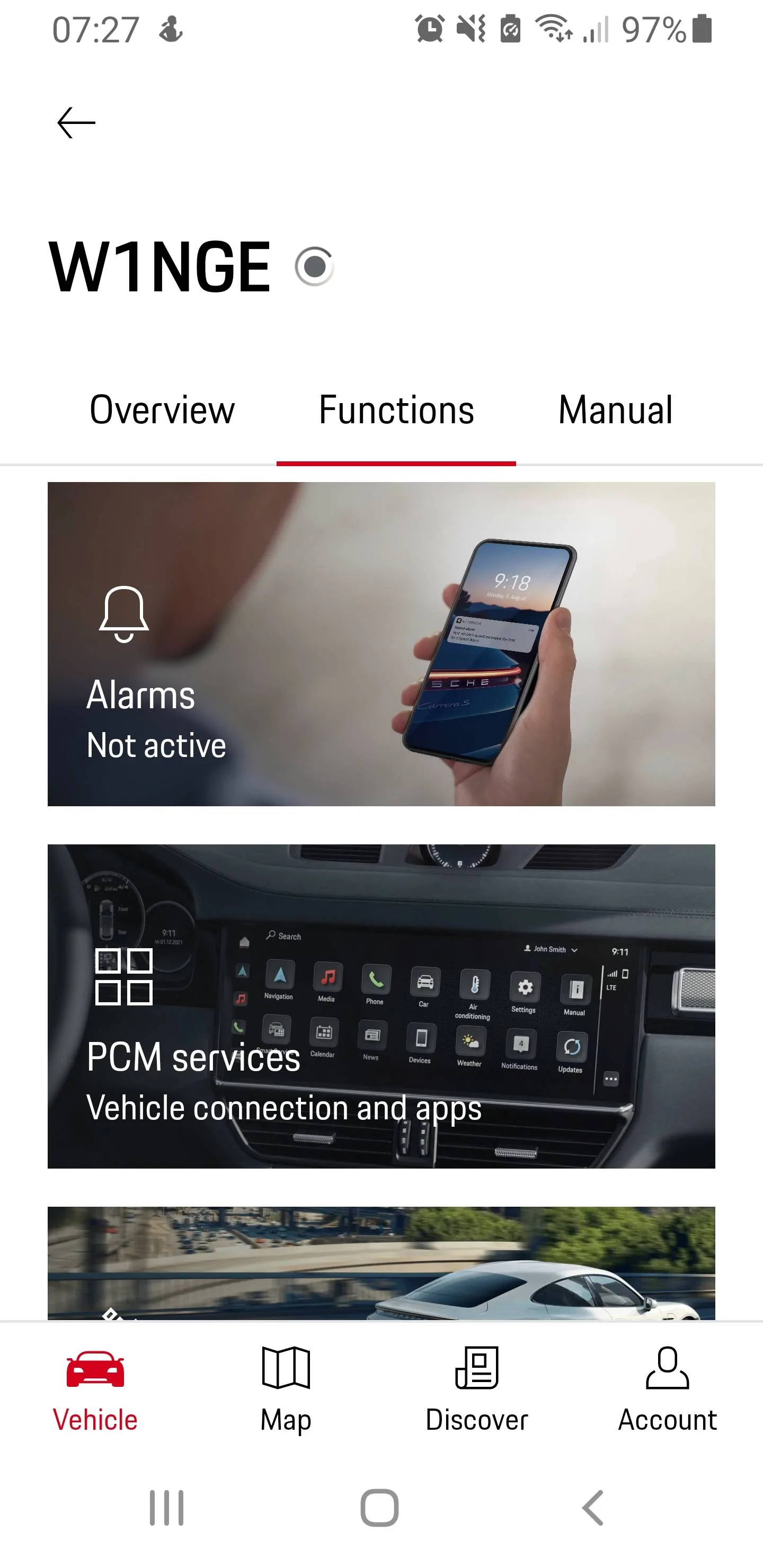

Thanks. I think it is active. I can track it on my Porsche app and if someone entering the car, a notice would be sent from it.
Porsche Vehicle Tracking System (PVTS).
Fobs come with the car BUT require an annual subscription to activate.
If you have an active subscription then DO NOT leave in the car as this will deactivate the tracking service.
Always carry one with you when driving the car..
Service managed by Vodafone (not Porsche).
Tracking features in My Porsche App. Under Alarms and Vehicle Tracking System.
Furthe details in the owner's manual.
