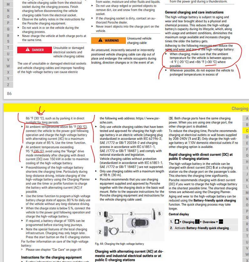

Hello!
The Porsche Center here will send their electricians to install the Wall Charger Connect in a couple of days. I do not have an enclosed garage to put it in, but I have an outdoor open-air shaded garage with large canopies. Temperatures here are nice in the winter (5C to 15C) and can reach 45-55C in the summer (June to late August). Will that cause any issues on the wall charger?

Manual cautions against charging at temps more than 30 C. You may want to get information from dealer and other Taycan owners in your area.
