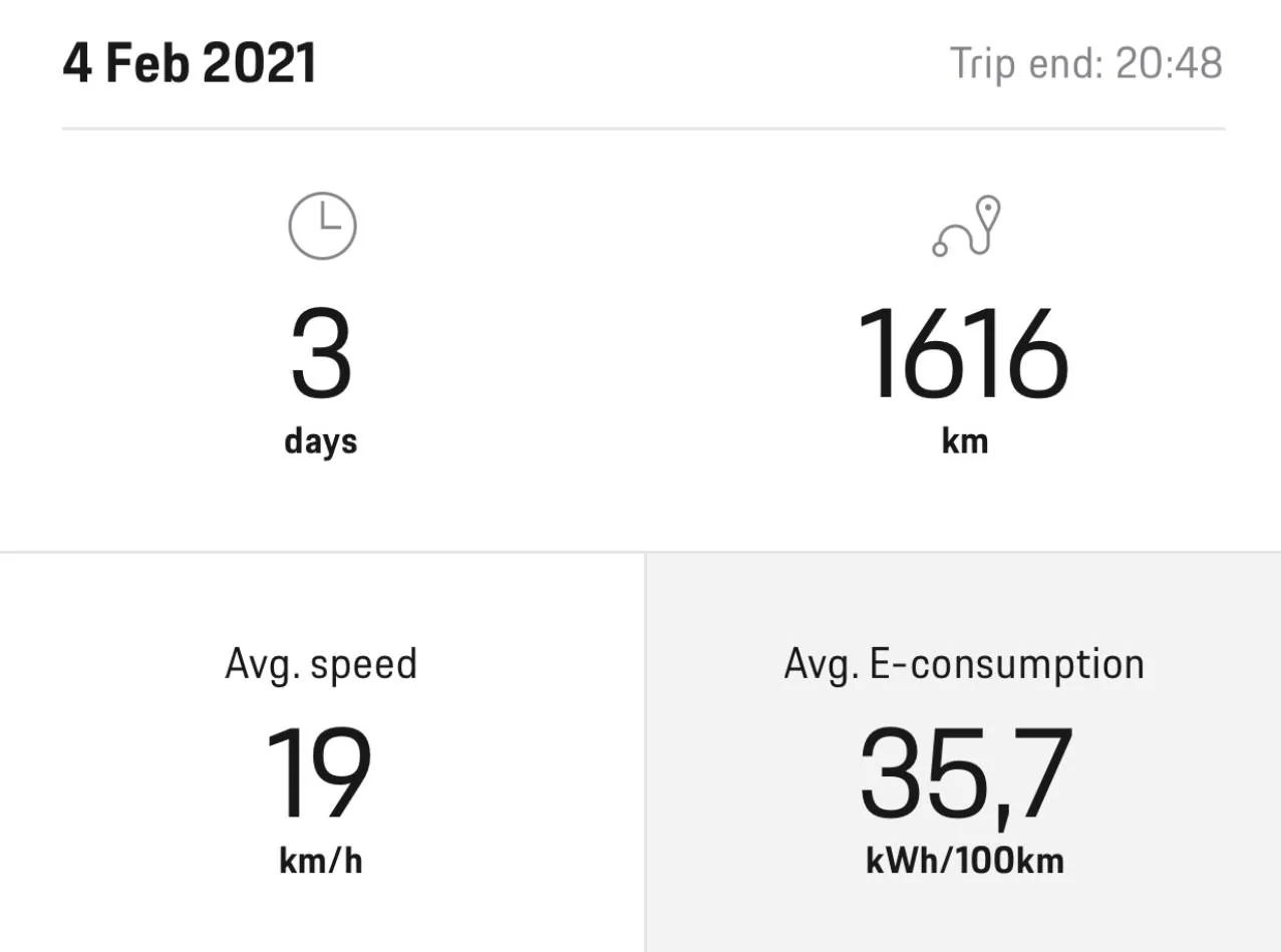

Jancha
Janis
Oct 1, 2020
183
204
Latvia
911 Cabrio (ex Taycan 4s+)
Porsche Taycan What's your real world range with Non-Plus Battery throughout the year? E304C411-7B38-4CDB-B9E8-3EC91BA4603D
This is for 4s, performance battery plus in winter+city+car on street overnight.
at 83.7, that would be about 230km or 150miles of range (this also includes the break-in period, maybe the range will improve).
