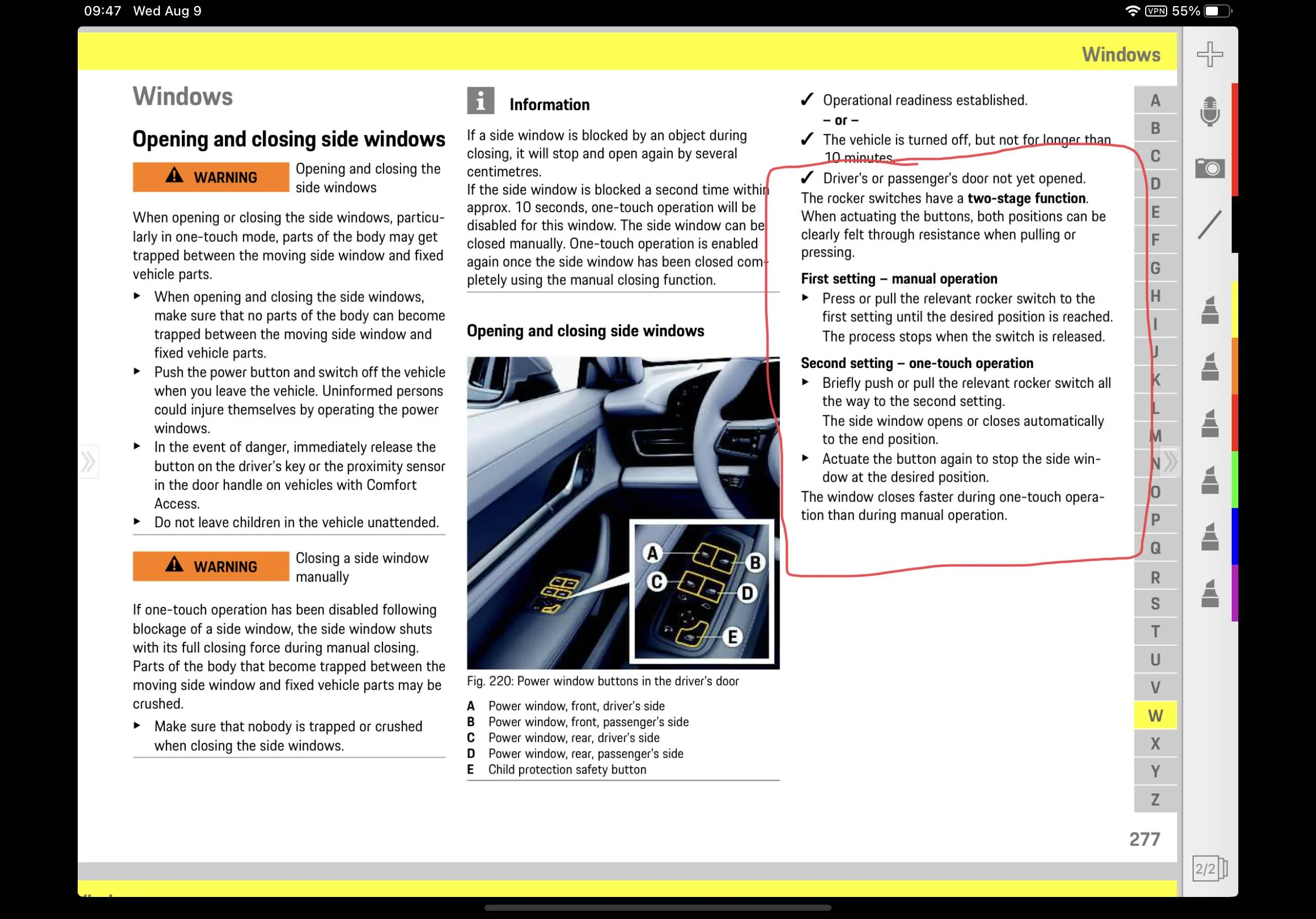

This may provide some guidance. Page 277 USA manual 2020 MY.
Hope this helps.
