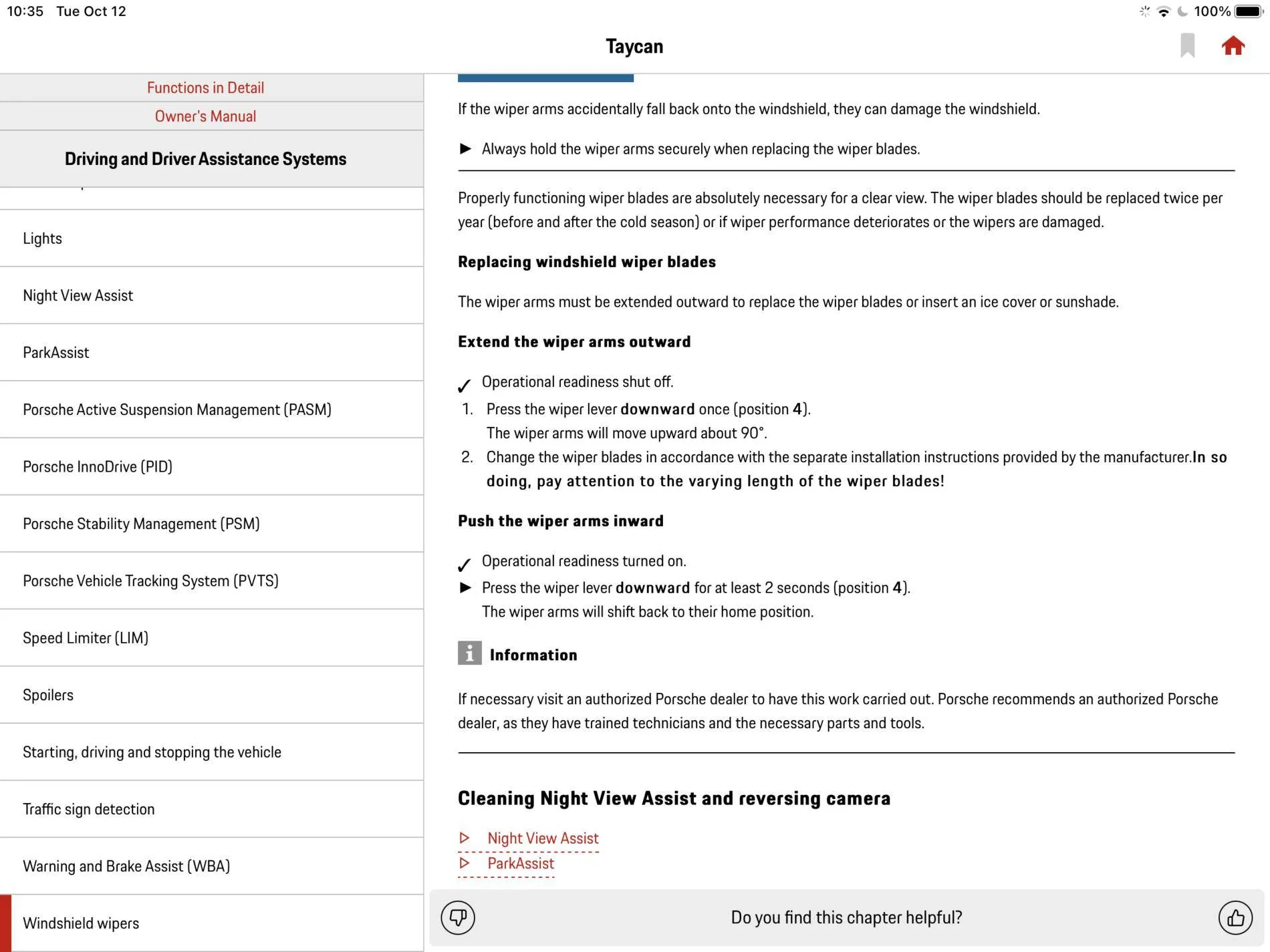

I do not see anything specific to your issue in good to know or manual. Maybe try the procedure for a wiper blade replacement.
Let us know if it works.
