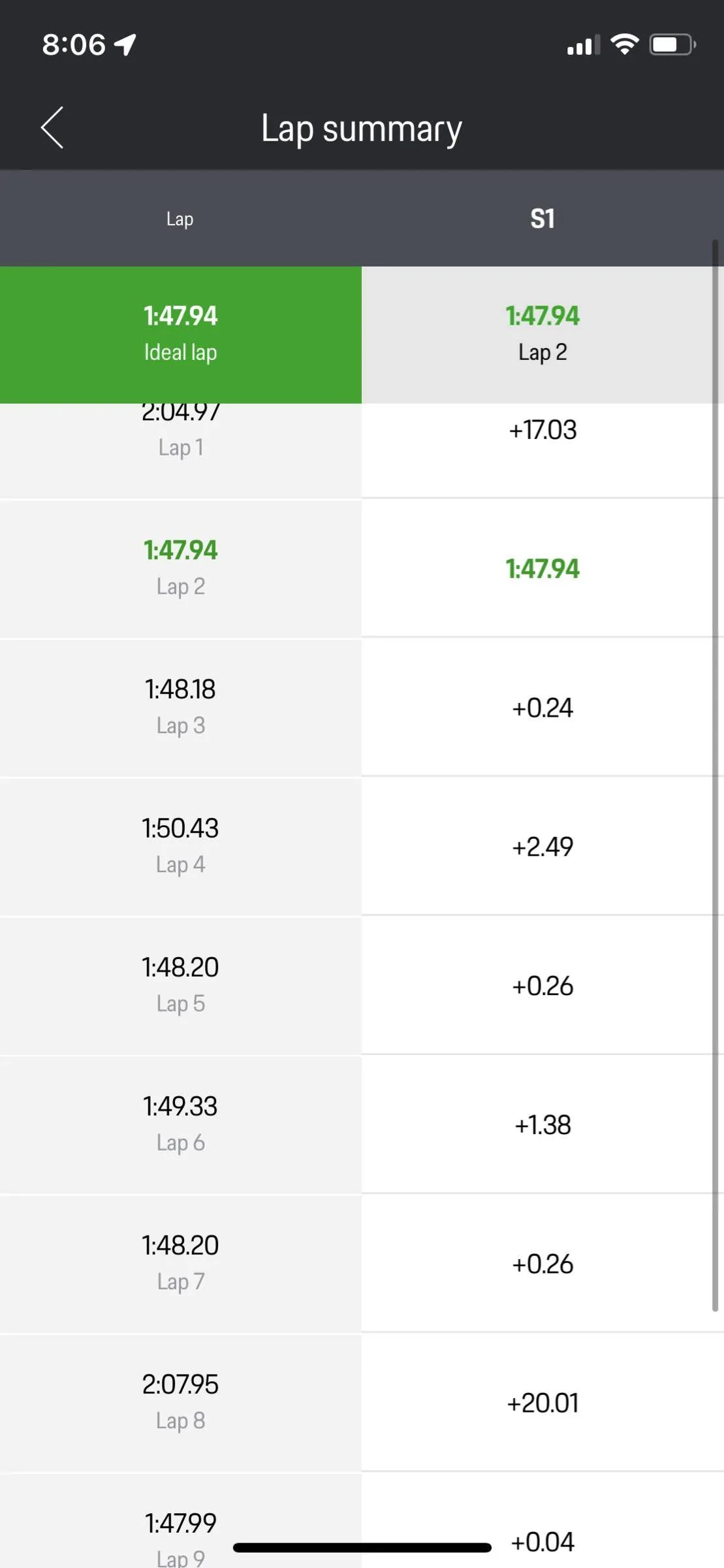

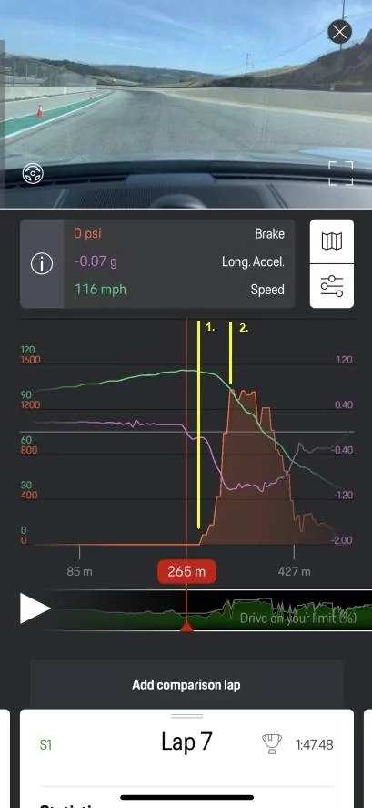

Check out the video from the Track Precision app. Cool little wheel spin and under/over-steer icons too:

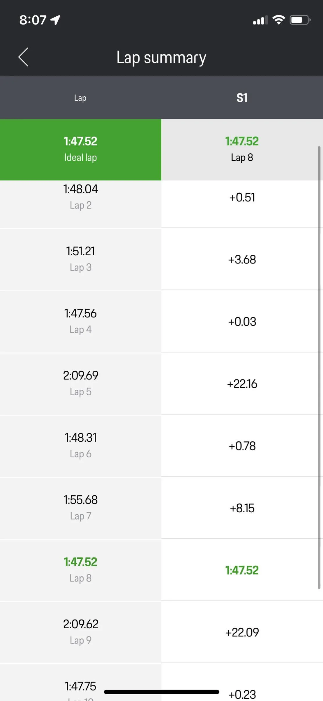

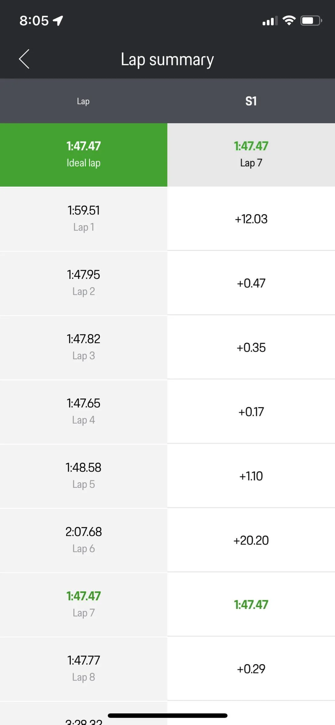

First session recorded laps on sport chrono but haven’t downloaded yet. 9 laps
SOC 92-55%

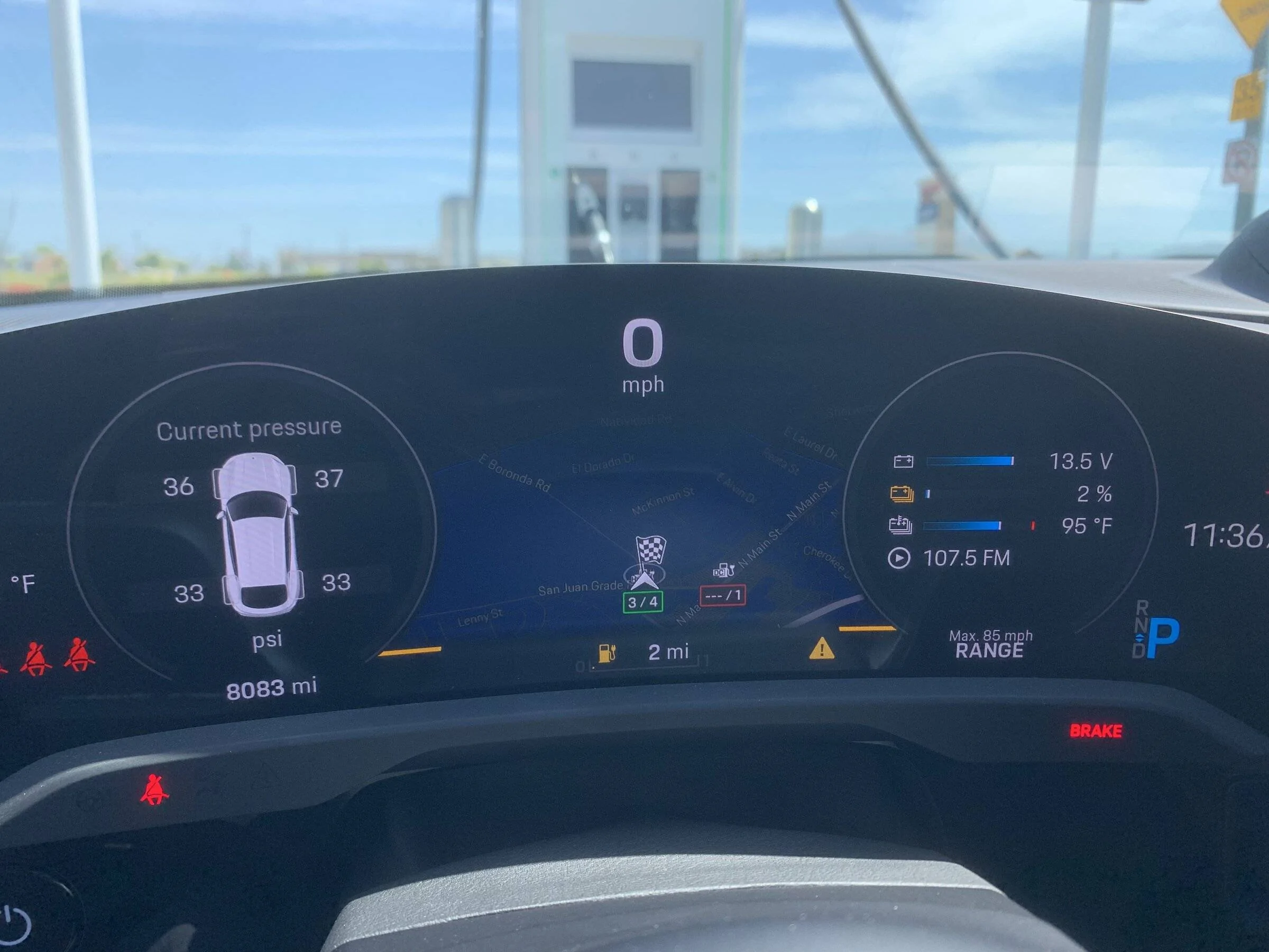

Skipped third session to charge. Made it to Salinas with 2% left. When I left the track, the dash said I had 8 miles of range to make the 16mi trip.

This was the most consistent with the fastest lap coming after a cool down lap.
9 laps
SOC 54-11%

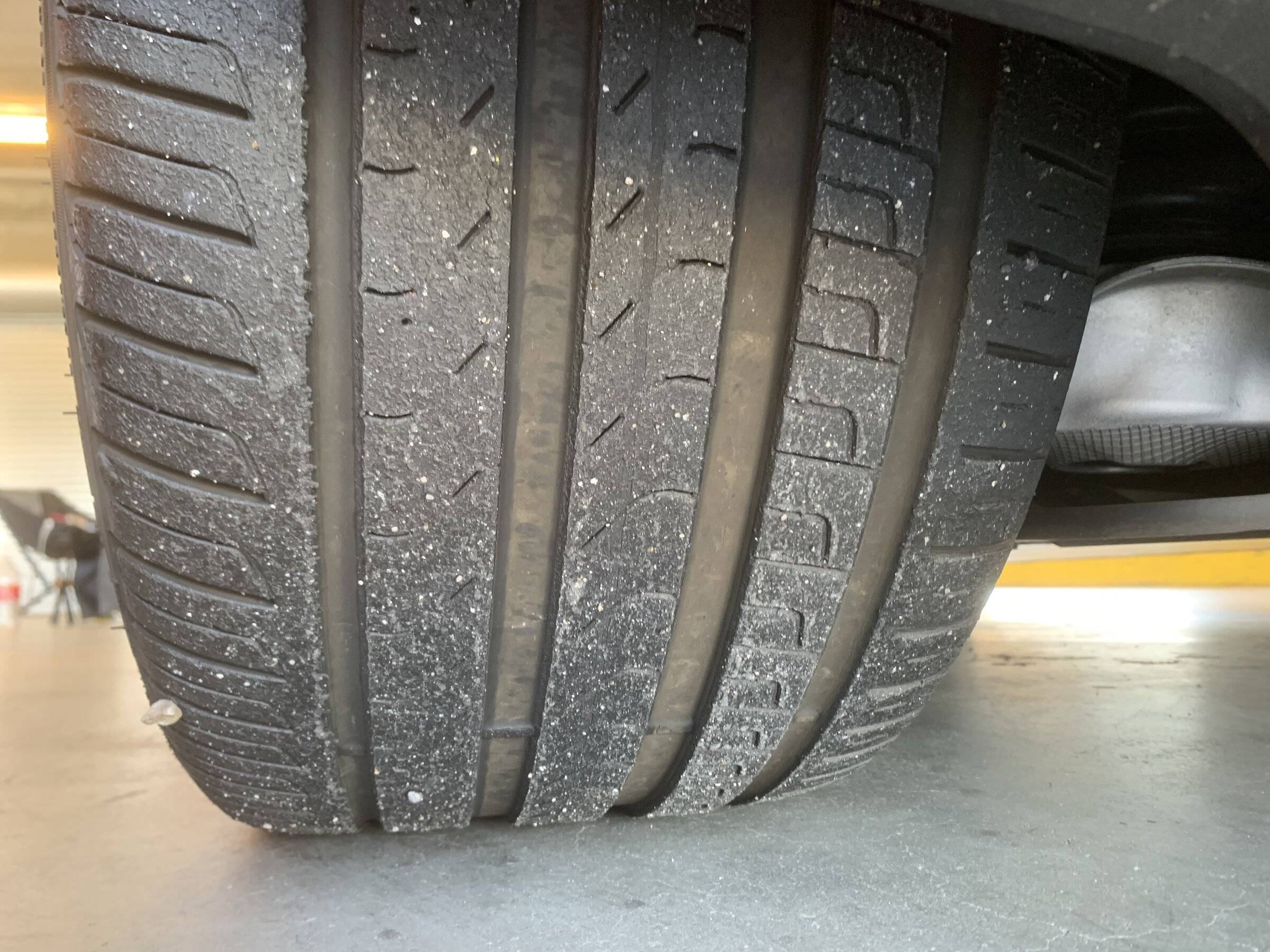

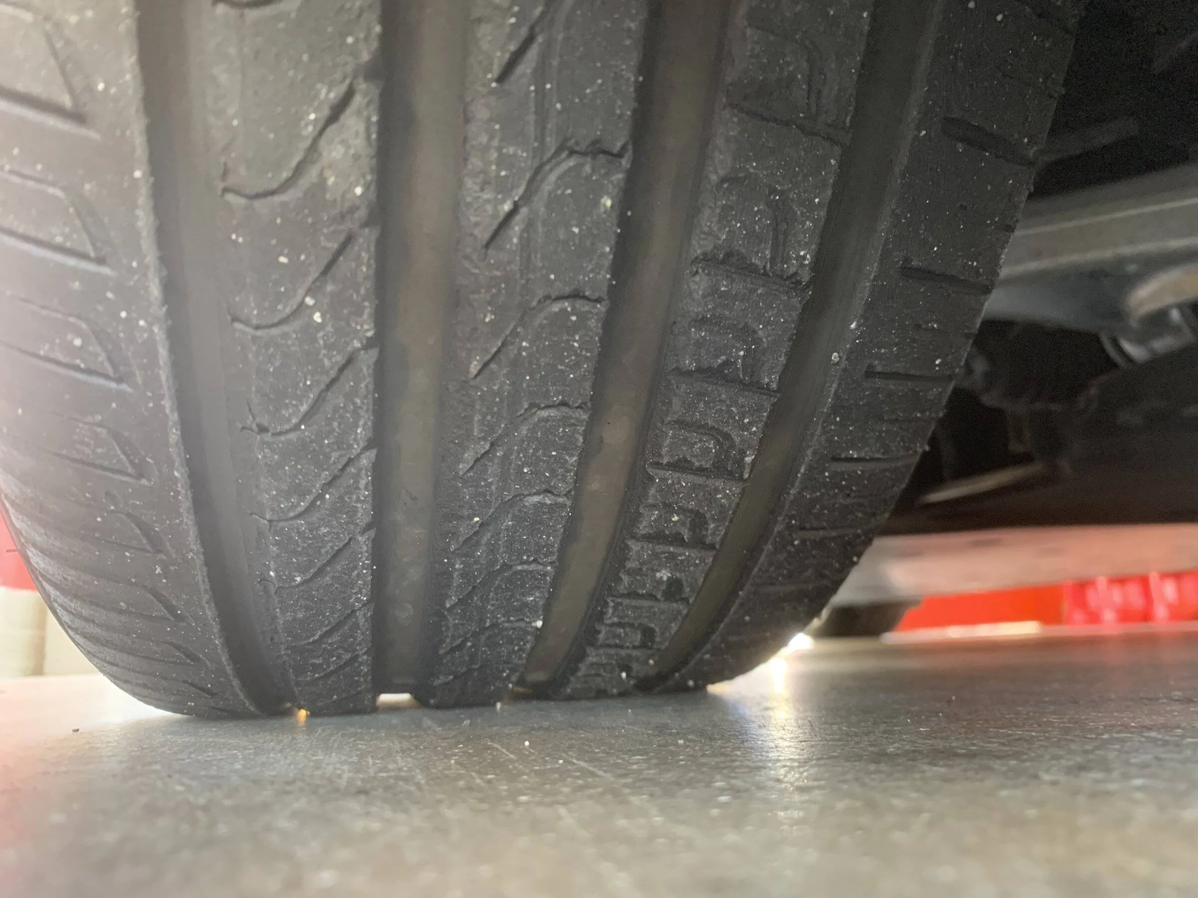

Tire pressures ran 41/38 (front/rear) hot. Temps were hot in the middle but I think that was safer than cooking the edges of the tires. Could have run a psi and a half lower perhaps. I had really low expectations of the 20” Pirelli P7 blues but they actually held up pretty well and did not degrade significantly even though the grip was annoyingly low. The front tire mid and second to inside rib was looking a wee rough though.
Porsche Taycan Is a base Taycan any fun at the track? -> Video, pics, data from Laguna Seca 2181A2B6-1E09-4C51-B63B-5012947F3134
Rears were fine.
Porsche Taycan Is a base Taycan any fun at the track? -> Video, pics, data from Laguna Seca C661EE76-8BD7-4D57-A7A5-CC3F89DBFCA6

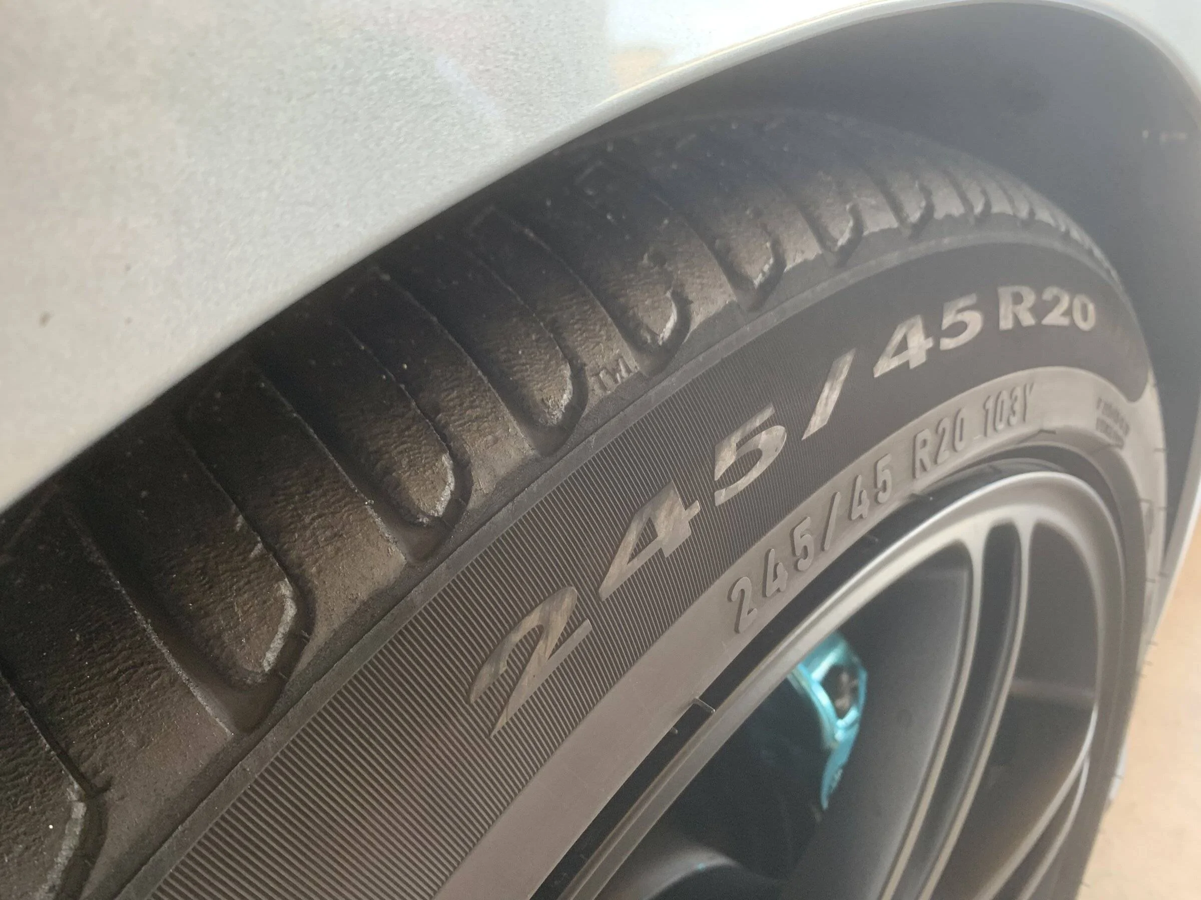

Edge wear was also ok. The XL load rating probably gives the sidewalls some extra support but they still felt vague and not responsive.
Porsche Taycan Is a base Taycan any fun at the track? -> Video, pics, data from Laguna Seca D4BFAC46-2D08-47B4-924D-4E08F5C04769

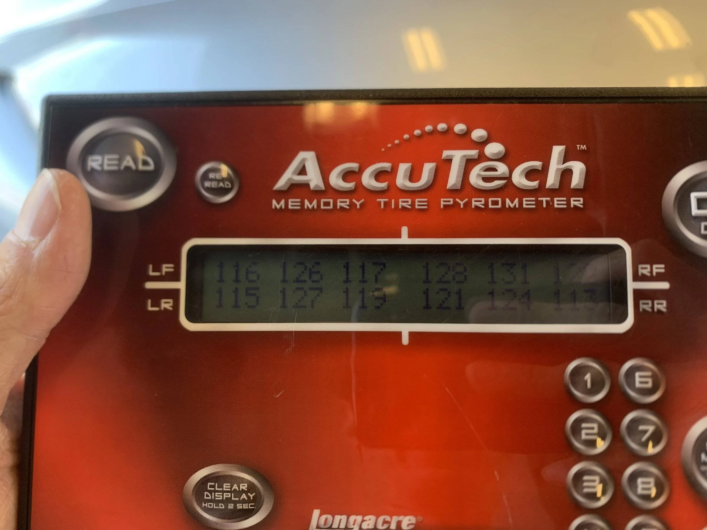

Temps taken after cooldown but still kinda representative of distribution since the reading is taken with a probe at the carcass, not surface temp.
Porsche Taycan Is a base Taycan any fun at the track? -> Video, pics, data from Laguna Seca C4301533-8C74-4639-8ED8-BFB71330820D

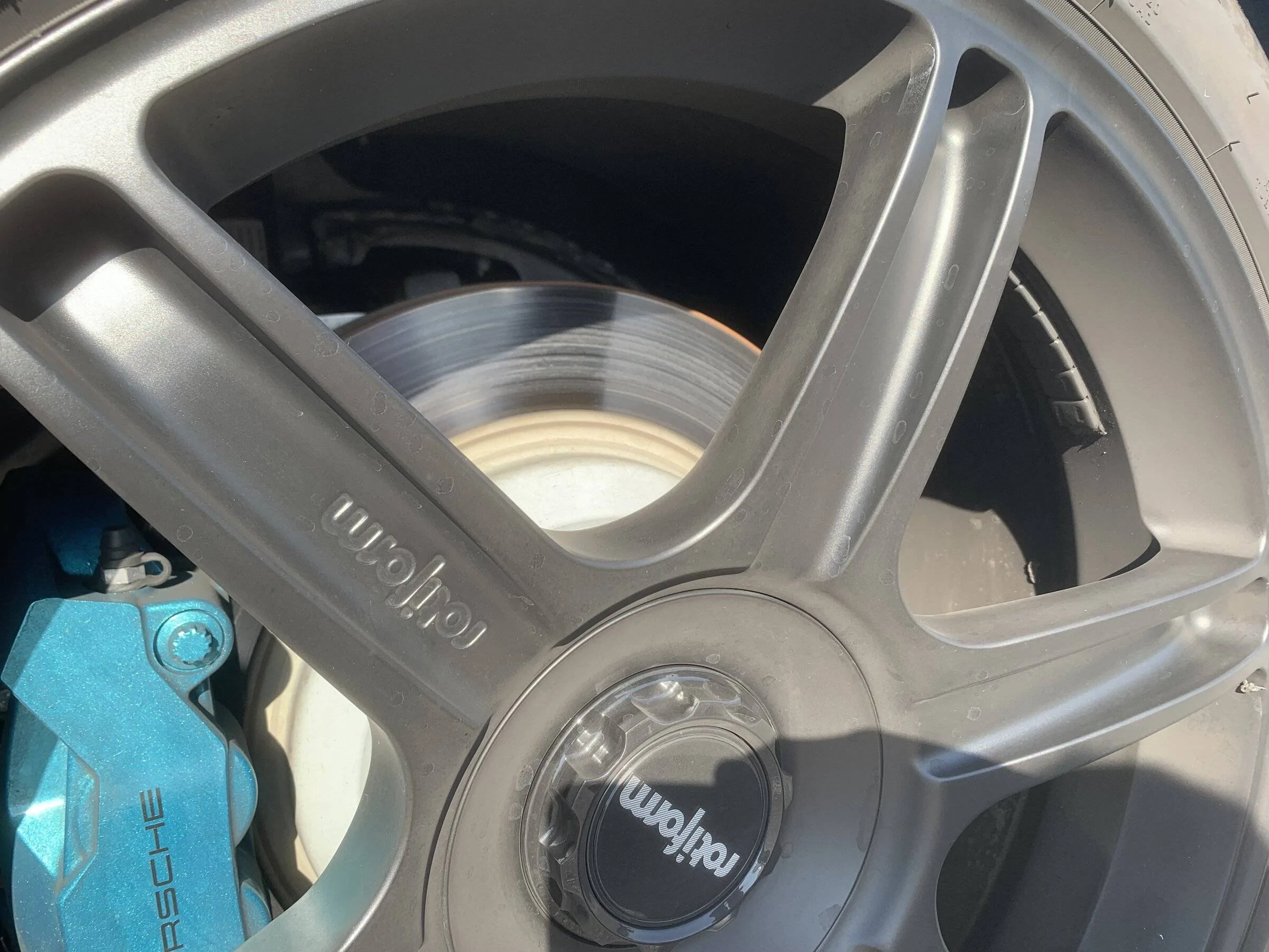

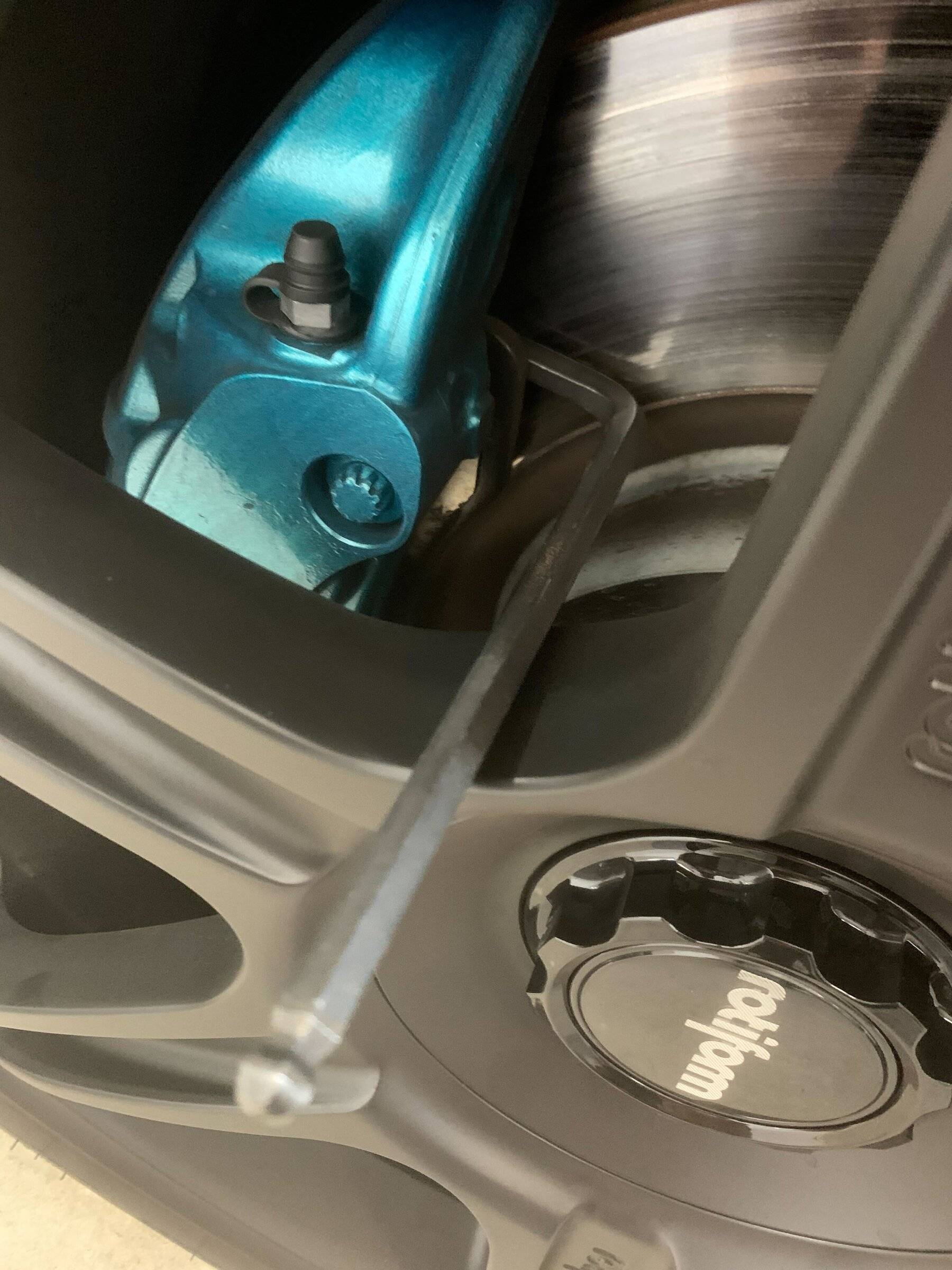

Added some notes on brake performance and wear in below post. Summary, 2mm wear in front, and 4mm wear in the rear. Overheated pads and had some bad scoring on the rotors, esp. the rears.

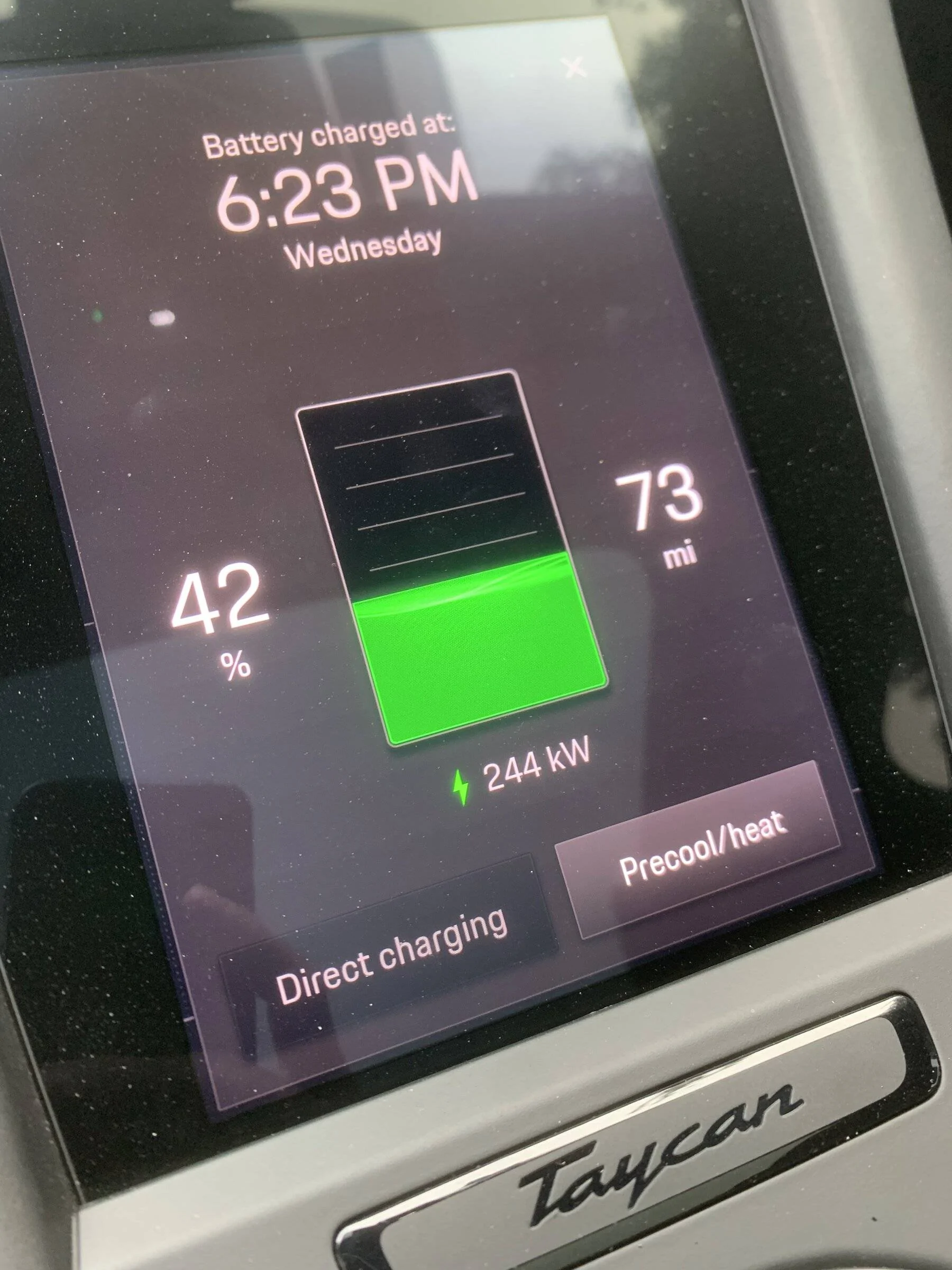

So, first time using my mobile charger connect. The garage plugs are NEMA 6-30 so you'll need an adapter. And don't forget to set your charger at 50% otherwise you'll be flipping breakers... For some reason I thought the charger would auto adjust power, but I guess not. Maybe the adapter fooled it.

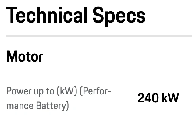

just did some investigation on the Spec's porsche site - it's all in the "max" power
Taycan RWS
Porsche Taycan Is a base Taycan any fun at the track? -> Video, pics, data from Laguna Seca Screen Shot 2022-05-26 at 2.14.23 PM
vs. Taycan Turbo
Porsche Taycan Is a base Taycan any fun at the track? -> Video, pics, data from Laguna Seca Screen Shot 2022-05-26 at 2.15.02 PM
460 - 240 kW = 220 kW "less" power being demanded of the same battery and cooling system…or a 47% reduction in power demands - this is a virtuous cycle - less power = less heat build up in the battery - and less consumption…
but the battery temp still rose (118F battery temp after a cool down lap still means battery temp rose during the session meaning the cooling system couldn't keep up)
but a 220 kW "savings" is going to elongate the time on track until enough heat has been dumped into the battery…
consumption was also down - so in terms of kWh's discharged - 240 kW nominal max (not in overboost launch control mode) means less consumption…
all around RWD is a better car on track from a heat/consumption point of view - and frankly not that much slower because of instant EV power/torque

Another interesting data point is brake wear and performance. I was not completely confident with the brakes. For one, the pedal would go long after 3 laps. I was not exactly sure if it was the boiling of fluid, or if the regen/mechanical feedback of the pedal was doing funny things. Either way, I learned after the first session to take it a bit easy in braking zones and the performance was more stable. But still not confidence inspiring as lap after lap in heavy braking, the pedal force and travel varied a small amount.
Took a look at the braking data going into T2, and there are some interesting points:
  1. You can see the regen working as soon as you lift off throttle. About 20m from throttle lift to when brakes start building pressure. I think some of the uneasiness I was feeling is the fact that as you start applying mechanical brake pressure, you don't immediately increase decel. The purple line is longitudinal g's and it actually starts easing off a bit (upward slope) just as I get on the pedal. This only happened in the two heaviest braking zones entering T2 and T11.
  2. Another 50m of distance covered before reaching peak brake pressure and max decel. That is quite long, and it was a conscious effort of mine to avoid shocking the tires by not inducing alot of slip so early. With better brakes and tires it would be nice to just stand on those brakes as fast and hard as possible.
Porsche Taycan Is a base Taycan any fun at the track? -> Video, pics, data from Laguna Seca T2 brake trac
If anyone can confirm new brake pad thickness it would be good to know. I didn't measure pad thickness before but I have a service report from the dealership saying they were at 10mm thick at all corners.
Following this event, I measured 8mm front and 6mm in the rear. Allen keys come in handy for measuring! That's alot of wear on the rear. At that rate, 2 track days would be enough to go through a set. It would not surprise me if that were true. I was going well beyond the ideal temps for the stock brake pads and they began to score up my rotors pretty badly.
Porsche Taycan Is a base Taycan any fun at the track? -> Video, pics, data from Laguna Seca Image from iOS (83)
Rear rotors were in rough shape, literally. Tons of brake dust too. And Porsche said the pads might last forever... (under normal use)
