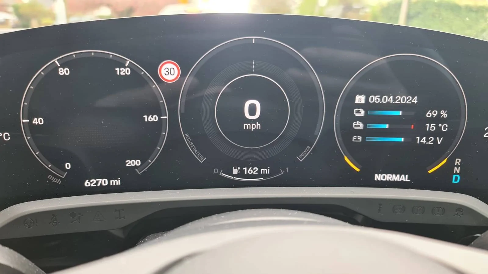

Mine died too after 9 days unused over Christmas, I had to do the manual procedure to get to the battery and jump start the car.
I has come up very occasionally when I get in the car with a warning that an accessory is drawing too much power, the only thing I had plugged in was a USB stick of music now removed.
Anyway I did a 470 mile round trip last week and thought that would give plenty of time to fully charge the 12V battery but the display showed 14 to 14.2 volts for the whole drive so if a fully charged battery shows around 13.4V mine wasn't charged even after 10 hours driving.
any update on this?

I had the 12v get low on me once. It was after the car had sat for several days and the garage was likely colder than usual as it was during a cold spell. It said please connect to charging equipment, etc. If you left the car sitting it would turn itself off.
I've since purchased a trickle charger and I haven't seen the message again. The car still seems to run at 14-14.2 though.
