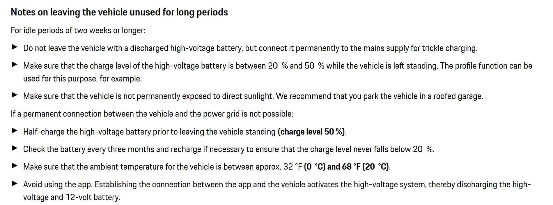

What’s SoC ? Key is a long way from car and all properly locked.
I follow this recommendation from the manual when I leave even for a week, just a good practice.
SoC = State of Charge or the manual below calls it "charge level".
Thanks - My vehicle was left 12 days ago with 47% charge and had travelled 90 miles before parking so I assume 12v battery was fully charged.
