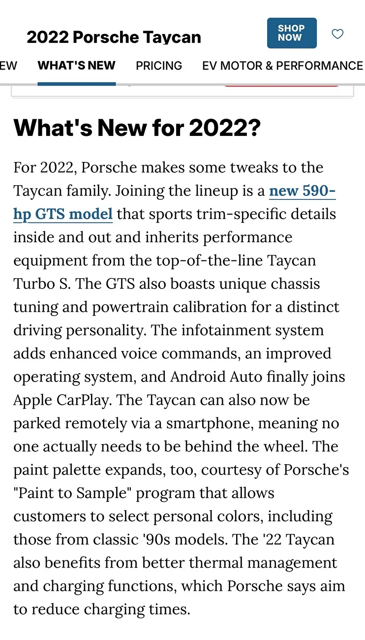

I always go to Car and Driver to see yearly changes. Here’s what they say changed from 2021 to 2022.
Porsche Taycan 2021 vs 2022 Taycan 4S — actually any real differences? IMG_9883
