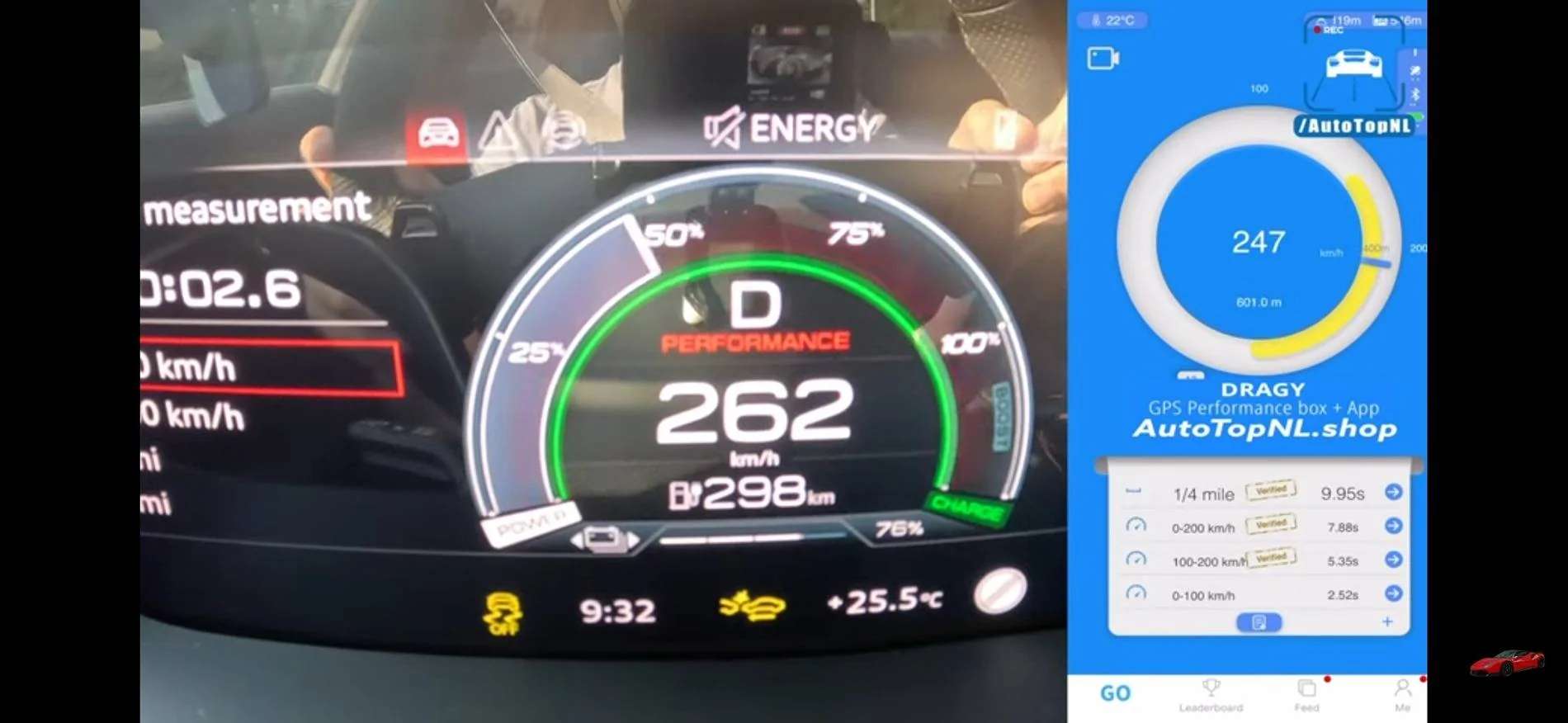

Is it me or does he really crank on the wheel at the start… :)
