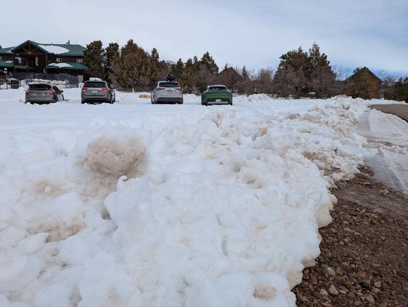

Figured out a 110volt “Top off Technique”. One resort had a free Level 2 charger near the main lodge, but our house was a 5 min drive away. I would leave the car plugged in near the main lodge, then drive to the house and plug it in (usually overnight) at a simple 110 outlet. This allowed me to “top off”. One overnight I went from 73% to 85% (roughly 10 hours.)

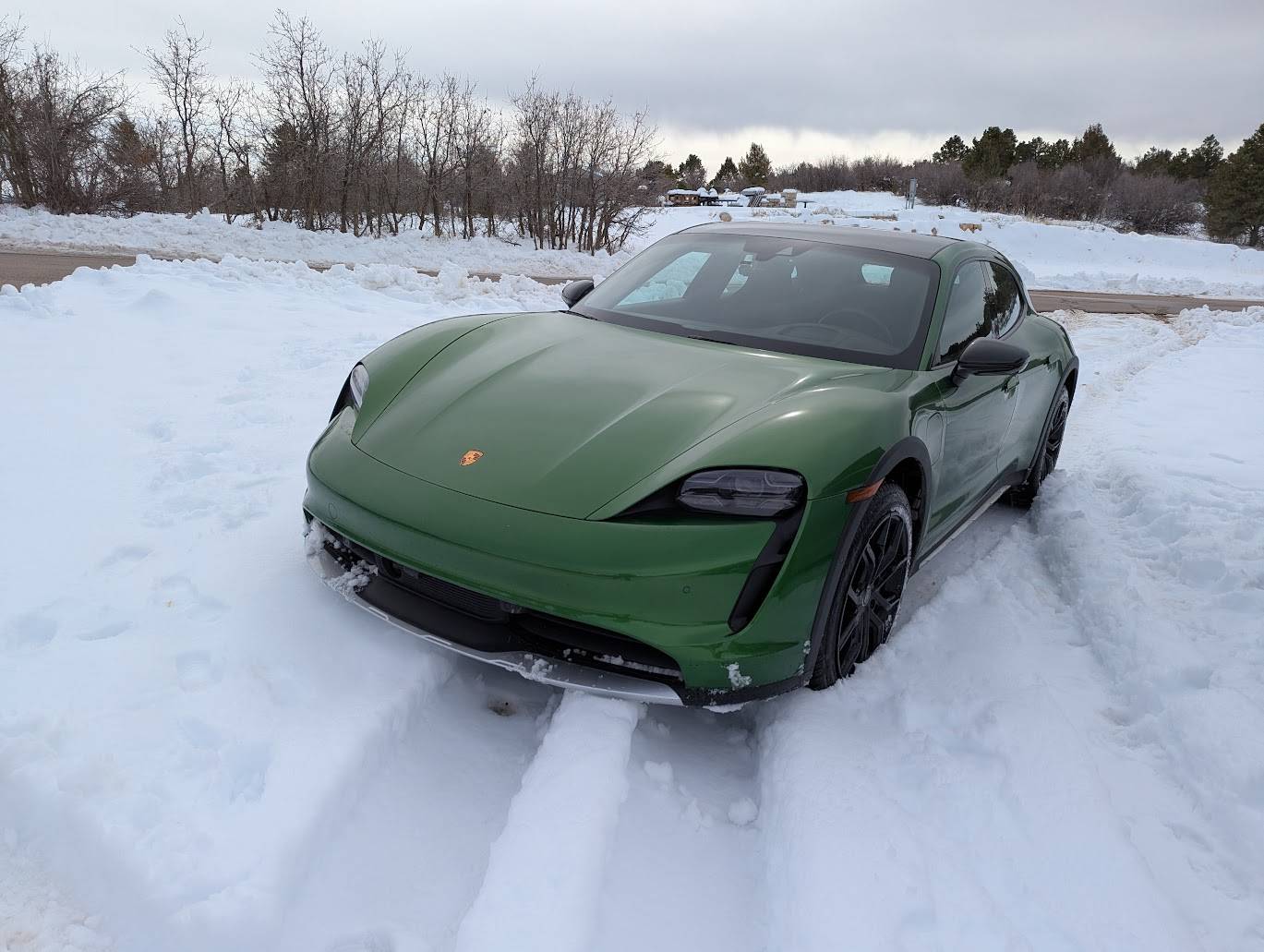

Blizzard conditions – Magdalena performed admirably in a serious white out blizzard at night over Vail Mountain pass (10,000 ft.) Brand spanking new 20” Blizzak snow tires, Gravel mode. Only issue was front windshield froze quickly and while it defrosted just as fast, the wipers iced over. Pulled over and toweled off the ice and was fine.
Also tested stopping power at 50mph. Slid a bit, as expected in ice, but then regained control easily.
Deep hard snow – drove through it like butter! The Tesla beside me got stuck in less snow. We were both going to chargers, which, of course, were not dug out.

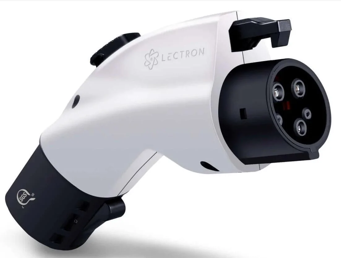

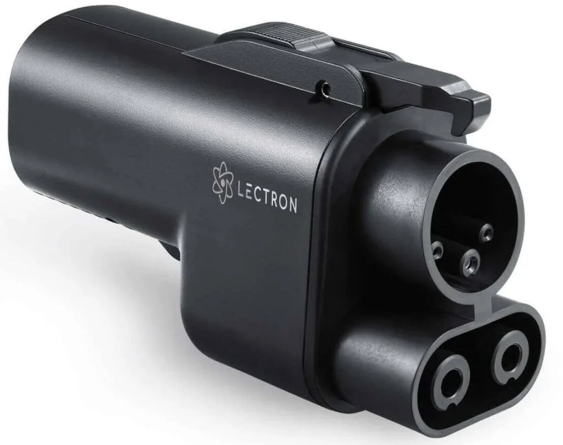

First, let me say that you are very courageous! I don’t know a lot of people who would attempt both of the drives you took in a Taycan right off the bat. It sounds like you’re having a great time ?
This is the Lectron adapter I bought in anticipation of access to the Tesla SuC Network.
Porsche Taycan Just finished a 1,500 mi CO & UT U.S. West trip 1740358250226-
I have a Tesla Tap connector for L2 charging (220V at Tesla destination chargers. Hotels, etc.) but this one from Lectron looks good. It’s smaller.
Porsche Taycan Just finished a 1,500 mi CO & UT U.S. West trip 1740358453901-pv
