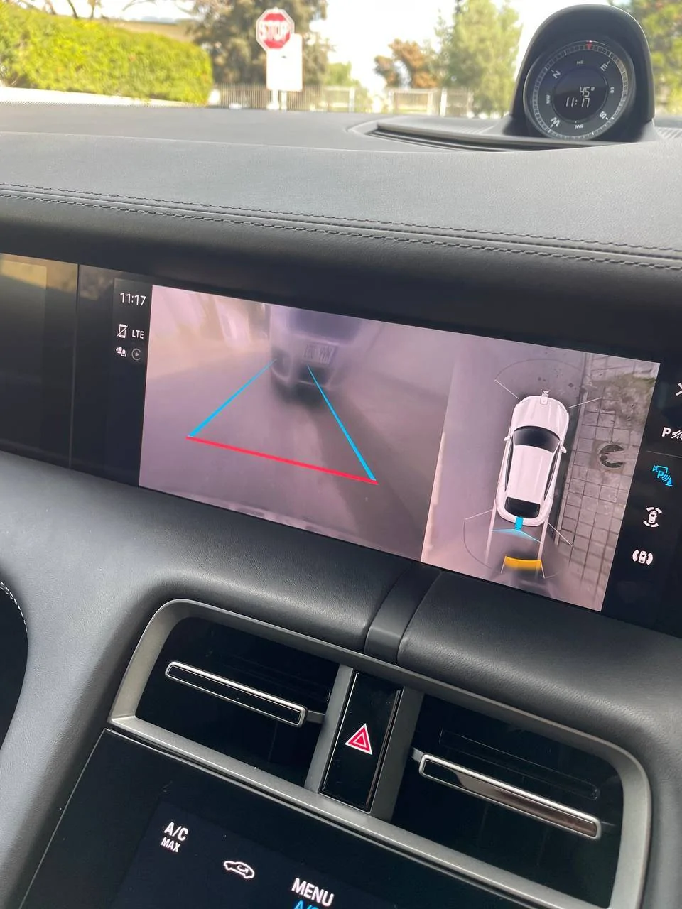

Hello guys. I have packed my car with full park assistance Surround View. But still can't have the same functionality as on video
I simply can't drag the touch screen to rotate the car like this.
Is it old software or what?
This is what I have:
It looks like you don't have the Remote Park Assist option which now includes the 3D option with the virtual cameras (it used to be a separate option for MY21).
Looks like you have the Panoramic / 360 Surround option only.
What does your build sheet list as the option(s)?
You should be able to use the 'hack' to get the 3D render but you have to guess where the cameras are etc and is a faff to use. Search the forum for instructions.
