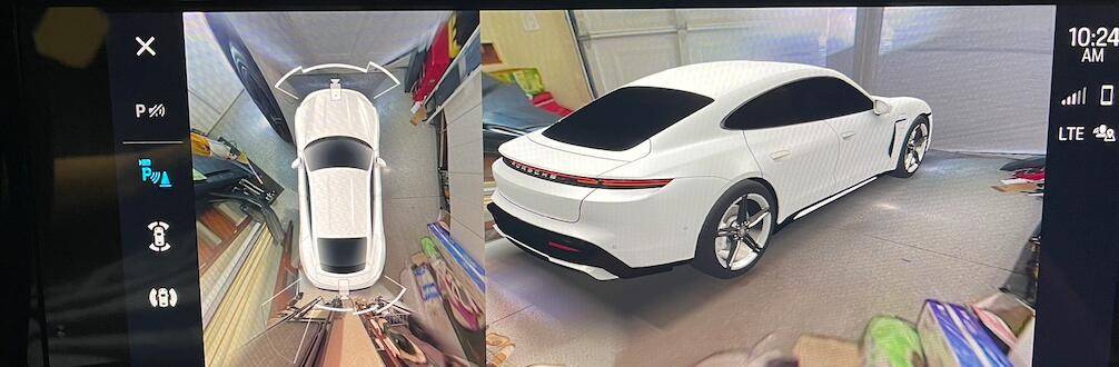

Hello,
I have MY21 TTS with Premium Package (including Surrond View). For cameras, this was the only option I saw un US configurator.
When I turn on the parking camera, I see icon for only 2 camera (see image below)

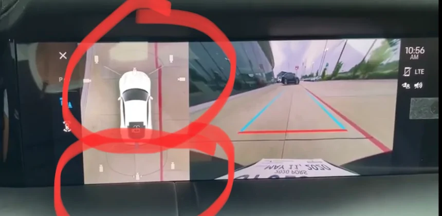

but on some videos online I've seen upto 8 camera icons (see below)
Porsche Taycan Surround View Camera (US Version Taycan) 1614105358427

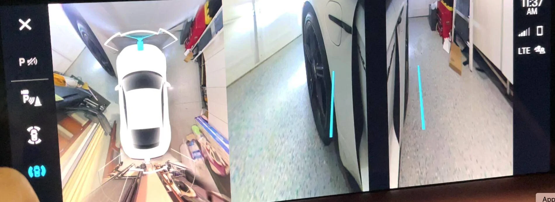

I was able to do the "cheat" as described in one of the other threads and get the 3d view but not with camera icons (see below)
Porsche Taycan Surround View Camera (US Version Taycan) 1614104943131

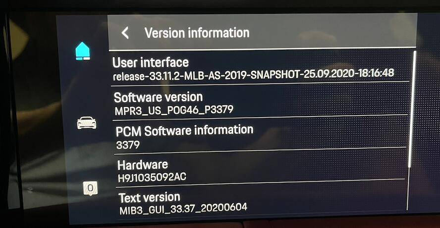

My s/w version info(see below)
Porsche Taycan Surround View Camera (US Version Taycan) 1614105121631

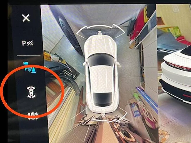

In the left part of the camera window, there is a column of icons. The Parking proximity icon is blue and the rest are white in your picture. Try and tap on the white icon immediately below the blue icon.

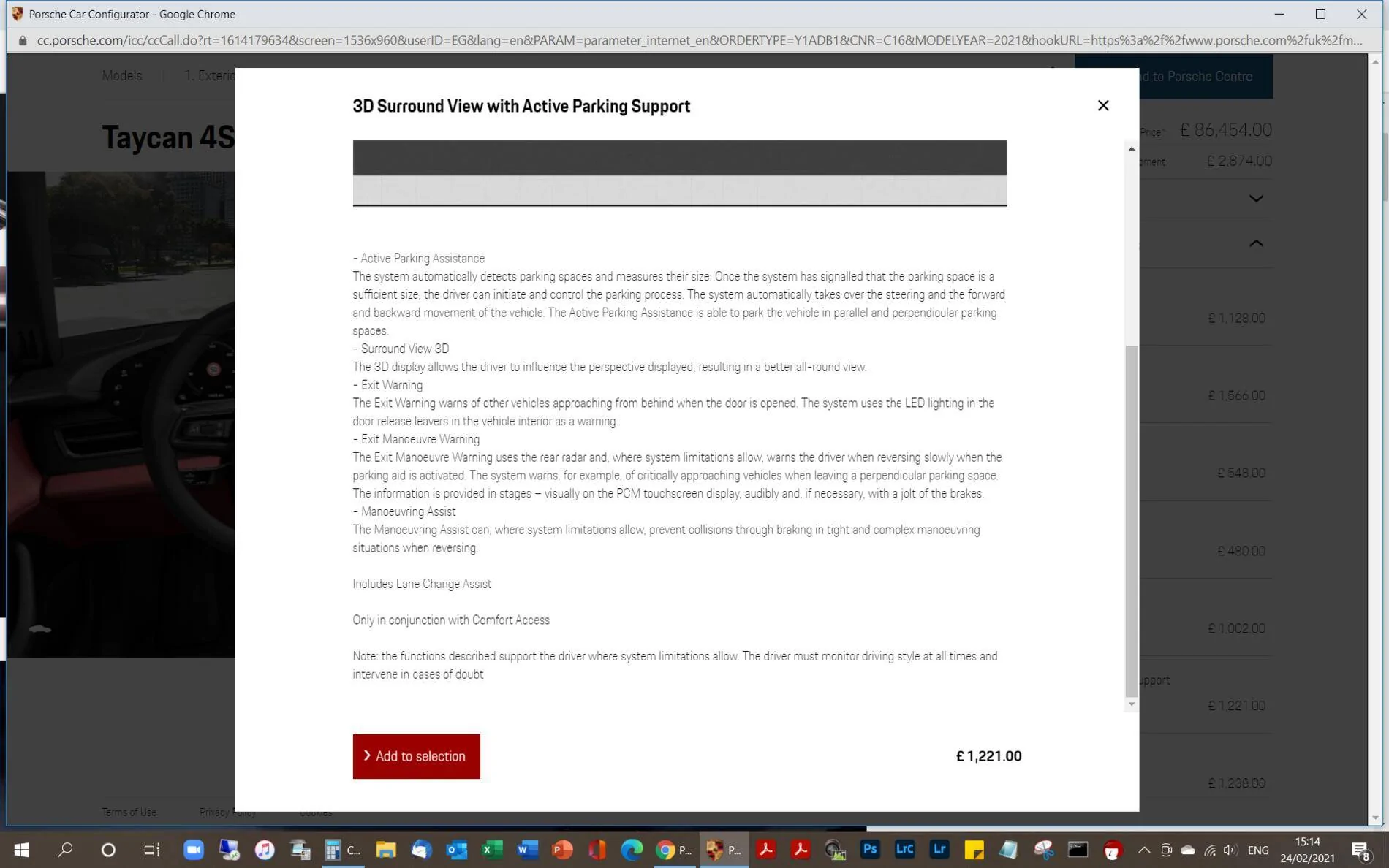

No worries. I've attached the description of what we have in UK / Europe for 3D Surround View with Active Parking Support for reference.
The current trick with the front or rear camera to get the 3D view works just fine however. I'd not tried it until today and can see a use for it (kerbside parking for one).
Porsche Taycan Surround View Camera (US Version Taycan) 3D Surround View with Active Parking Support

Thanks. Its different than what we have in US configuration (see below).
Porsche Taycan Surround View Camera (US Version Taycan) 1614189188680

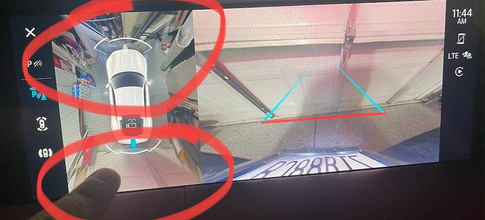

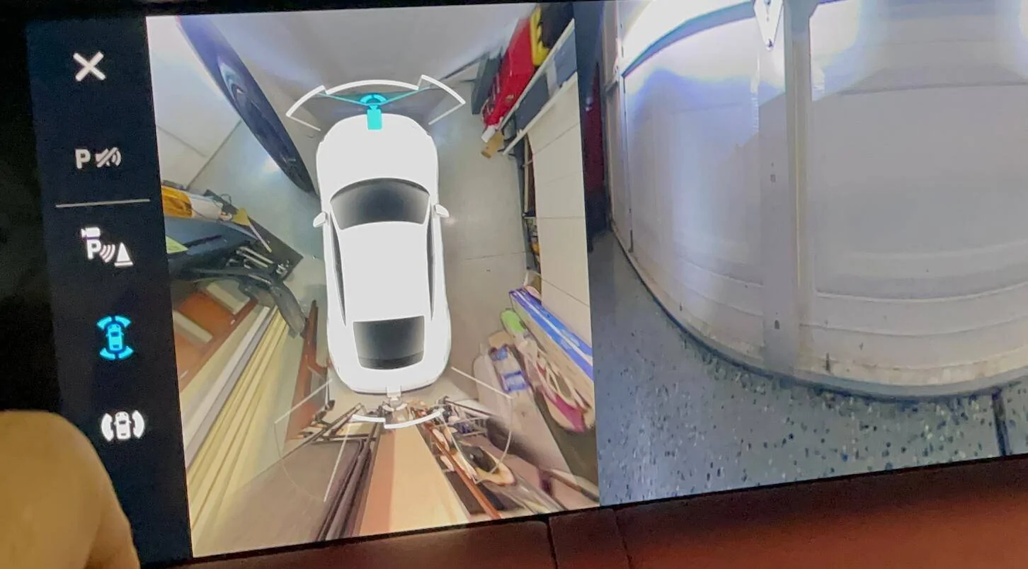

It is quite easy when you know how.
Select the rear view camera on the main image of the birdseye view of the car once your park assist is active.
Then using the main panel touch pad (below the AC controls) scroll down once (camera should change colour) and then press. If the sequence and selection is right then the 3D view will magically appear.
Then use the PCM screen to spin the car around to get a full 360. The wheels turn and rotate depending on what the car is doing.
I think you can do the same with the front camera and so there are 2 options to initiate.
Earlier in this thread there are some videos.
