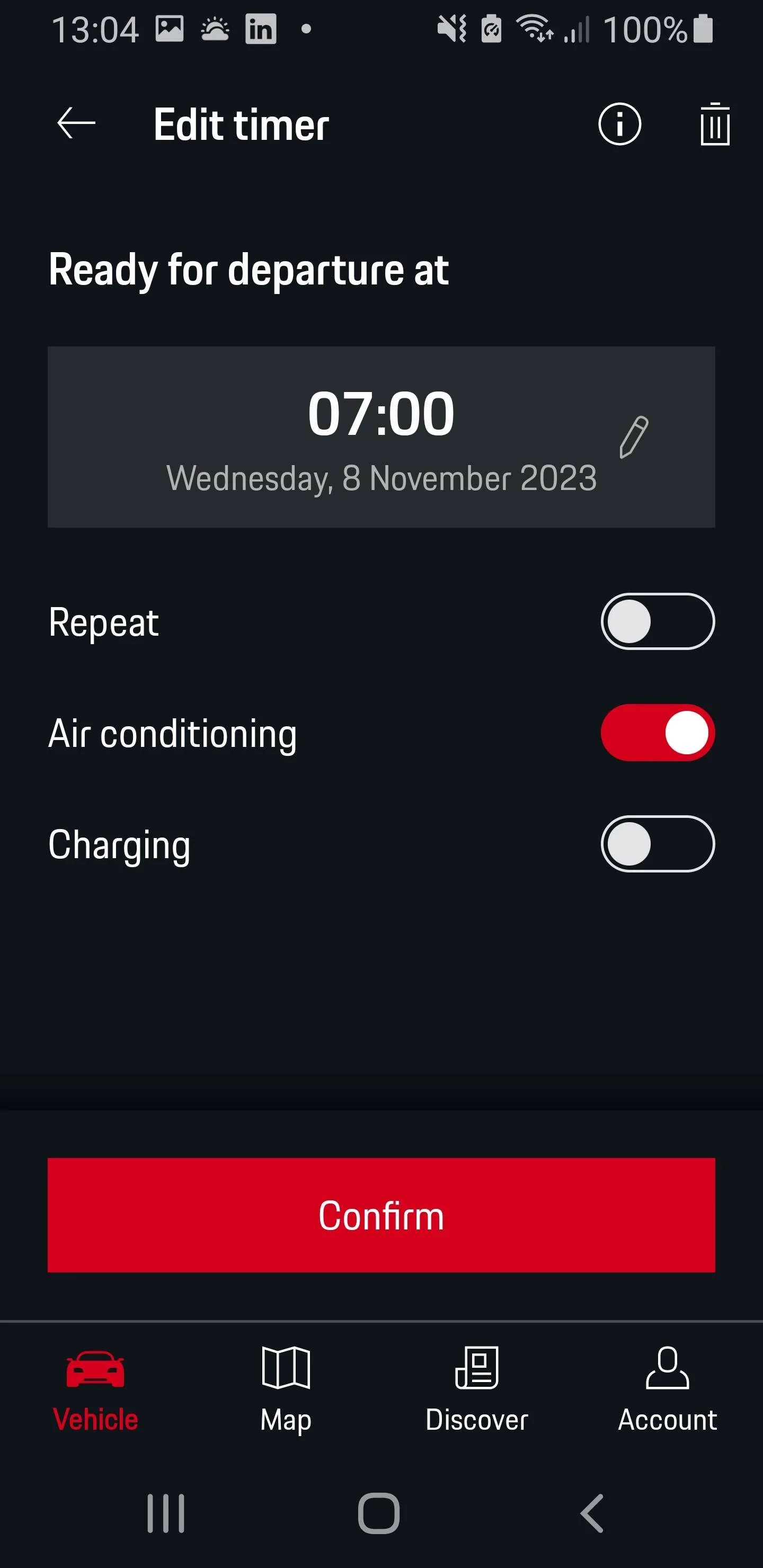

You can create a timer (departure timer) which only has the air conditioning / heating set and is independent of any other timers.
Yeah, this is what I have been using (with charging deselected). When I used it with a correct departure time set it used 5% of my battery to warm the car, which seemed excessive.
