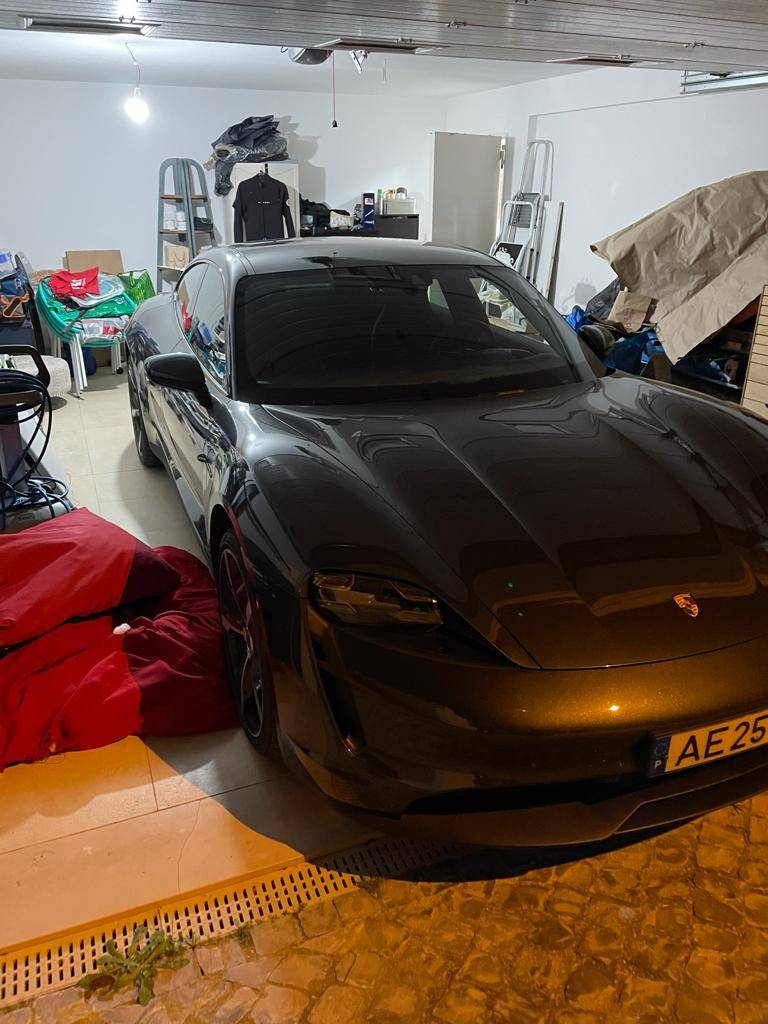

That’s it...in my driveway I need to lift the nose ...more than all the entire car...I’ve seen in some article’s that has nose lift but i can’t be sure and the dealer doesn’t know

This is the problem....I’m sure I need something to elevate the front axe
