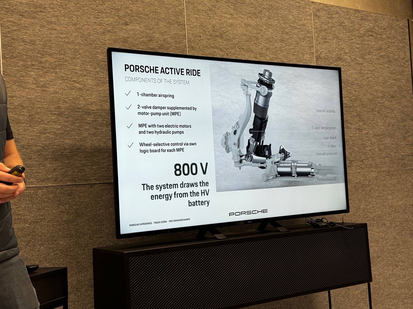

pretty sure it uses the main 800v battery, this is why it is only available on the hybrid Panamera and not the ICE versions.

I met the engineer responsible for the design of active ride and this is one of the slides. It is powered by the 800V battery.
Porsche Taycan Active Ride suspension affect on range IMG_2322

I ordered 20"wheels as a compromise between looks, comfort and efficiency. My concern with active ride was the motors at each wheel constantly working as the car is in motion eating up the range. I can't believe the motors would use the main battery for ease of entry and then switch to the 12 volt battery for everything else.
It doesn’t but even if it did the 12V battery would have to be charged with the 800V anyway. It would still affect range.
