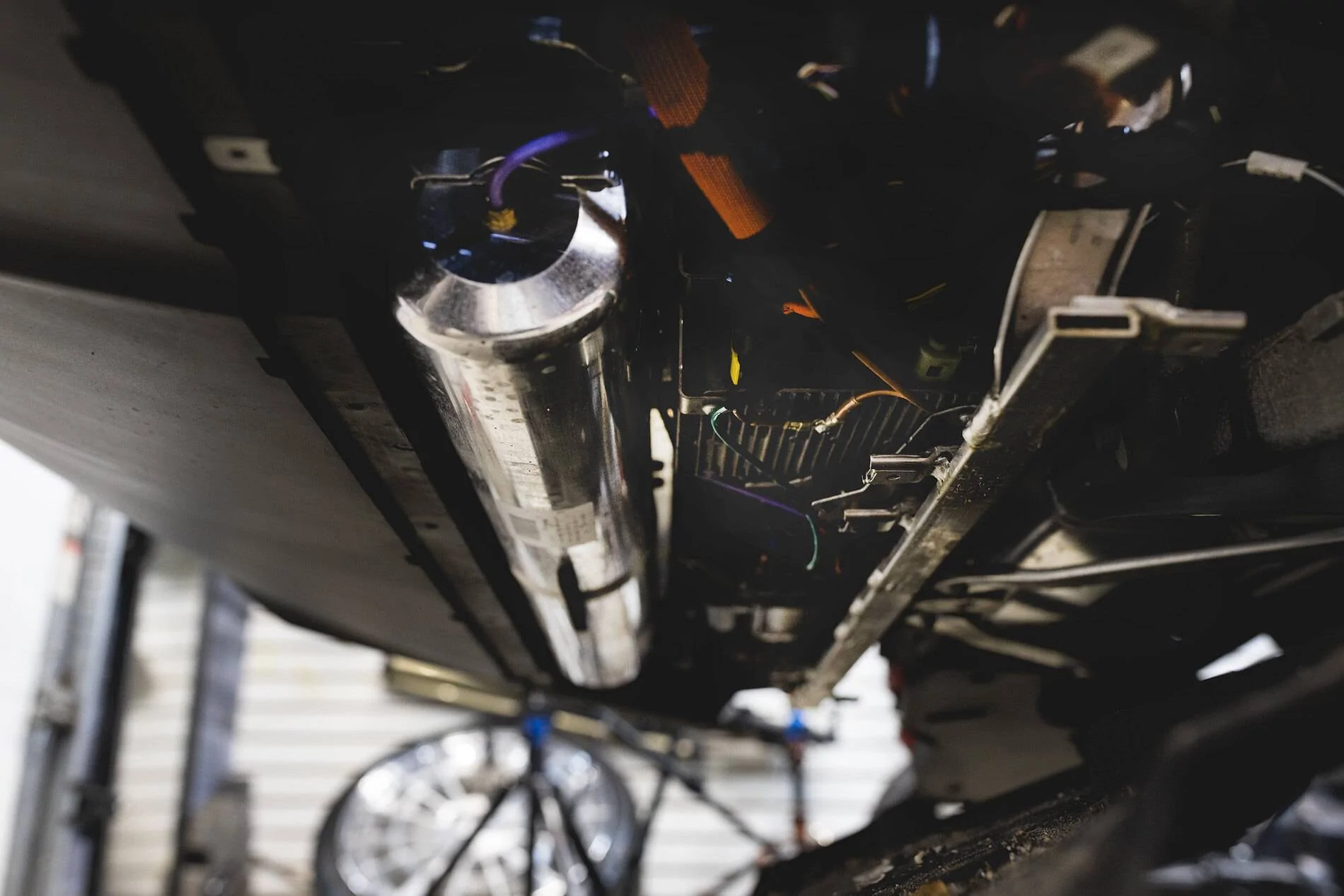

Annnnnd, it's great. Install was pretty easy, minus the horrible German > English translation. But, once you figure out where all of the sensors are for the ride height, it's a decent paced process.
My only gripe is that the app is pretty clunky and slow, but I spoke with someone from CETE who says that they're in the process of a more streamlined application.
Porsche Taycan Installed CETE Automotive Active Suspension Control - Air Suspension 51175109689_a5f643d420_k
Porsche Taycan Installed CETE Automotive Active Suspension Control - Air Suspension 51175109539_922ea1675e_k
Porsche Taycan Installed CETE Automotive Active Suspension Control - Air Suspension 51173642427_ca22af0c89_k
The air tank in the car is suuuuuper skinny. Not used to that, coming from big, fat 5 gallon tanks.

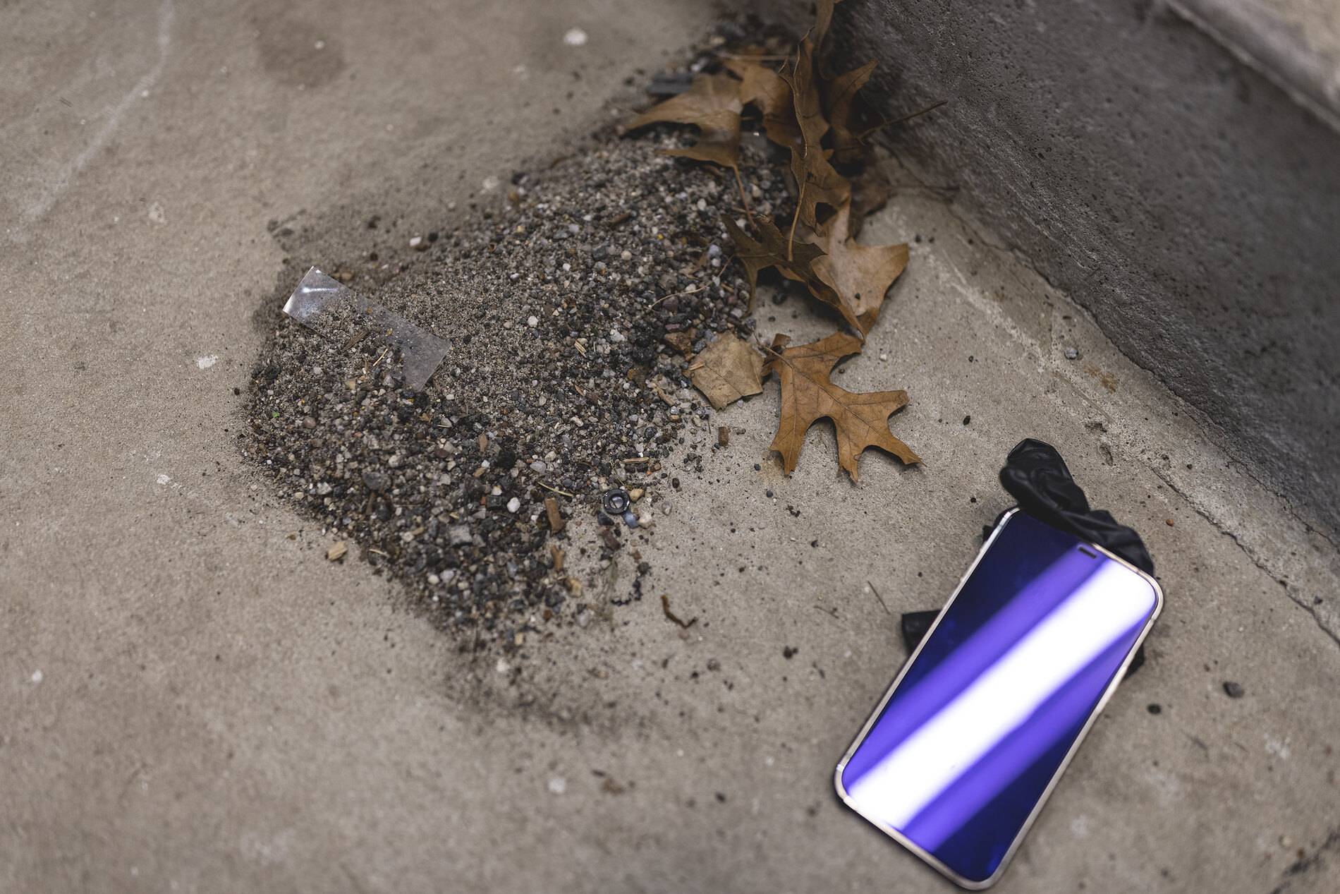

Also...got to reduce a little weight. This is after taking off only the front and rear underbody cladding. Gross.
That amount of trapped road grit is astonishing, especially for such a new Taycan. I'm curious if some of the rattles that others are reporting are due to vibrating road grit. Now I'm going to ask the detailers to pull my Taycan's cladding and document what they find.
Right? It was great getting all of that gnarliness in my snout, haha. I can only imagine what's trapped in the rear bumper cladding!
