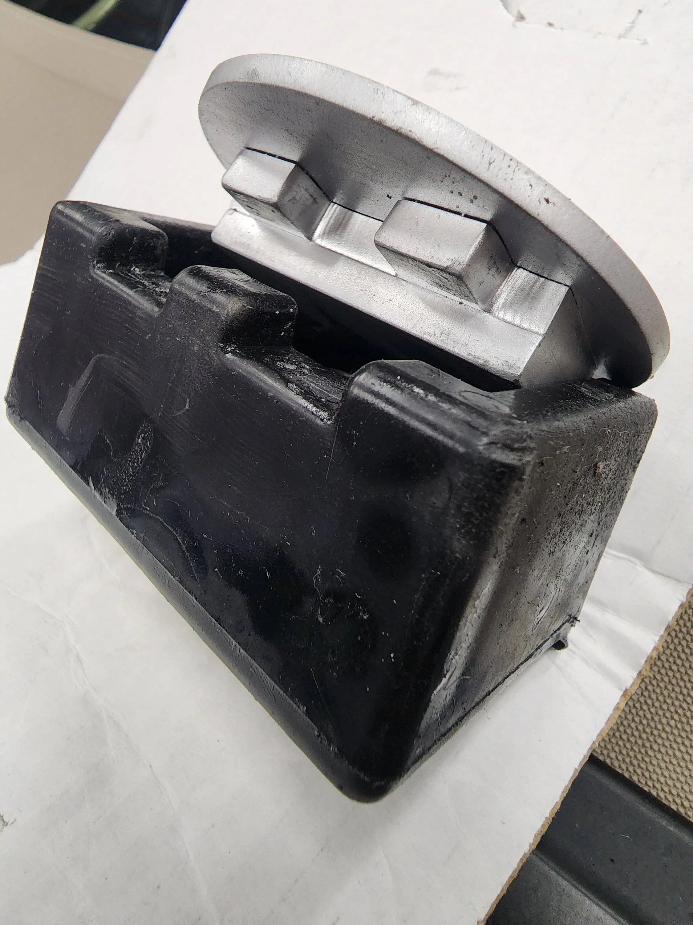

Wait till you see the Jack Pads we're making for our cars.
Every Porsche Owner should have at least One or Two.
Seriously, I've had two rear flats already and without my Jack Pad I would have been screwed. Here's what it looks like.
