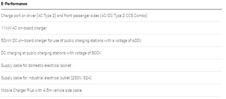

Hi, let me apologise and correct my earlier advice on supply cables as I was checking the standard specs again.
You will get a 32A supply cable with the car and therefore don't need to source another.
Public Mode 3 cable is still required for untethered public charge points - you may / may never use it but a good insurance to always carry one.
Standard spec - 13A 3 pin & 32A supply cables together with PMC+ (incl 4.5m vehicle cable).
