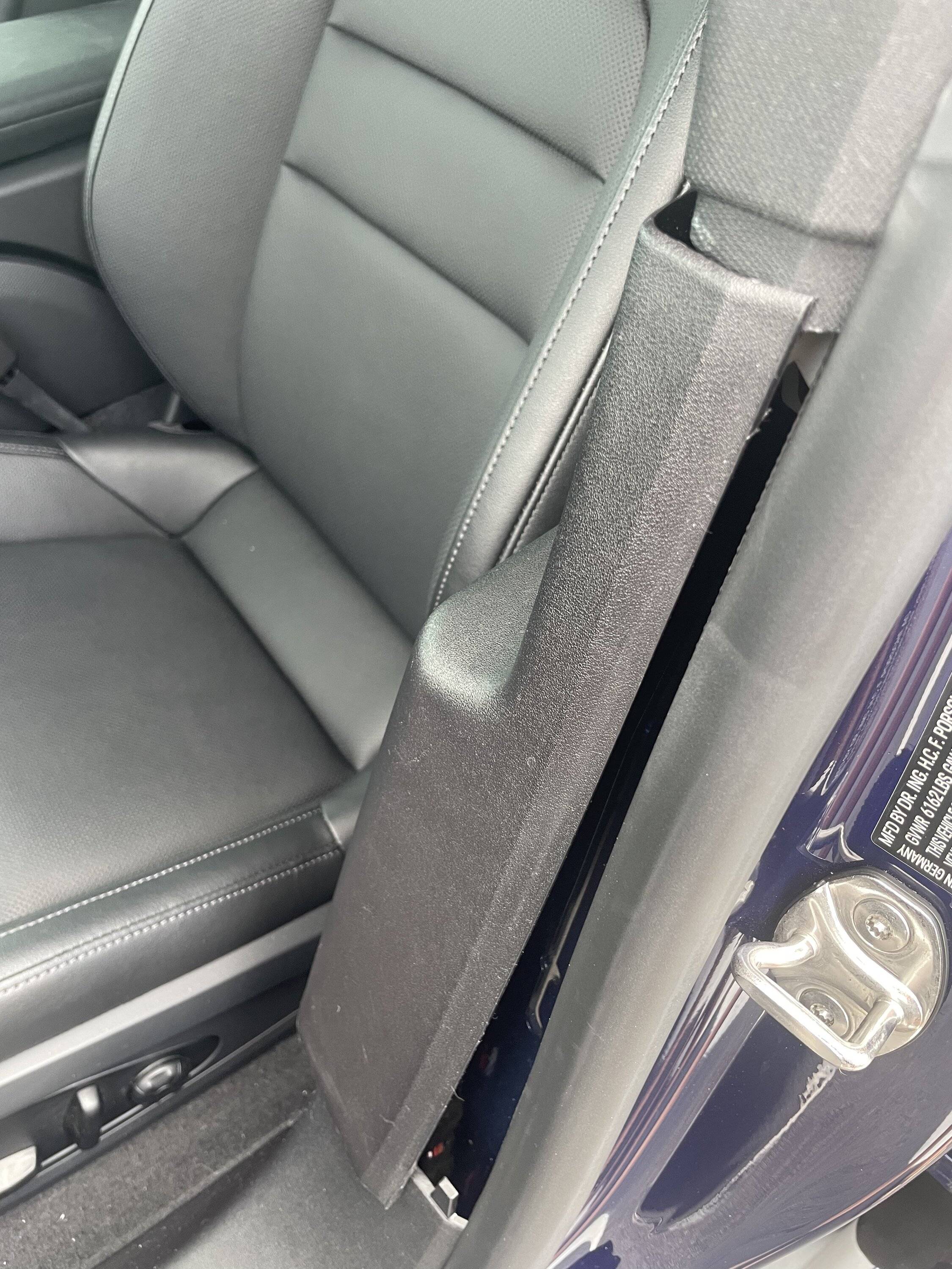

Hello, has anyone else experienced the b pillar trim piece below the seatbelt dislodging? Since the door opening is so small it’s nearly impossible to not rub on it getting in and out which I think is the culprit. I’ve brought it to the dealership once and within a few days same issue.

I experience this all the time. It is very difficult (for me at least) not to rub against it when getting into the car. It should not be so easy to dislodge. The cover spends most of the time in the back seat.

The car I test drove had the same issue. Thought it was a fluke. It’s a million times easier to get in and out without that piece attached. Definitely a design flaw.

My car had this same issue on delivery, it happened on my passenger side and I presume no one had sat in it. Turned out to be faulty clips on the trim panel. Fixed under warranty.
