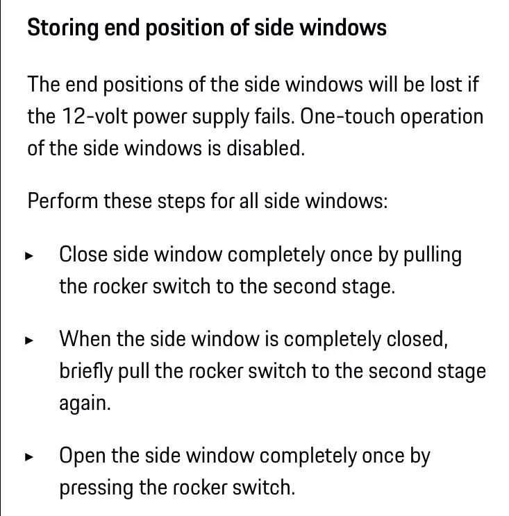

I have a 2022 Taycan 4S, when I press the back passenger window button on the driver controls or the back window control the window lowers but does not lower if you press down hard on the control for it to automatically lower or raise without needing to hold the button the entire time. It will just keep stopping on the way up or down until you hold the button the entire time. I’m not sure what issue could be causing this.

Common issue - front and back windows during my 3+ years ownership.
Easy fix by just doing the reset posted above.
