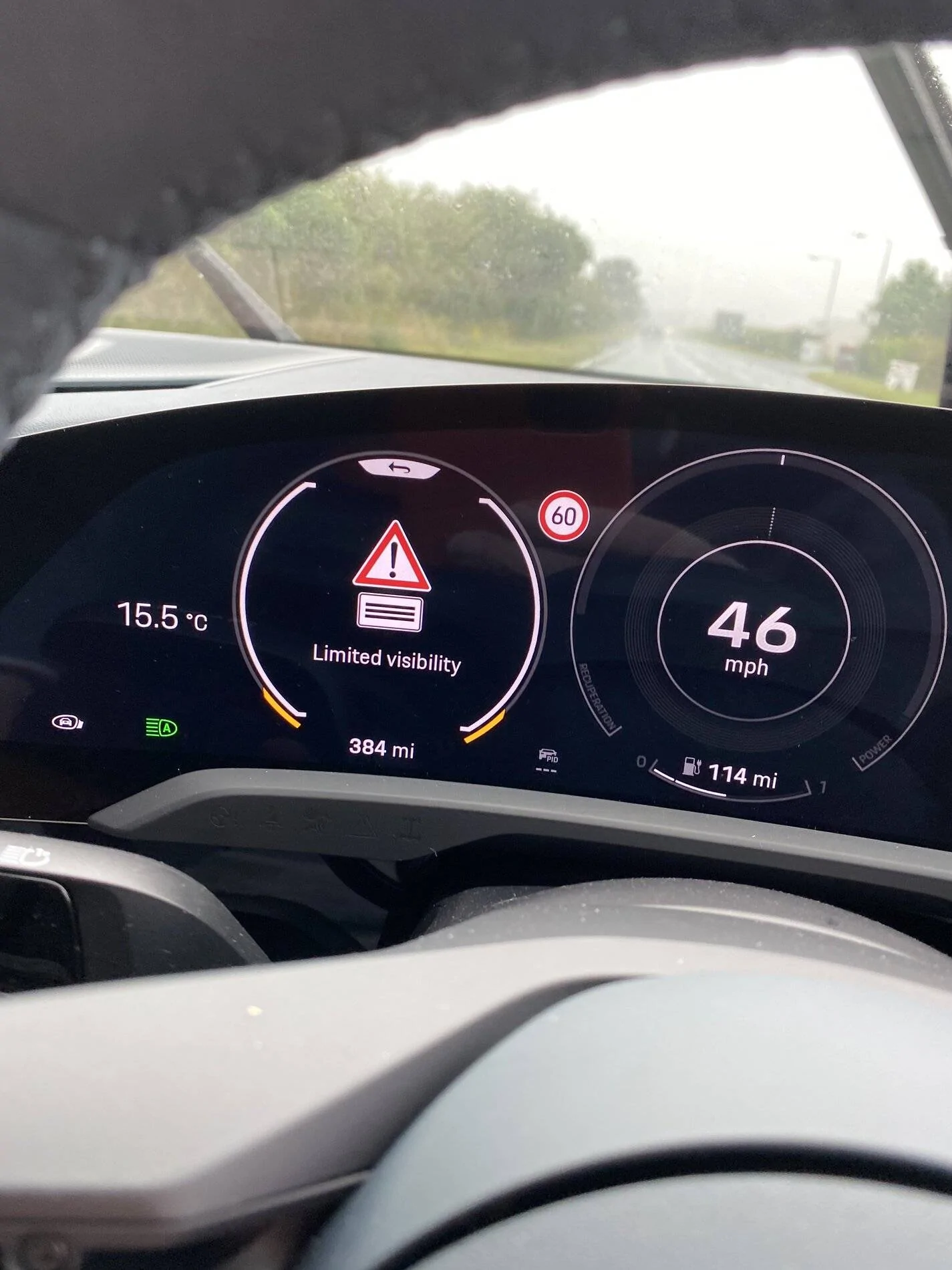

I keep getting the following message flash up on my screen . Cruise control is not active and it shows whether it’s a clear day or a rainy day.
Any ideas ? I have looked in the handbook but cannot see it anywhere

Heavy rain/clouds for one. Maybe one of your cameras/sensors is dirty.

Thanks for the replies.
It is very annoying. I have cleaned the sensors and it still keeps flashing up. As the last post says, as if I drive without looking where I am going. I dont need a car to tell me :)

I don't think its a dirty camera or sensor(s) issue - perhaps calibration - these do appear from time to time but not with a warning triangle, just a white text informational message. Sometimes its a false positive (more often than not).
It does look like its pelting down and perhaps (in this instance) there's an over reaction to it. But if it also happens when not raining then it does sound like a software glitch or calibration issue.
Suggest taking it to the dealer for a closer look
