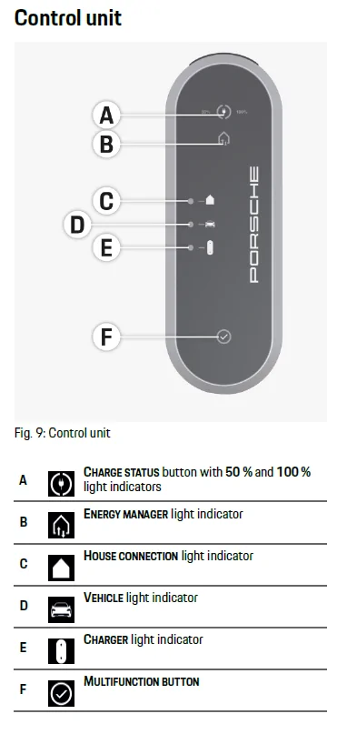

Last question for you, the mobile charger plus has different icons on it like a car and home, etc…should I be looking out for any of of these to light up? Right now I charge and the only light is the 100% light.
thanks again just trying to understand my new toy.

I'm not sure. I only connected the PMC+ one time for about an hour an a half or something just to test it. I have a different one as my main EVSE.
11,072
6,854
More granular control is possible when combining your profile with a timer - lots of details on this forum and in the charger manual - worth a read.
The lights relate to charging power 100% will supply the max (faster charging) to the car - again read the manual for a fuller description.
