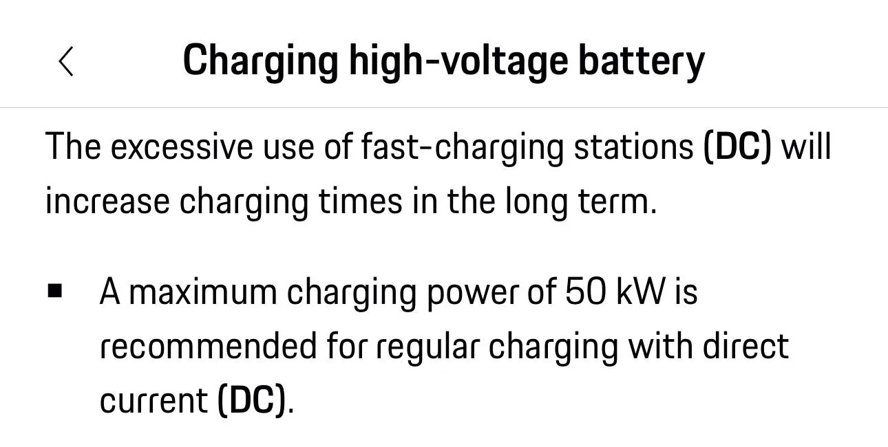

I thought that DC fast charging was only recommended to be done occasionally and slower charging on a regular basis was kinder to battery life. Am I wrong?
193
7,037
10,537
you're not wrong but 20 kW is not "fast" charging from the perspective of the the battey - 200 kw and higher is "fast" charging…
it's not the "DC" charging that "wears" the battery - it's stuffing 200-340 kW of power into the LiON cells that causes the "pressure" and wears them more aggresively…
20 kW is a "light spring rain" and no different in wear/tear than AC charging…

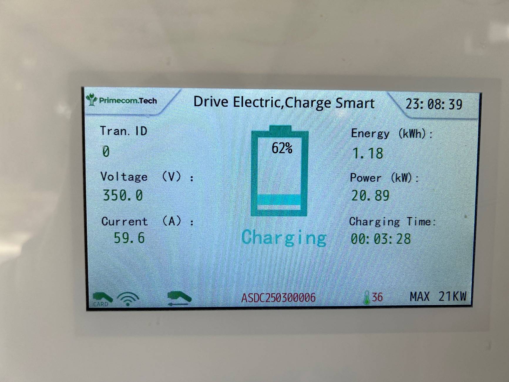

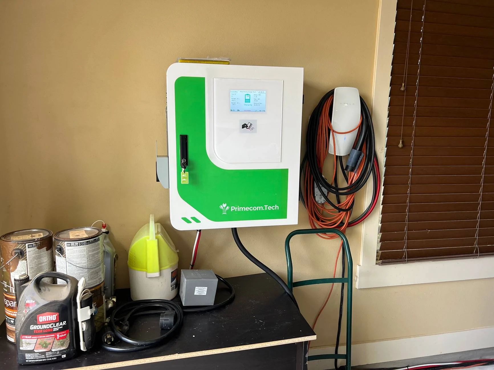

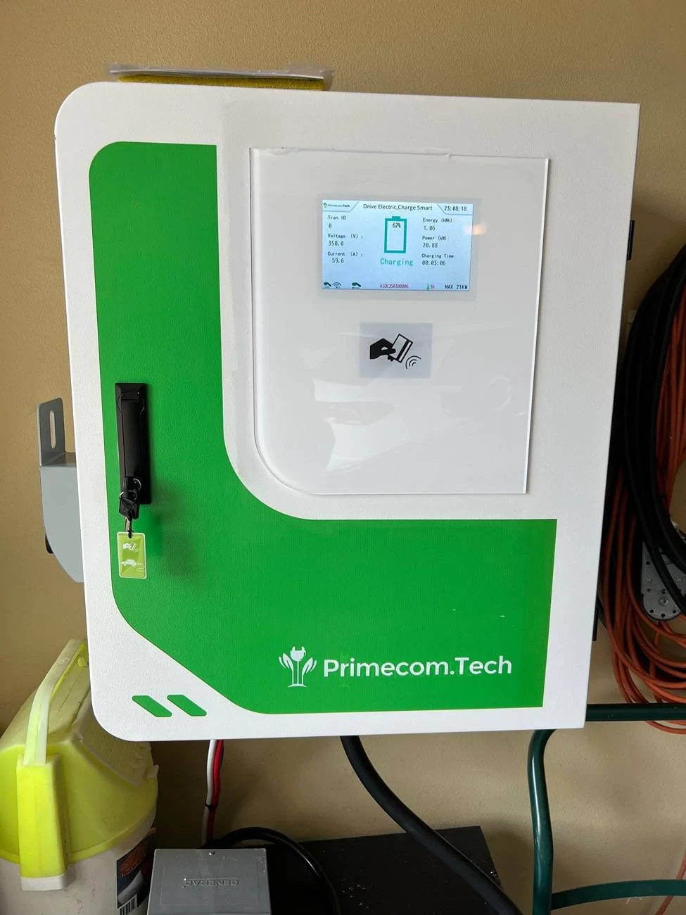

Here is a pic of my installation.
Porsche Taycan DC Charging at Home IMG_3095
Porsche Taycan DC Charging at Home IMG_3094
Porsche Taycan DC Charging at Home IMG_3096
