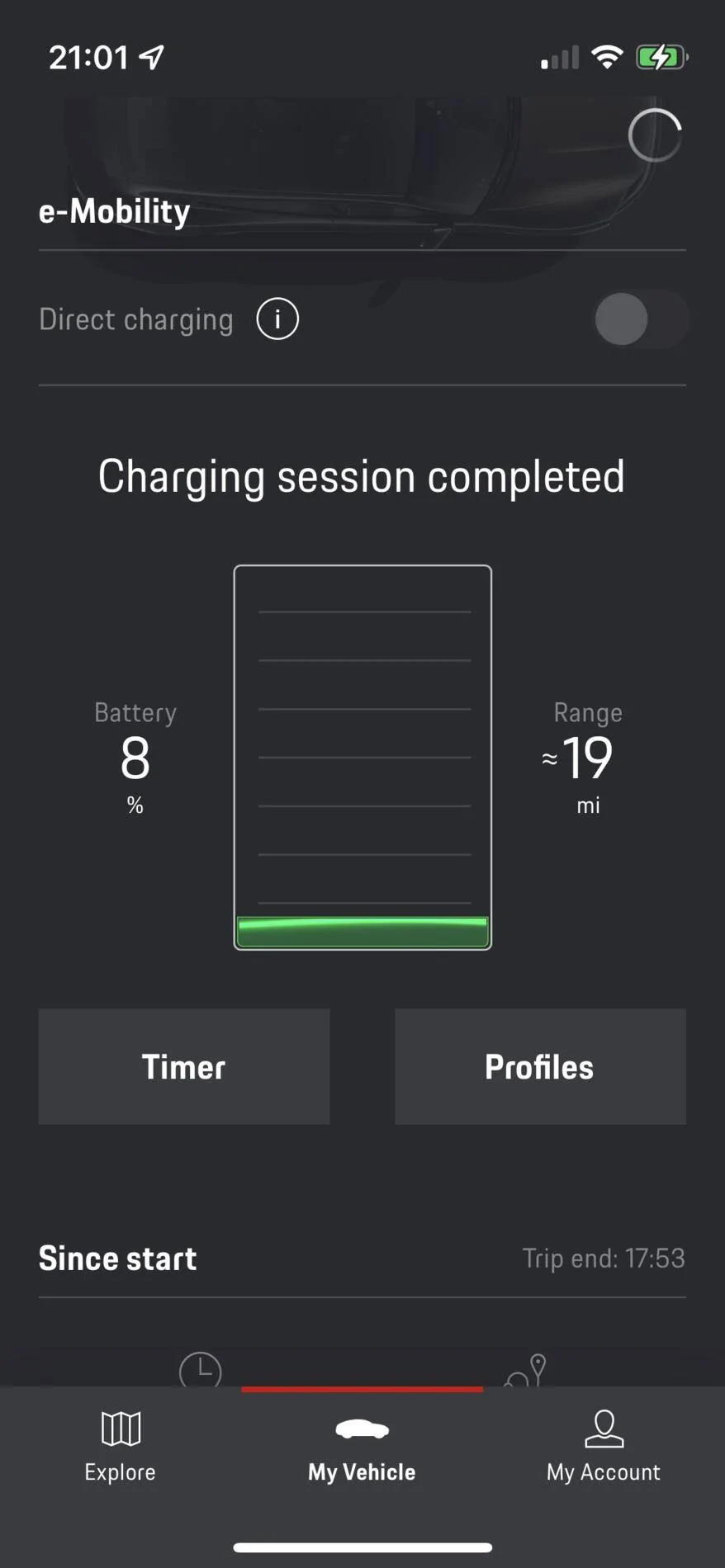

I have exactly this issue after arriving home on 4% having ignored all it’s suggested charging stops. I can’t seem to break out of it either.
Evnoob
Daniel
May 15, 2021
Uk
Another bug - it thinks it’s already charged, but it’s still going up, and I can’t adjust it. No idea where it’s going to stop, maybe 100% :(
