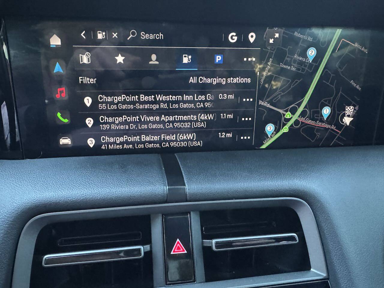

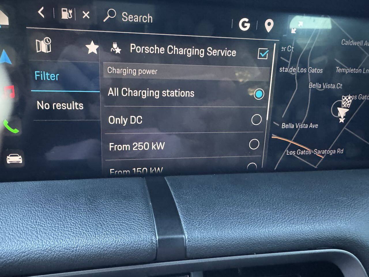

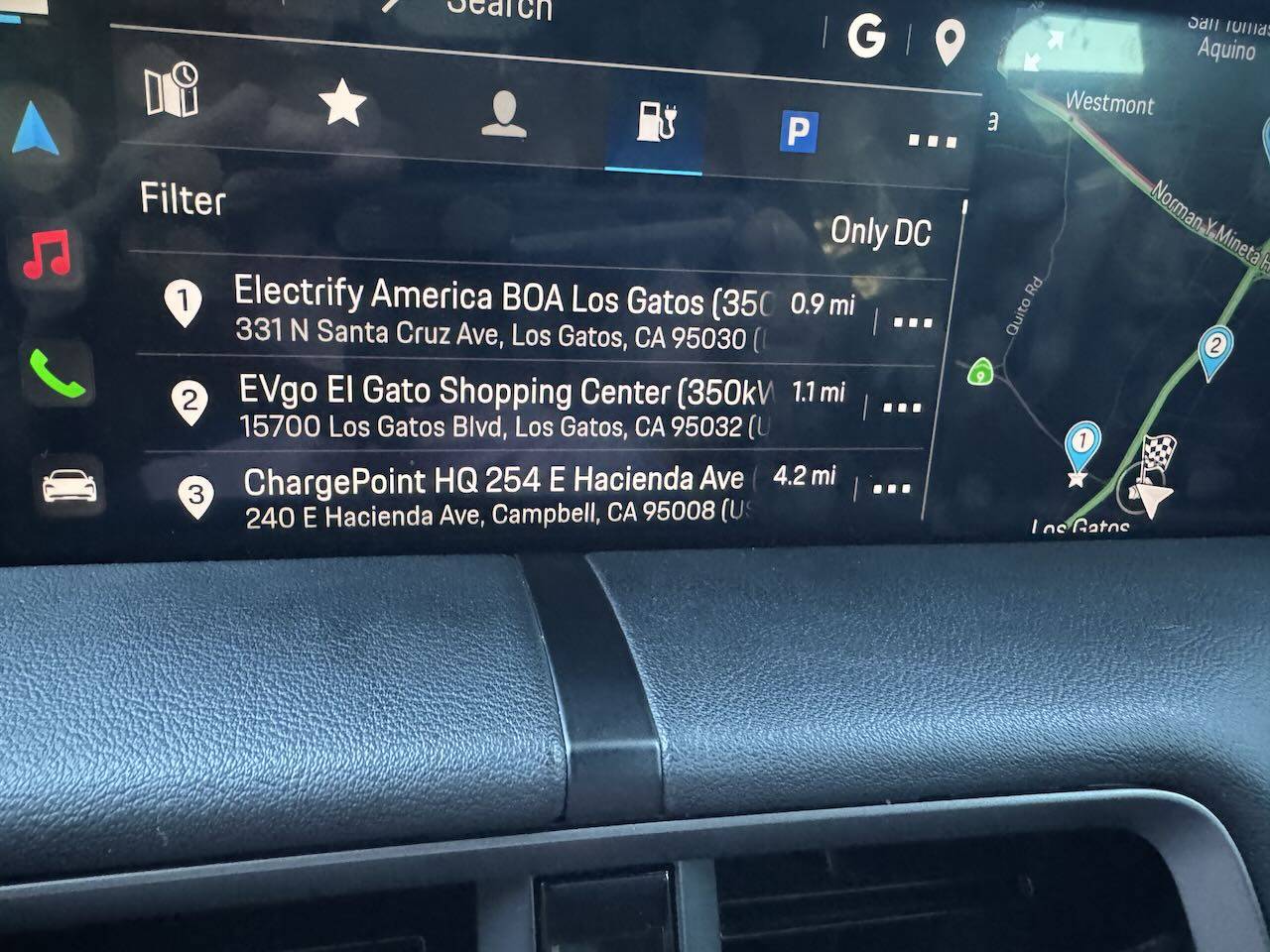

Golfer Curt
Golfer Curt
Curt
Jul 15, 2022
94043
2022 Taycan Cross Turismo
Hi, Please see the attached pictures. Note when I got the car about 3 years ago you could just do a search in the nav systems for nearby charging stations now this doesn't work. Yes I know I can use the Electrify America or other providers apps but that is not the point.
Also If I say Hey Porsche find nearby Electrify America stations the car will find them.
This is not the biggest problem but it is annoying.
Thanks
Porsche Taycan Charging Station Search in PCM Not Working IMG_1350
Porsche Taycan Charging Station Search in PCM Not Working IMG_1351
Porsche Taycan Charging Station Search in PCM Not Working IMG_1352
