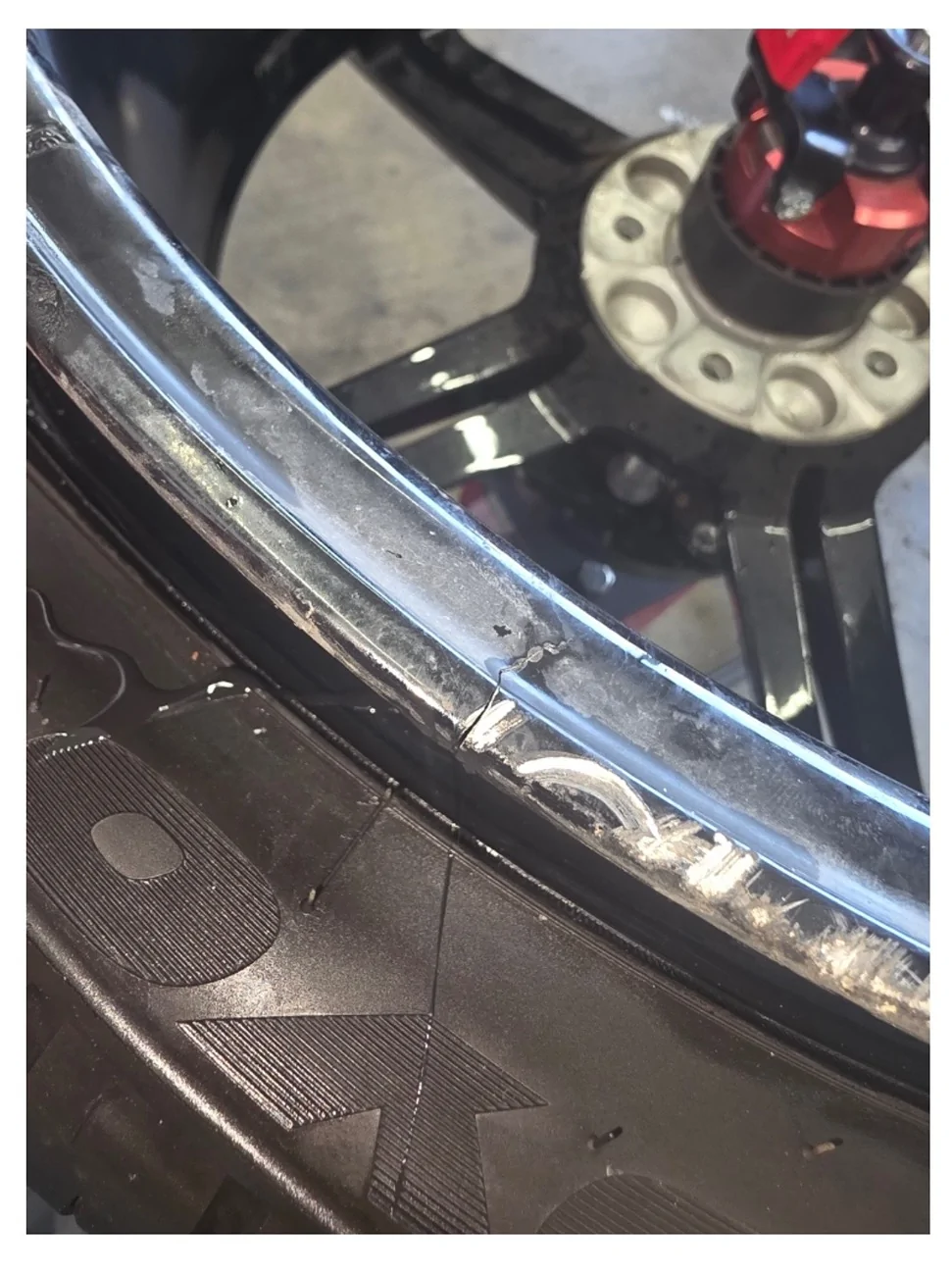

Cracked 21" wheel

Yes unfortunately the 21 does not like the pothole. This is why I switch to 20.

replace it rather than getting it fixed (used would be fine) - my logic is that this is such a heavy car and risk is too high.
I 10000% agree. Welding is a temporary fix that creates a combination of a hard spot as well as two new weak spots. It will last you until you find a smaller pothole and you have failure again, but either way worse, like catastrophic or minor slow leak, but it's one of the two for sure.
I've cracked an AMG rim and my solution was to look on Facebook Marketplace for a full new/used set with bad rubber, keep three, use one, and then be ready for next time... sadly.

I cracked a wheel in a pothole.....I was on the low chassis setting in Sport.
I saved the wheel, but is sounds like a repair is not advisable.

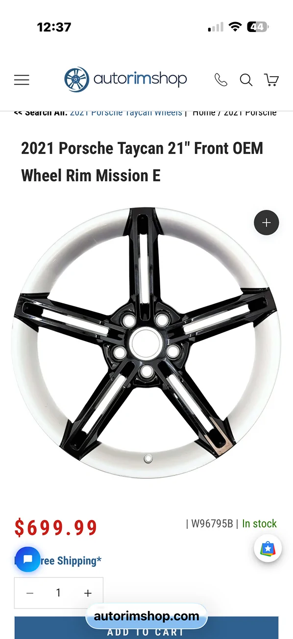

I located a wheel from an outfit called Autorim. Anything I need to know before I pull the trigger?
As long as it's OEM and the exact part number as what you're replacing then you should be OK.
You may want to inspect it since it's not coming from a stealership, so why do these guys have it and has it been "expertly repaired".
I know in my area 90% of the Taycan wheels for sale (all in sets of 4) are for sale by dudes who somehow are buying up, or have access to, used sets and then reselling them and effectively making/controlling the market. I have no idea what a full set would cost you, if you can buy a full set for $2000or a single for $700 there could be a case to have a spare, although I'll admit that it's way less likely you'll damage a back wheel from my casual discussions with friends who've suffered.
my only obvious concern is that the spoke at 5pm in the picture is a different color, has it been sanded to take off curb damage and not repainted?
