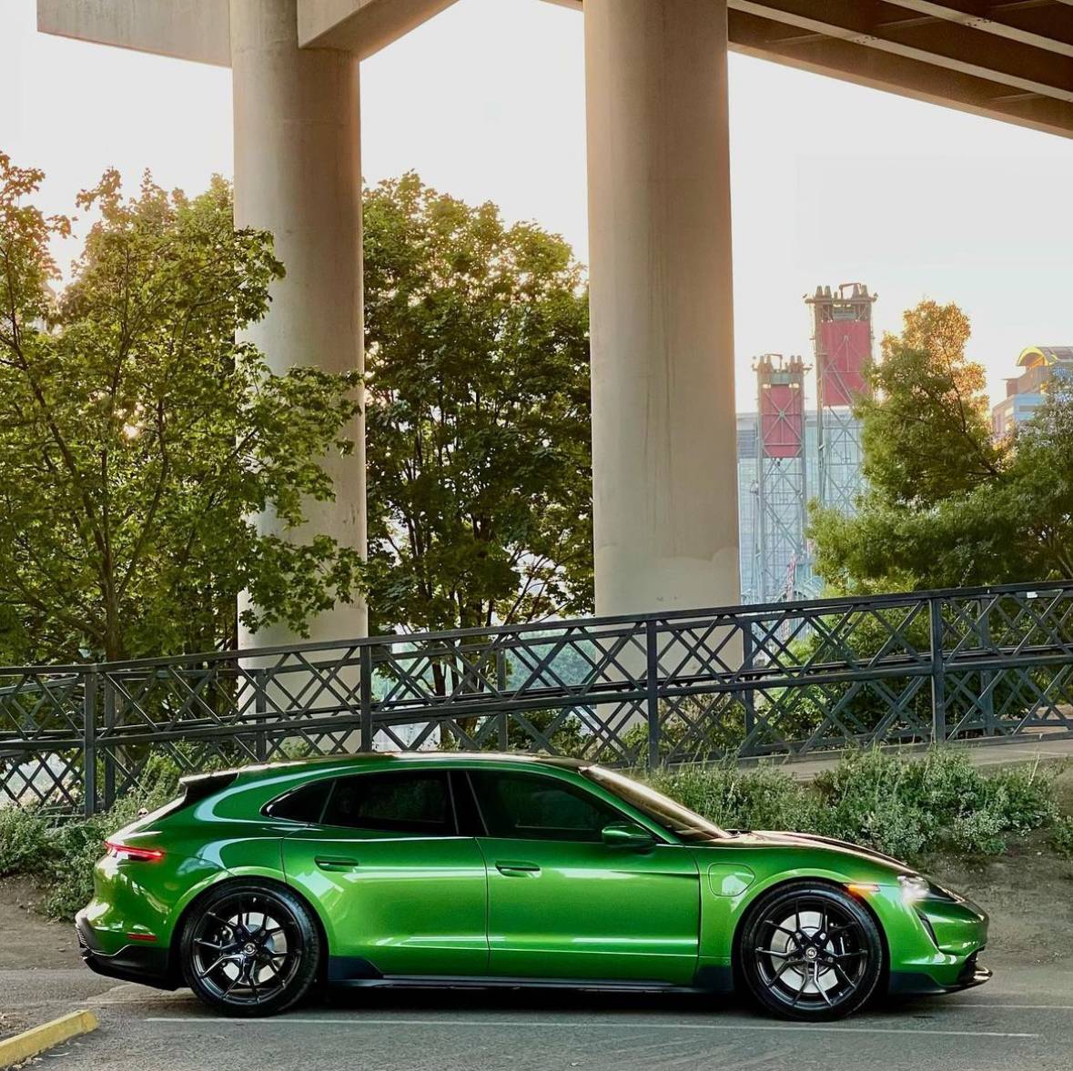

Here’s my original thread on this. https://www.taycanforum.com/forum/threads/removed-arches-on-cross-turismo-w-ordp-photos.9018/
A couple examples:
I’ve seen examples without the ORDP and the arches removed and the step on the lower plastic is not that obvious (there may be pics buried in the thread above). You’ll also want to avoid having surround view as it leaves larger holes in the front bumper for the extra park distance sensors.
Yes those are the examples I’ve seen (great job!) but both have the ORDP, which helps with that lower plastic bit….which is why I was asking about cars without it. I guess I could go one step at a time, remove the arches and see what I’m dealing with. Do you know if there’s just a single hole/plug required, or is there another hole or two exposed without the ORDP? Thanks :clap:
Yeah, it’s covered in the linked thread. Without ORDP there will be 3 holes visible on each front corner and one hole in the rear bumper.
Oh and with the surround view sensor this is basically a lost cause? I think one of the cars I’m eying does have it
Yeah. Someone checked and it’s not just a hole the size of the sensor, it’s larger. At that point painting or wrapping the arches is probably your best option.

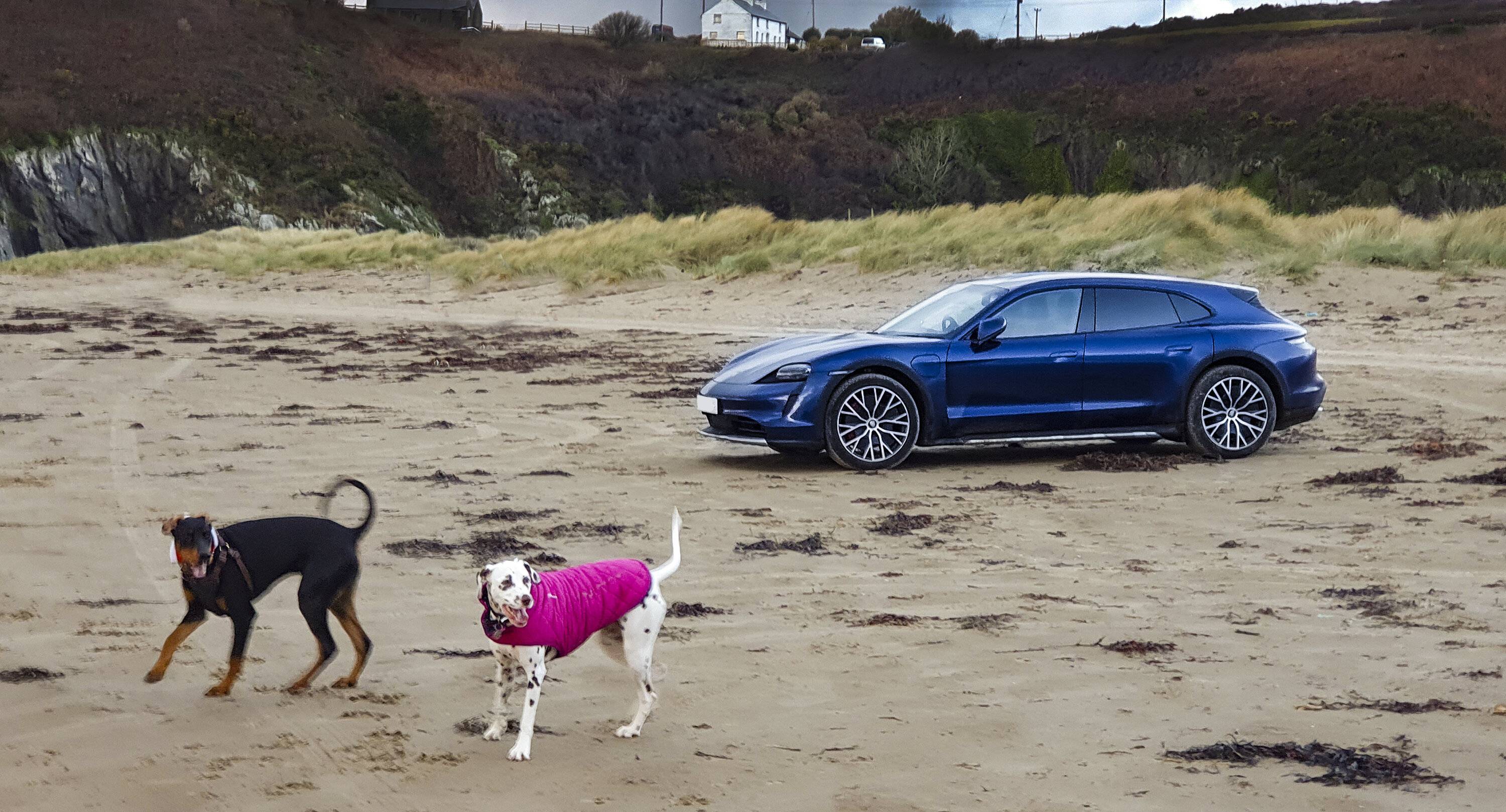

I don't love them but they saved a rear wing respray when I grazed a gnarly wall once. I replaced the plastic for £43 rather than respray for £500! TBH I don't even notice them on Gentian Blue any more.
Porsche Taycan Cross Turismo arch removal and side skirts morfa dogs 2021-12-28 15.34.29
Yes on gentian, black, or mamba they look decent enough. But on lighter colours not so much (to me anyways)
