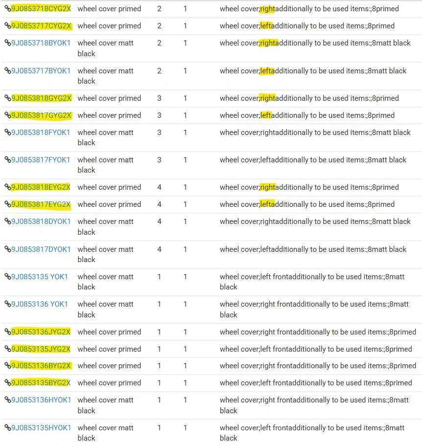

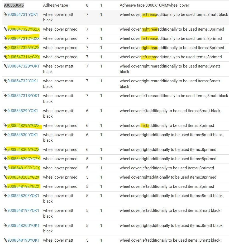

So i am in the middle of this, and it is a bit confusing.
I started from this helpful list:
19J0-853-135-BY-G2X
29J0-853-136-BY-G2X
39J0-853-717-CY-G2X
49J0-853-718-CY-G2X
59J0-853-817-GY-G2X
69J0-853-818-GY-G2X
79J0-853-817-EY-G2X
89J0-853-818-EY-G2X
99J0-854-819-EY-G2X
109J0-854-820-EY-G2X
119J0-854-829-AY-G2X
129J0-854-830-AY-G2X
139J0-854-731-AY-G2X
149J0-854-732-AY-G2X
But something does not make sense.
Charts show 7 parts on each side:
Porsche Taycan CT Turbo S wheel arches 1744690813490-2x

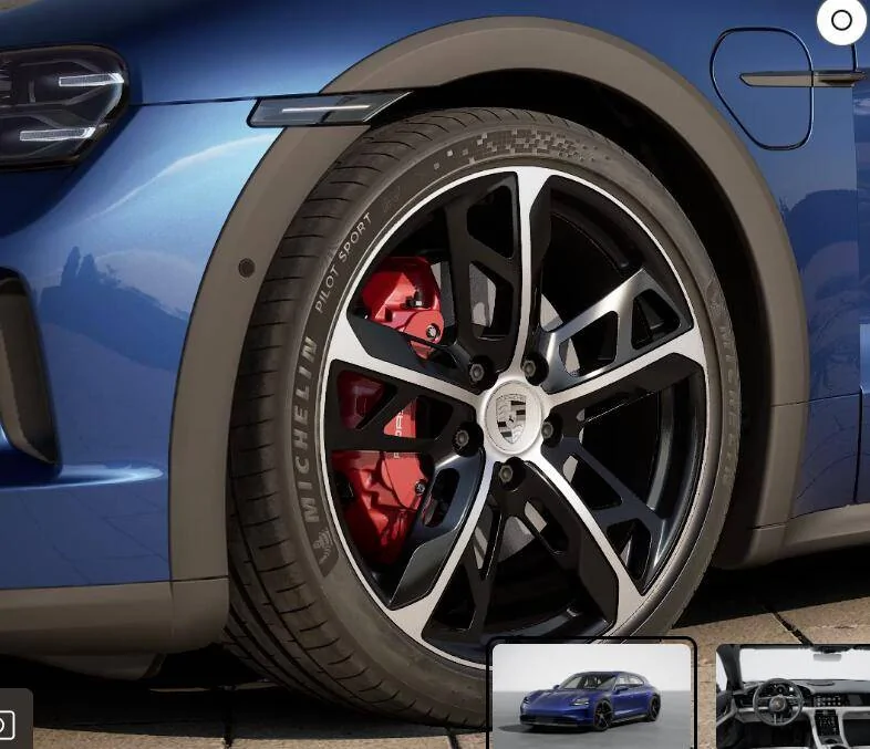

But pictures stubbornly show 3 parts on the front side. not 4. I can see why the part numbers would be different with/without ultrasonic sensors, but part 3 above in the assembly view does not seem to comport with any Cross Turismo configuration ?
Porsche Taycan CT Turbo S wheel arches Taycan-CT-front
(web picture, my car is in transit but even the 3D configurator shows the same config)
Porsche Taycan CT Turbo S wheel arches 1744692056245-m5
So issue #1 is whether the correct combination is 12 parts, which 12 (minus those belonging to position 3 above ?).
Issue #2 iswhether position 1 also has an option with/without ultrasonic sensor ?
And did anyone find the spec of the VHB adhesive to use to avoid delamination ?
Help much appreciated !

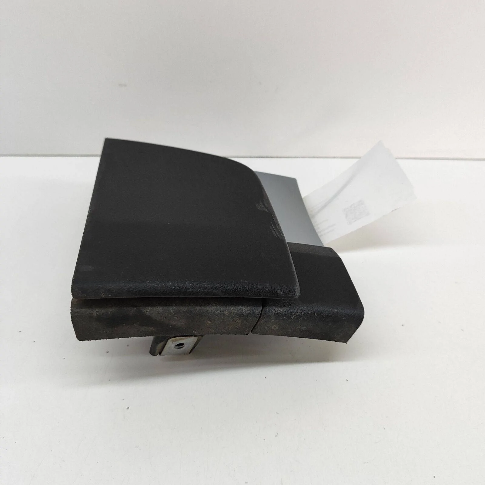

I'm guessing that #3 is if the Offroad Design Package (ODP) is optioned. Here is the front right wheel ODP moulding from an eBay listing (https://www.ebay.co.uk/itm/145726089267):
Left is down, #3 is on the lower right
Porsche Taycan CT Turbo S wheel arches xa9WqL3
To get an overview, check this link to all the trim parts for TurboS: TurboS compatible
(edit: changed link to TS).
