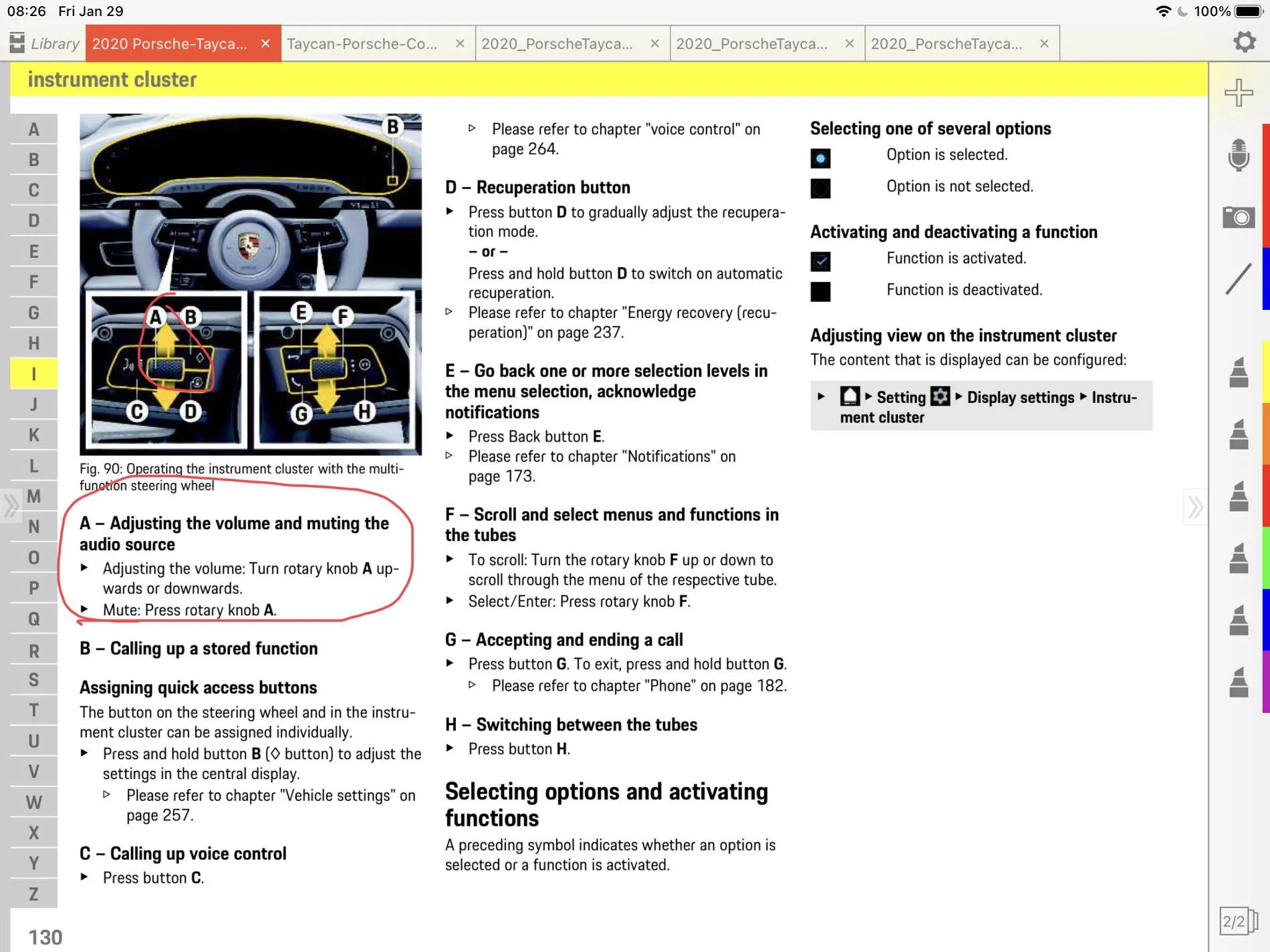

I wondered if anyone experiment this issue and if there is a simple solution. I haven’t organised myself enough yet to sort the apply play (I will get to it in time).
Have you checked to make certain that you have not accidentally muted sound via the control wheel on the left hand side of the steering wheel?
