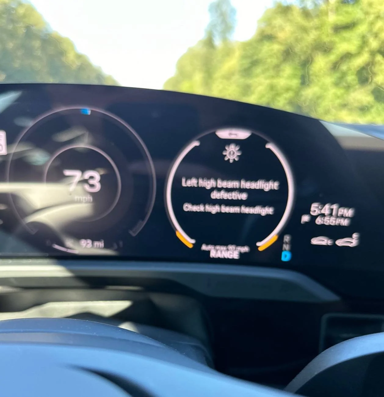

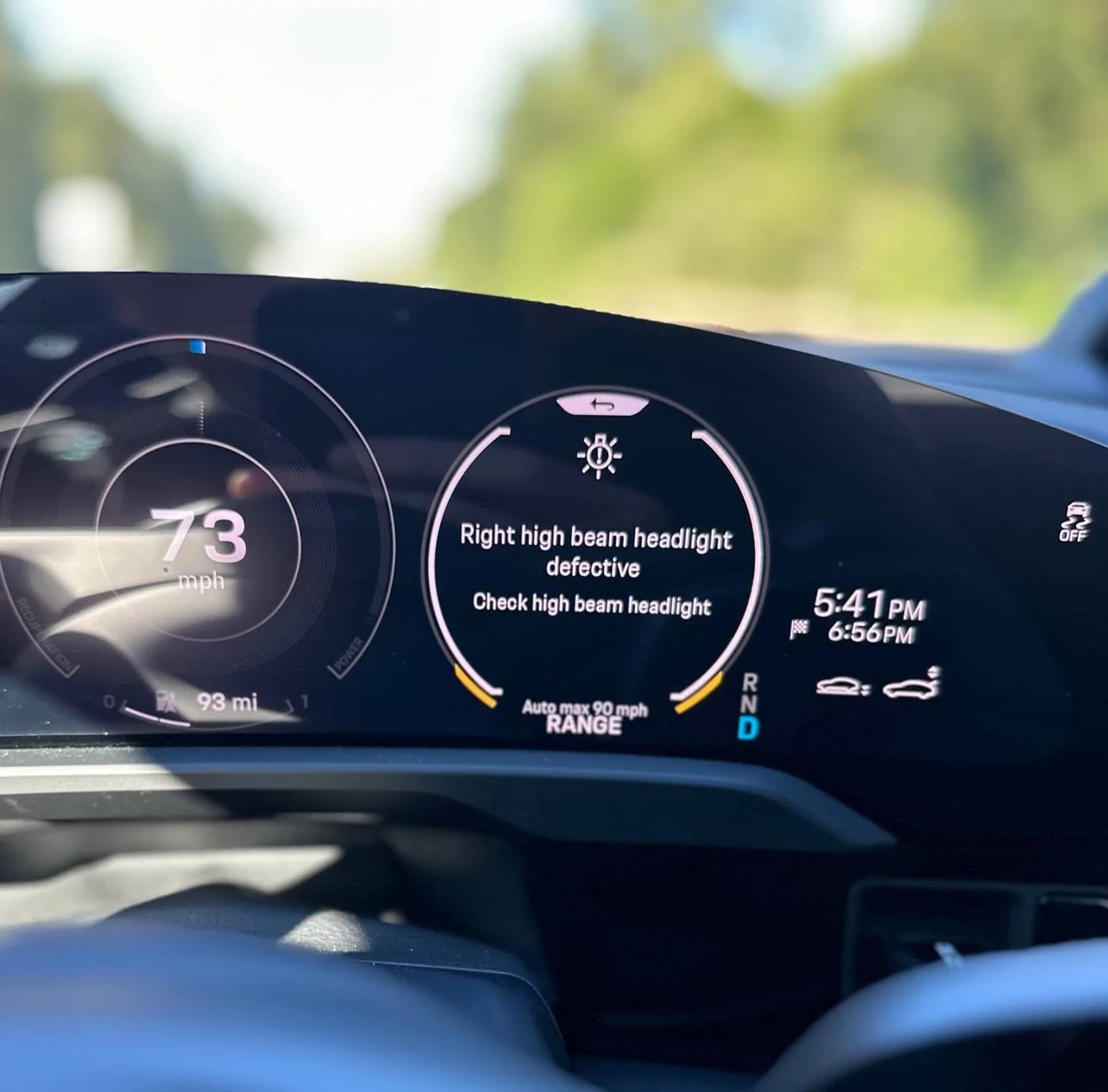

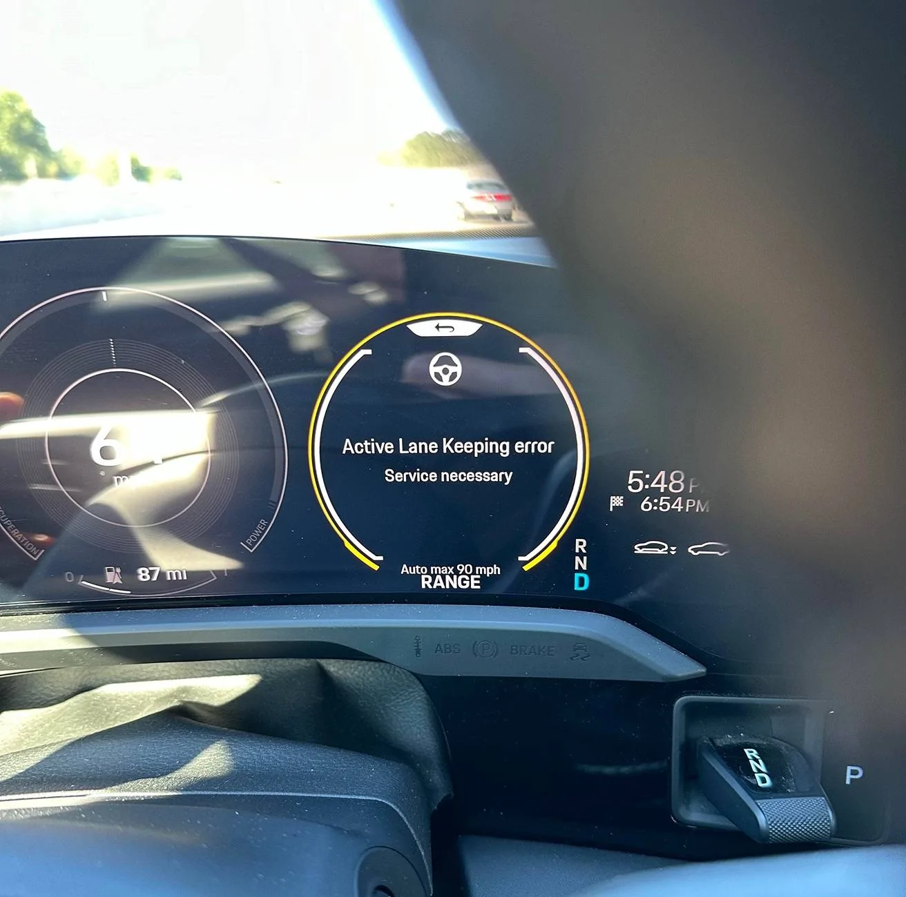

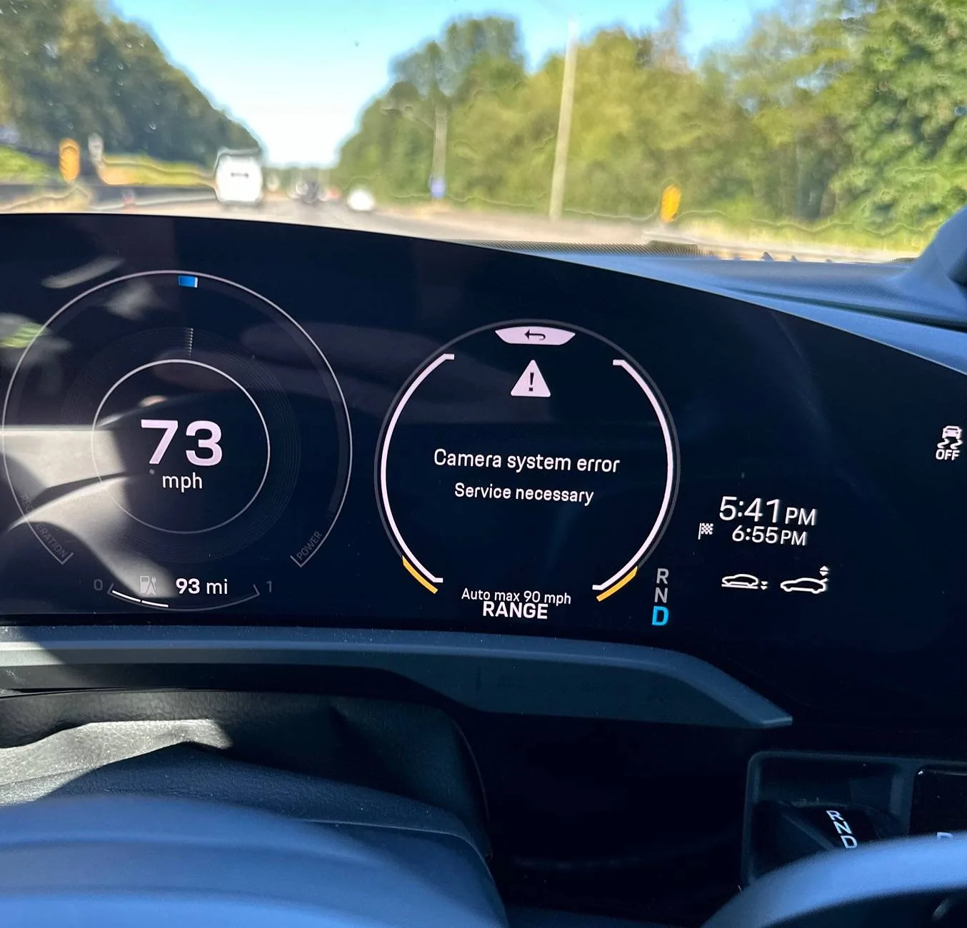

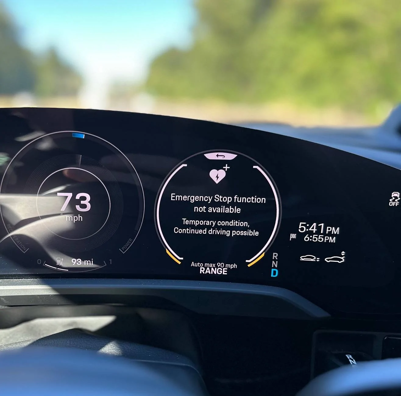

Experienced these new warnings and checking to see if others have encountered, with a dealer fix:
  • Camera System Error - Service Necessary
  • Active Lane Keeping Error - Service Necessary
  • Emergency Stop Function Not Available - Temporary Condition, Continued Driving Possible
  • Left High Beam Headlight Defective - Check High Beam Headlight
  • Right High Beam Headlight Defective - Check High Beam Headlight
There may have been other notifications, but they came up and disappeared rapidly. While on the highway I pulled off and shut the car down to see if rebooting would fix it. After the car sat for a while, upon rebooting, they did not appear. A few days later, the same warnings came up again while driving.
47,000 miles. It’s headed to the dealer’s shop next week, just before the warranty expires…
Porsche Taycan Electrical Gremlins IMG_2906
Porsche Taycan Electrical Gremlins IMG_2907
Porsche Taycan Electrical Gremlins IMG_2908
Porsche Taycan Electrical Gremlins IMG_2909
Porsche Taycan Electrical Gremlins IMG_2910

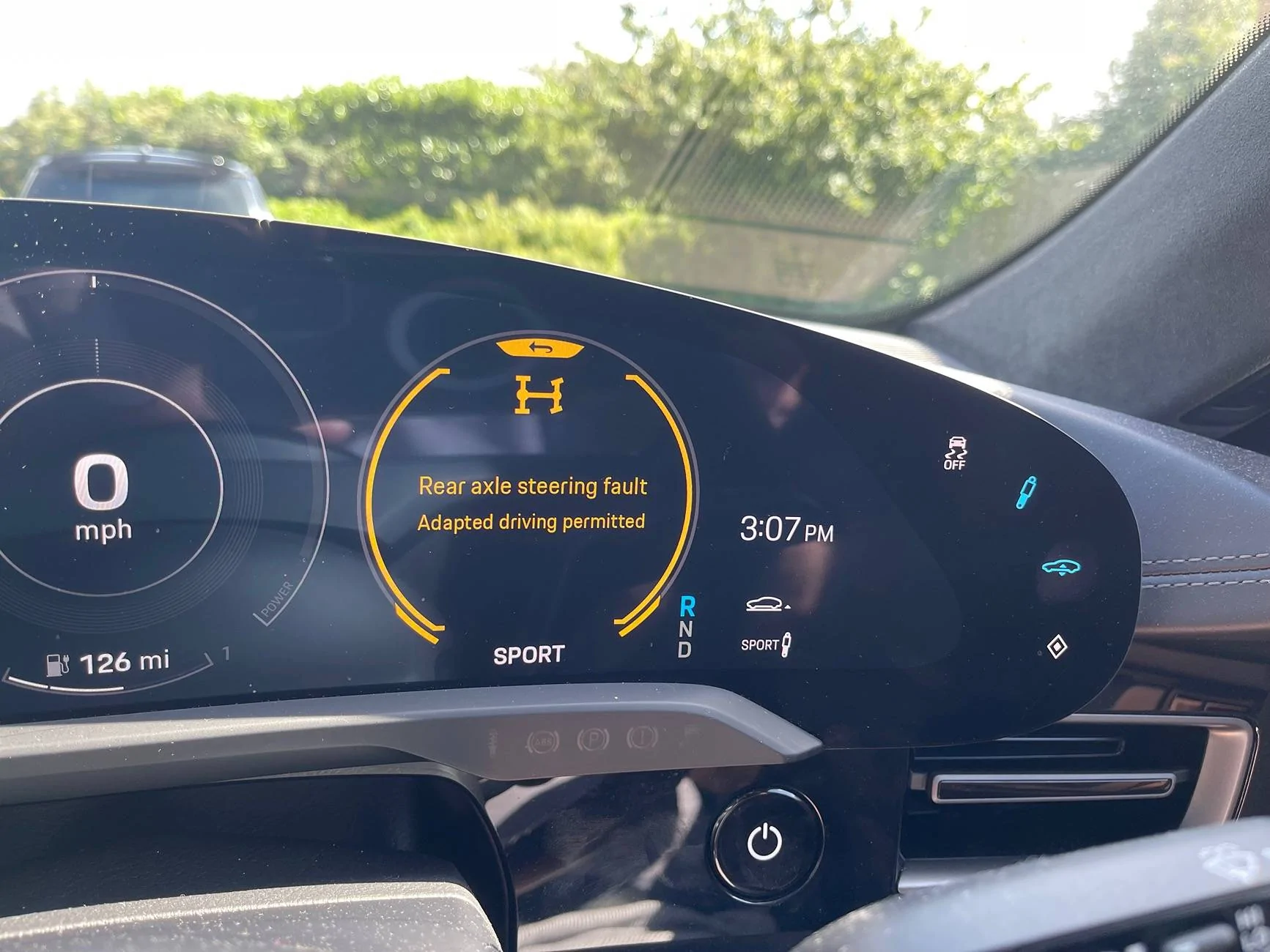

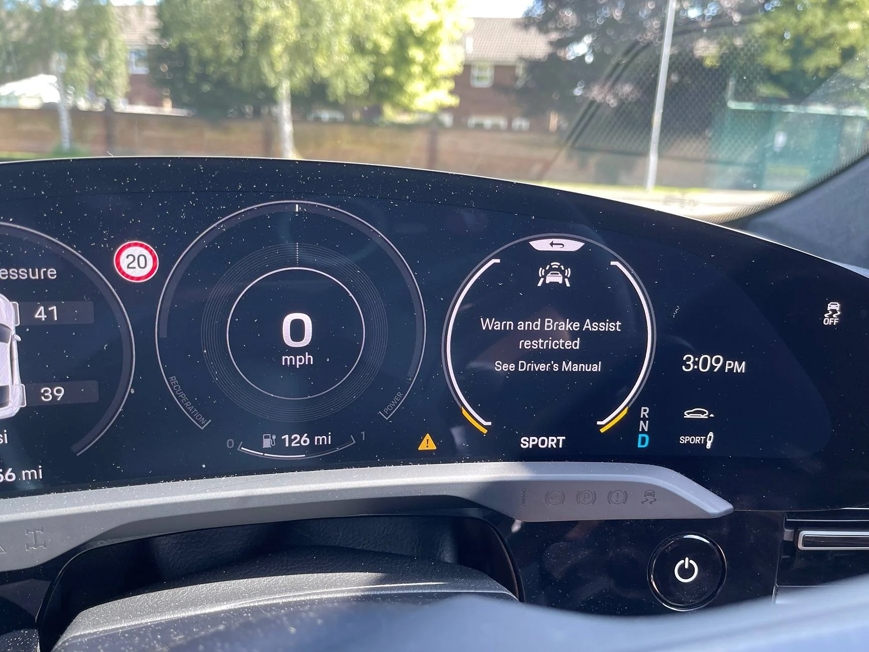

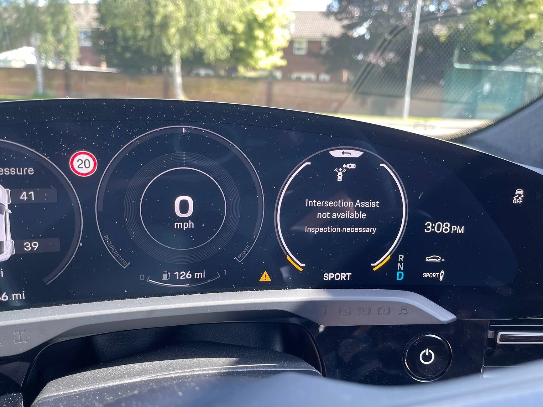

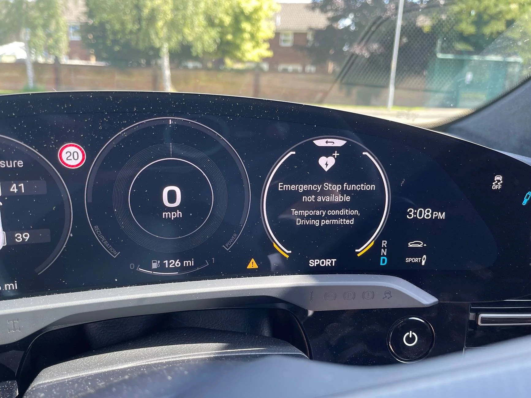

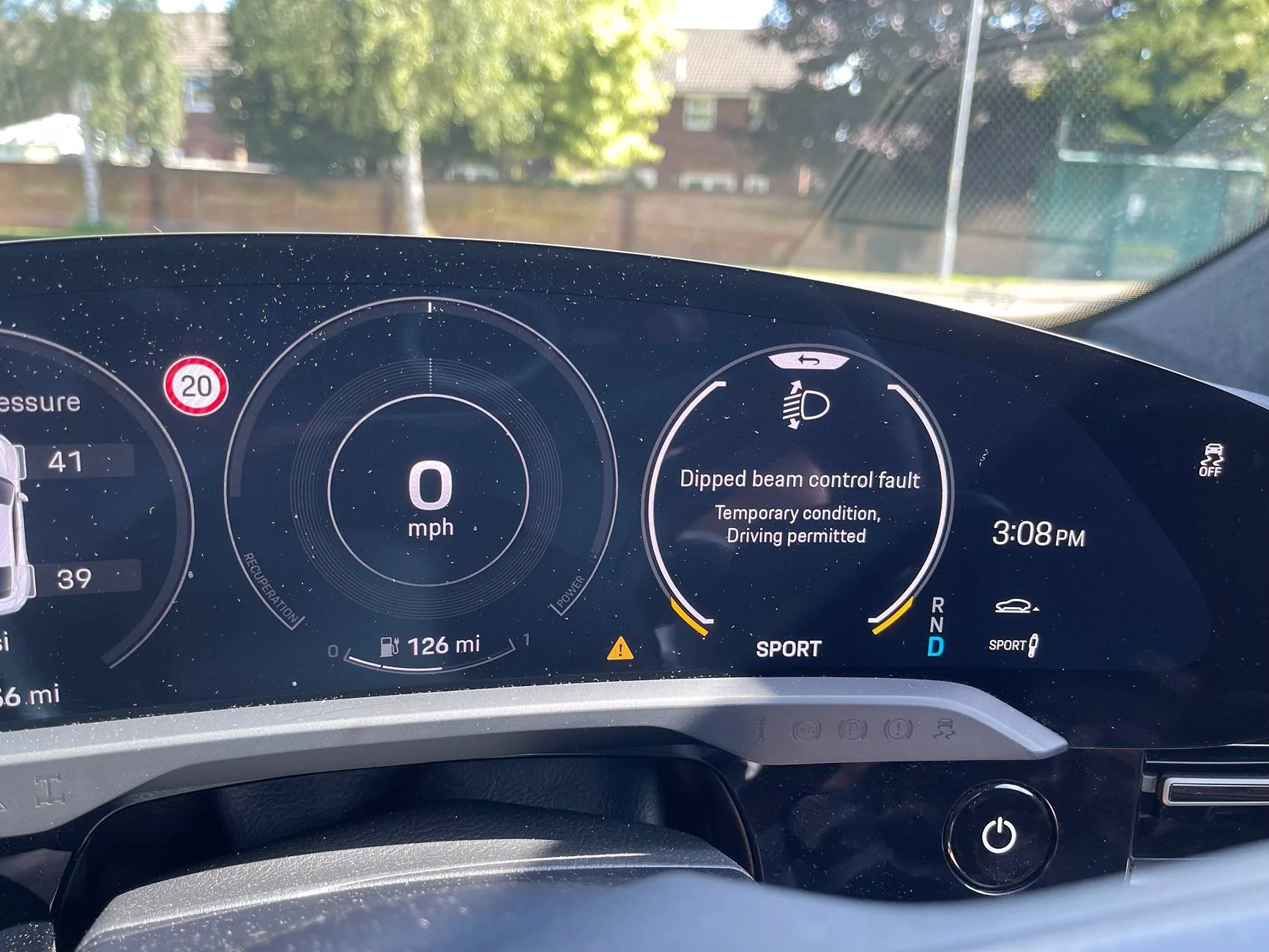

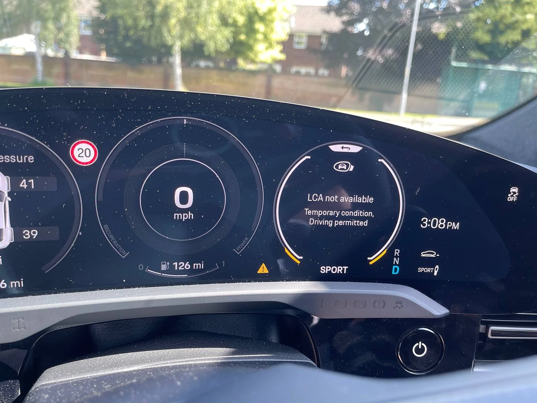

I saw these about a year ago. They went away and have not returned since.
Porsche Taycan Electrical Gremlins IMG_1143
Porsche Taycan Electrical Gremlins IMG_1142
Porsche Taycan Electrical Gremlins IMG_1141
Porsche Taycan Electrical Gremlins IMG_1140
Porsche Taycan Electrical Gremlins IMG_1139
Porsche Taycan Electrical Gremlins IMG_1138
