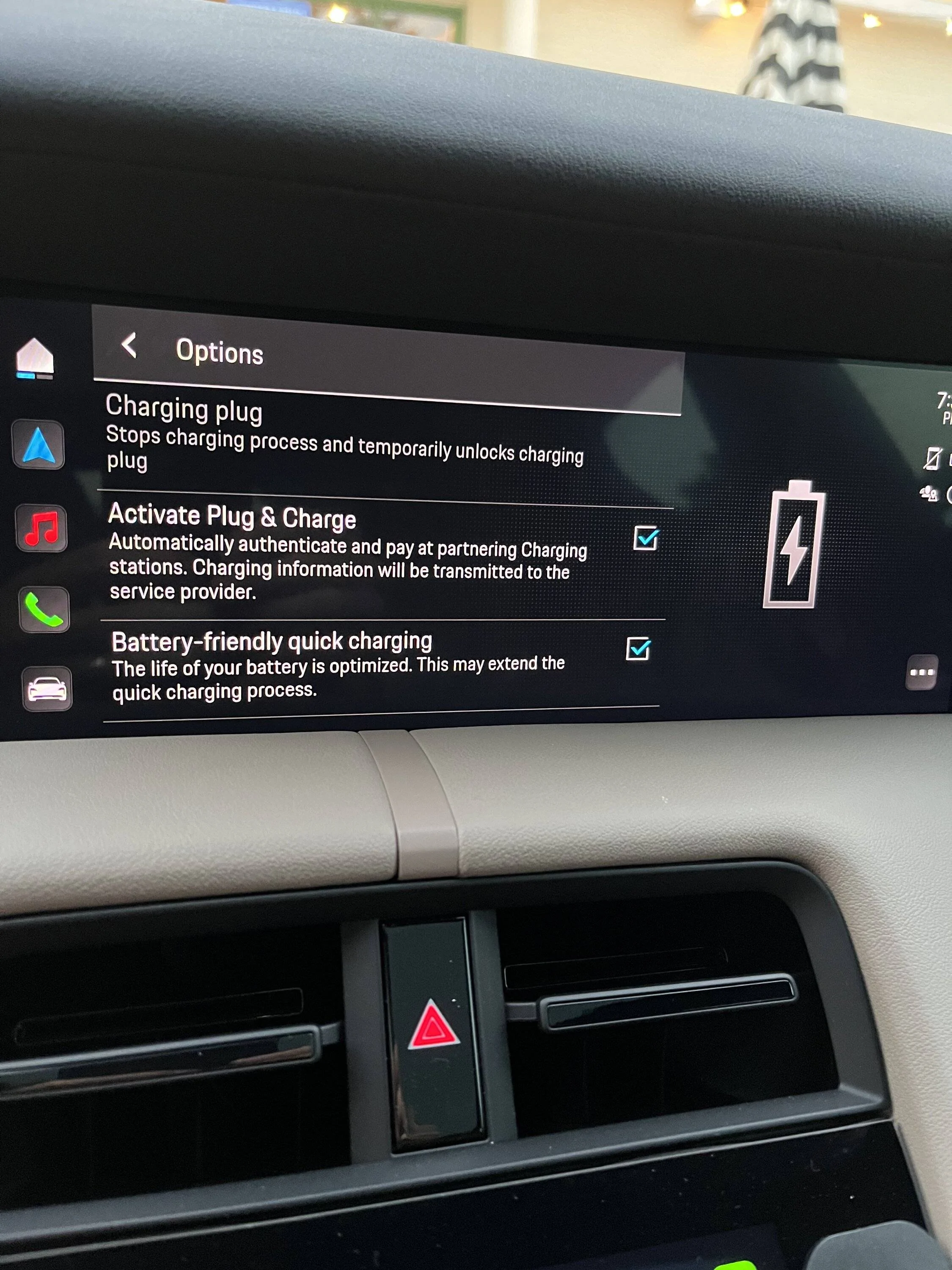

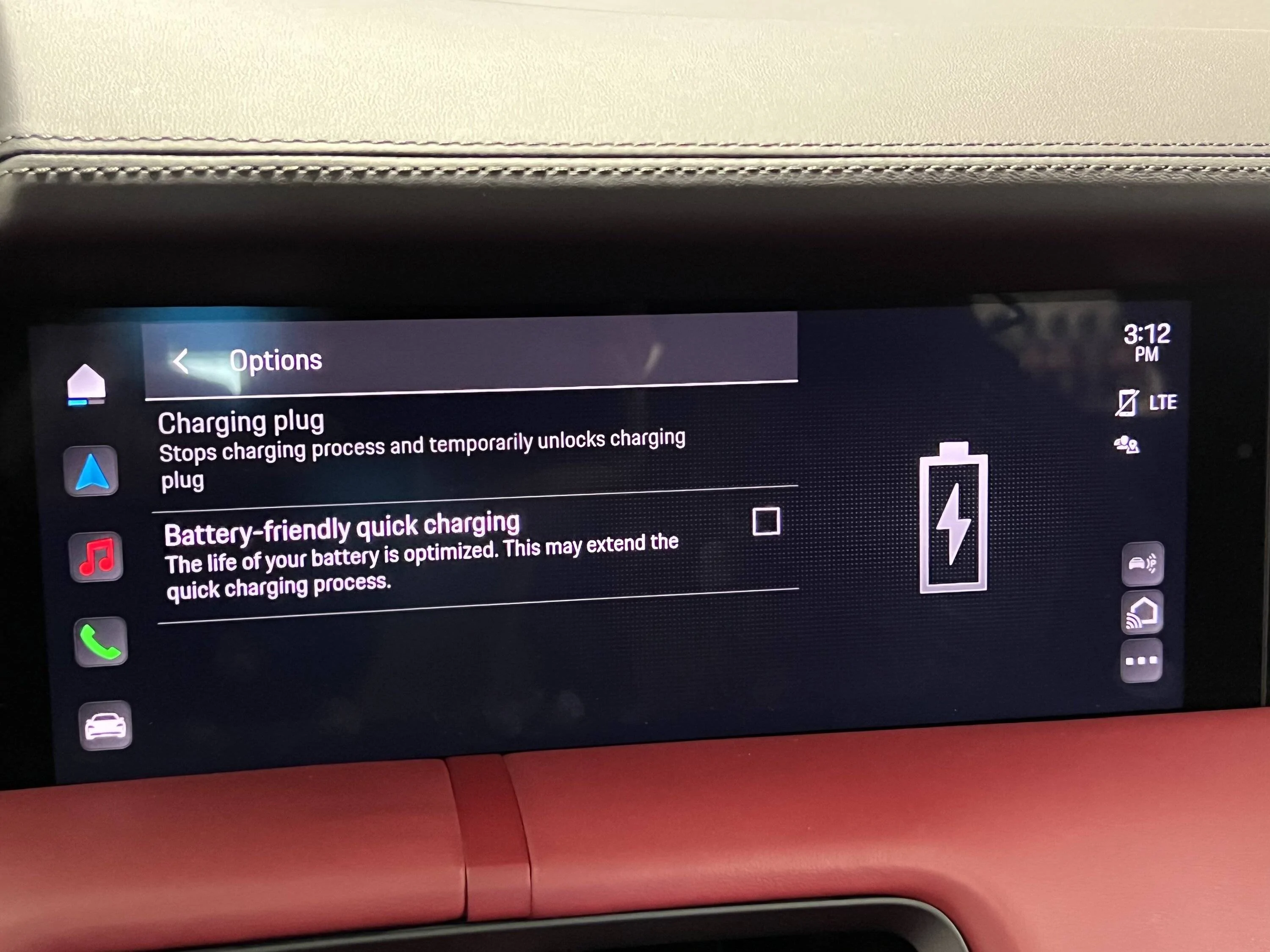

yes, that option has completely disappeared from my PCM now. It was there before and enabled, but now the whole menu item is gone, so nothing to enable or disable exists.

thanks, but as i said, the middle option is no longer there.
In case anyone else runs into this issue. A Factory Reset resolved the problem. Took 30 min to run the set up assistant and reenter my personal settings, but the plug & charge option is now correctly displayed in the charging options sub-menu again.
