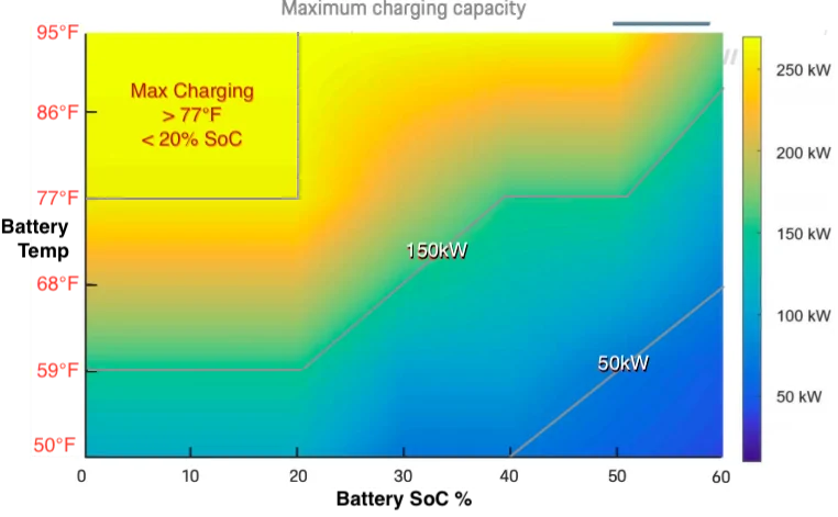

So charged at EA for the last two days, can’t figure out what has changed, used two different 350 chargers and a 150 charger and nothing above 65kw, been doing this a while, anybody else have this experience? Now the connecting and charging are flawless, but speeds, meh. I used to always get at least get 150kw, using ea app, will try the Porsche app next time.
What app you use to start the charge should have no connection to what speed you are seeing. What might be the factor are things such as SOC (State of charge), and Battery Temp. See chart below.
I'd suspect that there are a mix of other factors here too, such as the charger itself can be flaky. But assuming you are using the same charging stall, and the battery and SOC are the same, you should see 150kW. But if the battery is cold, or the charge is more full, you will see a lower kW/speed.
I used the charging america app, could be the cold weather, next time I charge, if it happens I will call EA and have them check their charger just for the heck of it, didn’t know if I was the only one having this issue, I am in Kentucky
