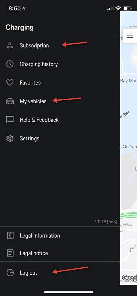

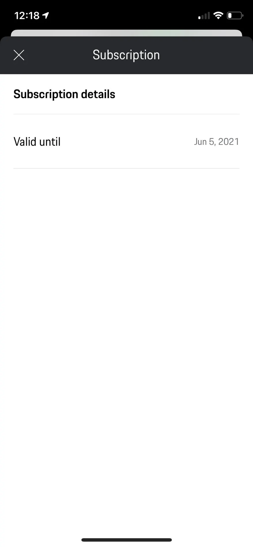

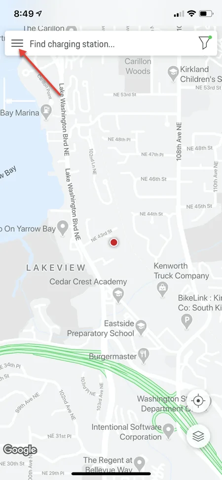

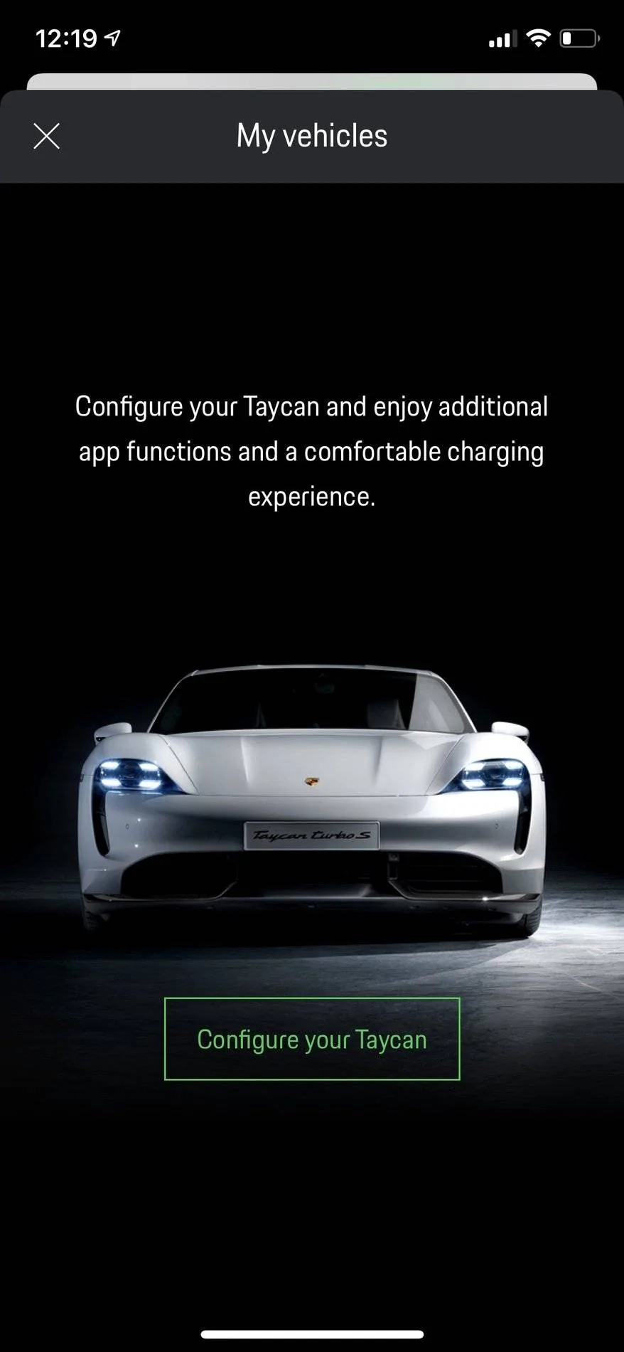

I found by trial and error that the steps to use EA were --
  1. Login to the Porsche Connect App (or via the website) and accept the free 1 year charging offer. This includes providing a credit card even though this will not be charged if your session is <30 min and you are within 3 years of purchase.
  2. Download "Charging America" app from the App Store on your phone. Go through the menu in the upper left to login to your Porsche Connect account, and configure your car and double check that your subscription is valid.
    Porsche Taycan Charging Your Taycan Demonstration Using Porsche Connect App Electrify America 1
    Porsche Taycan Charging Your Taycan Demonstration Using Porsche Connect App Electrify America 2
I'm already logged in, but where you see that option you'll find "Log In".
Seems to work like a charm after these steps for me.
