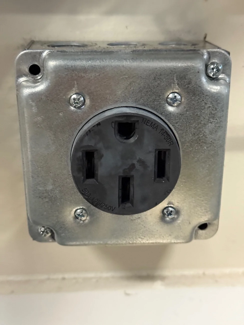

I had my electrician come by to replace the outlet with a Hubbell EV-rated one - it was beefy enough that he had to install a larger enclosure! I am also keeping the Chargepoint charger, so I spent some time wall-mounting it behind my shelving.

Yes. The Hubbell NEMA 14-50R receptacle takes a faceplate with a larger than normal diameter hole and a deeper receptacle box than normal. If your electrician has not installed a Hubbell before, let him know in advance.

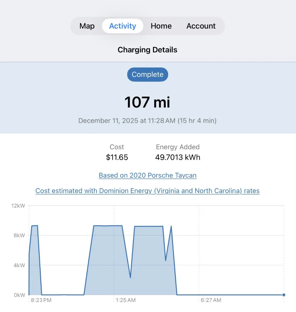

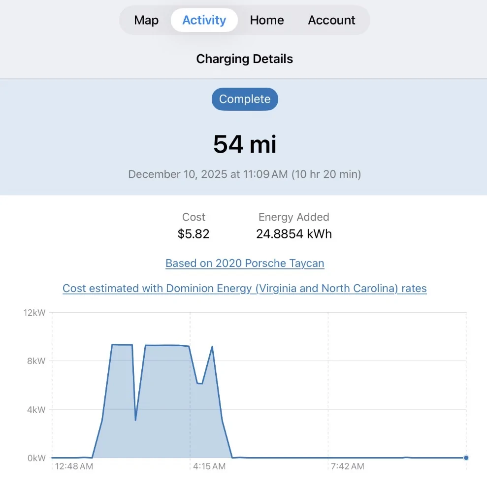

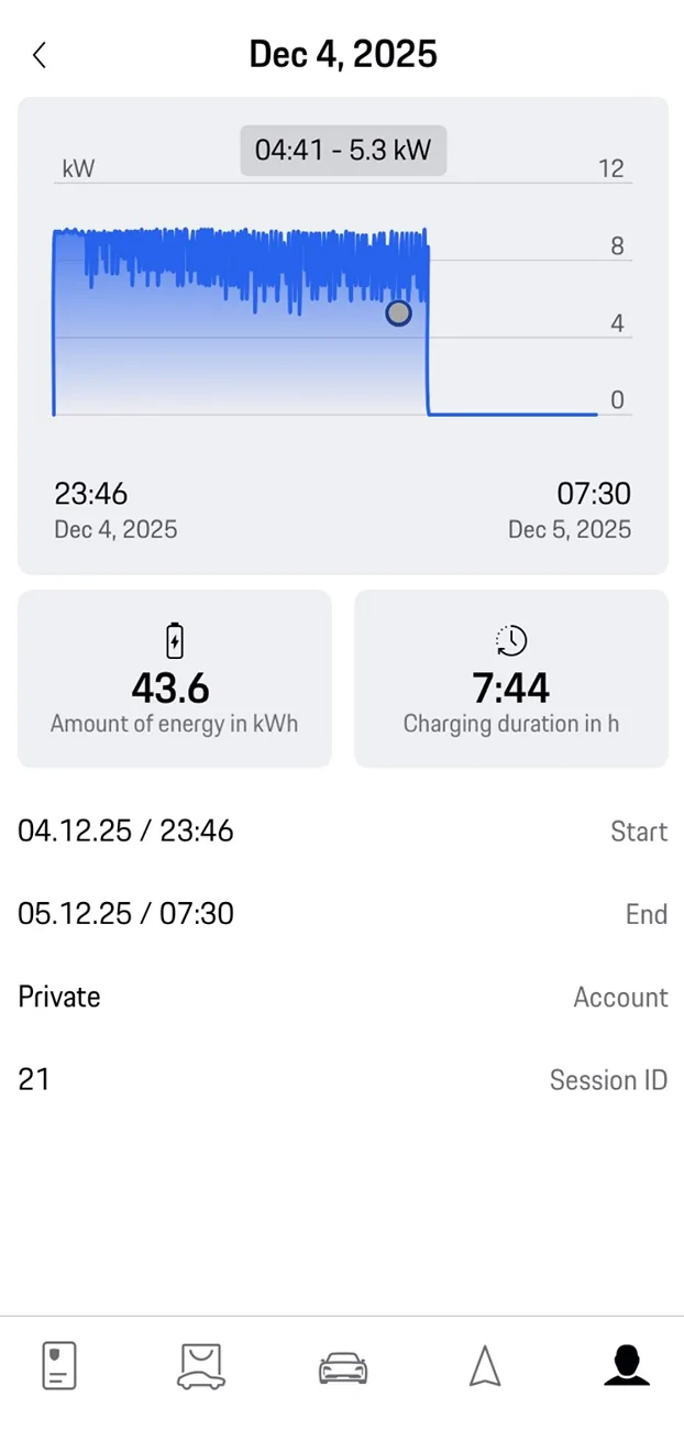

Here are my last 3 charging graphs - I see a few dropoffs and a max speed of only 9.3kW, but every day it’s charged and ready by 5am (my profile). If everything looks ok to you all, then I will stop worrying about my charging (unless I get an error).
Porsche Taycan Uneven home charging issue using Porsche Mobile Charger Connect? IMG_0415
Porsche Taycan Uneven home charging issue using Porsche Mobile Charger Connect? IMG_0414
Porsche Taycan Uneven home charging issue using Porsche Mobile Charger Connect? IMG_0413
193
7,028
10,511
looks good - drops are normal as the software pauses or slows charging for thermal management and departure time target reasons…
