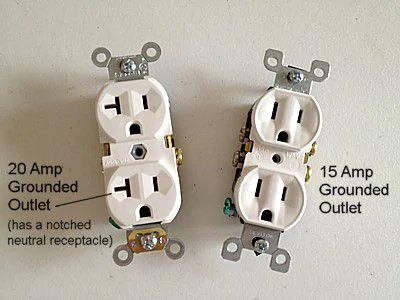

No certain, but I think its actually a bit longer, depending on your actual circuit. Most equipment only uses 80% of a circuits capacity. In the US, your common 110/120 volt circuits are 15 and 20 amps. At 80%, the chargers would use either 12 or 16 amps. Multiplied by the voltage, the fastest you could charge is at 1.44 kW or 1.92 kW. Divide the battery by that rate and you get somewhere 65 hours for a 15 amp circuit or 48 hours for a 20 amp circuit, for a full charge. (You can tell amperage of a receptacle by looking at it, like the left one below.)
All this assumes the charger and inverter support these rates. At least this how an accountant (and not an electrician or engineer) figures things out, so quite possibly wrong. ;)
