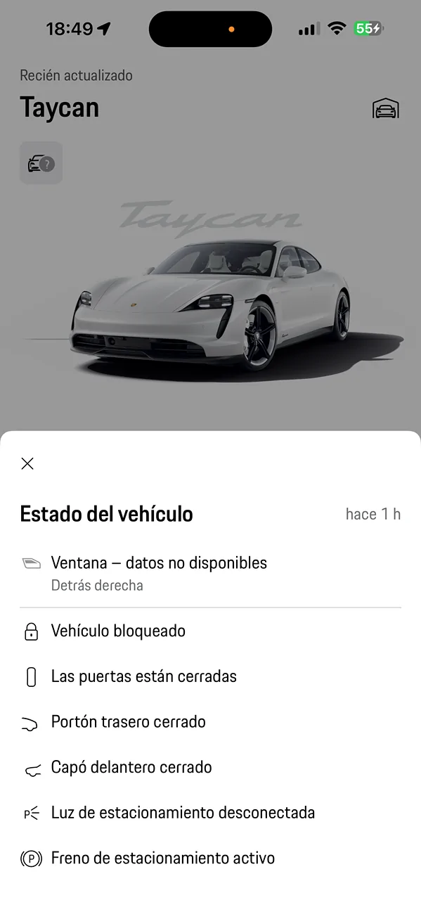

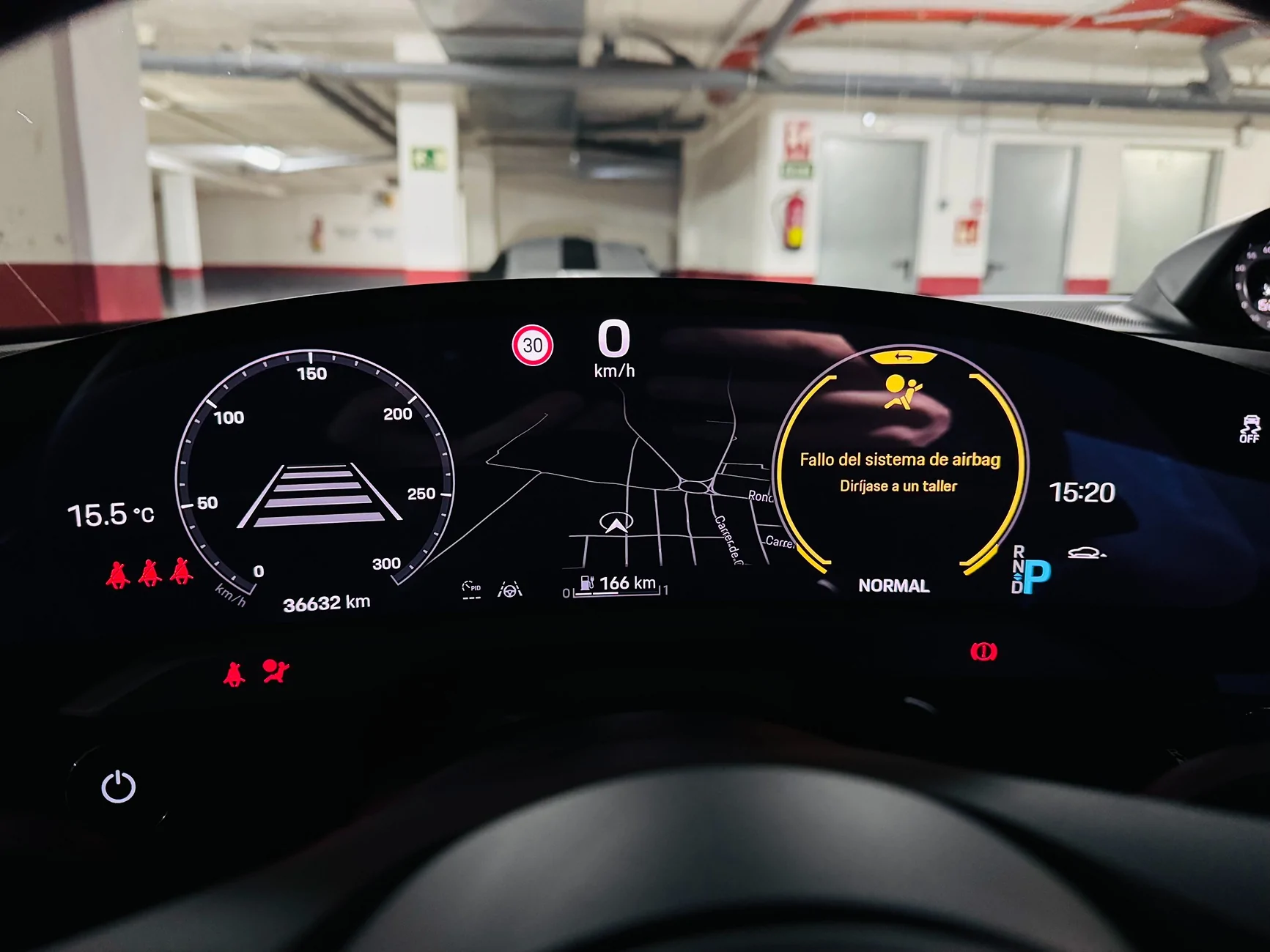

Good afternoon, I need help. I had vinyl wrap installed on my car and now I'm getting these two errors:
1) Airbag malfunction
2) The app only shows an error with the rear right window.

Parking Lights - when the car is powered off and you flick the indicator as if to make a right or left turn this will illuminate the front DRL and rear tail light of either the left or righthand side of the car - useful when parking to illuminate a given side of the car in a poorly lit area. The message therefore is simply saying the lights are off and not illuminated. Most if not all cars have this feature.
Airbag error - possibly a false positive due to the wrap covering a front sensor but get it checked.
Window - learning procedure in the Owner’s Manual.
