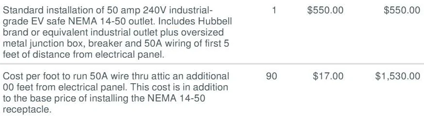

Just got a quote for $2,080 for a NEMA 14-50 install. The 50 amp 240V outlet, box, breaker and 5ft of wiring was $550 which I felt was in line.
However, they want an additional $1,530 for a 50A wire run through my attic from the outlet to my main panel (opposite side of the house from the garage). Front of the house is 60feet (they estimated 90) and I realize we have to go up the wall, but that seems excessive. I have a very open attic and have run Cat 5 myself easily in similar areas.
Does the additional wiring seem too high in comparison to others who have completed the install?
it sounds to be a bit on the high side, you should get another quite from a different electrician and also reconsider the placement to lower costs.

No that was from Tom’s guy (I had called him before you posted Andre’s info. Going to give Andre a call.
I really cannot change the location of where the car is parked. My panel in the garage (which has all the house breakers) has no room for the new service. My main panel does (by the meter) as I had it replaced.
Getting a a second estimate is always a good idea.
Depending on the attic space - code may require the wire to be in conduit or otherwise protected.
Did they provide a price breakdown for labor and materials?

Only two breakdowns. The 14-50 plug and materials $550 and the second was 90feet run of wire through the attic at $17 a foot.
I searched the cost of the wire (in conduit or not) and 500 ft was not that expensive. If they are charging for the labor to run it, I can have it ready when they arrive.
the $550 for the hardware is costly

Here is how it was listed. Waiting on a call back on my second estimate.
