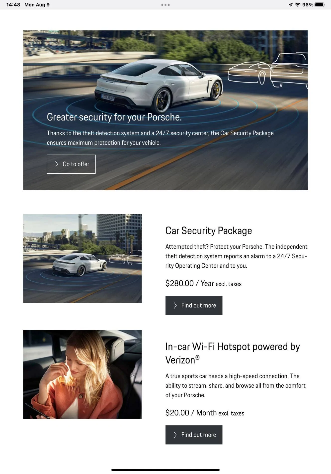

Thanks for that. Here's a screenshot of what I see when I log in. Am I to then assume there are no FoDs available for my specific VIN other than these?

I have not accessed it through my phone, but I can clearly see it on my laptop when open in a web browser.
You log into your "my.porsche.com" website account, and you'll see a menu on the top. Click on the word "SERVICES" and a list will appear ... your OTA / add-ons will appear at the very bottom under "RECOMMENDED SERVICES".
It's not very intuitive but that's how I found it.

Thanks. I did that and it looks to me like my options are limited to my screenshot. I was hoping to add the Innodrive option. Doesn't look possible.

It's not possible if you don't have ACC specced. Innodrive and ALK require the ACC hardware in order to function.
For example, my car came with ACC but I'm able to add Innodrive and ALK as options. I did the latter for my recent road trip (3 month trial).
