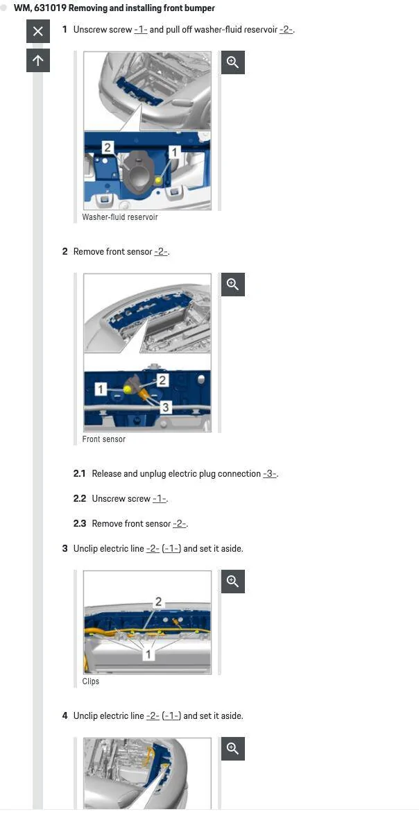

Anybody have a DIY for front bumper removal? See them on youtube for practically every other Porsche, but not much of anything for the Taycan.

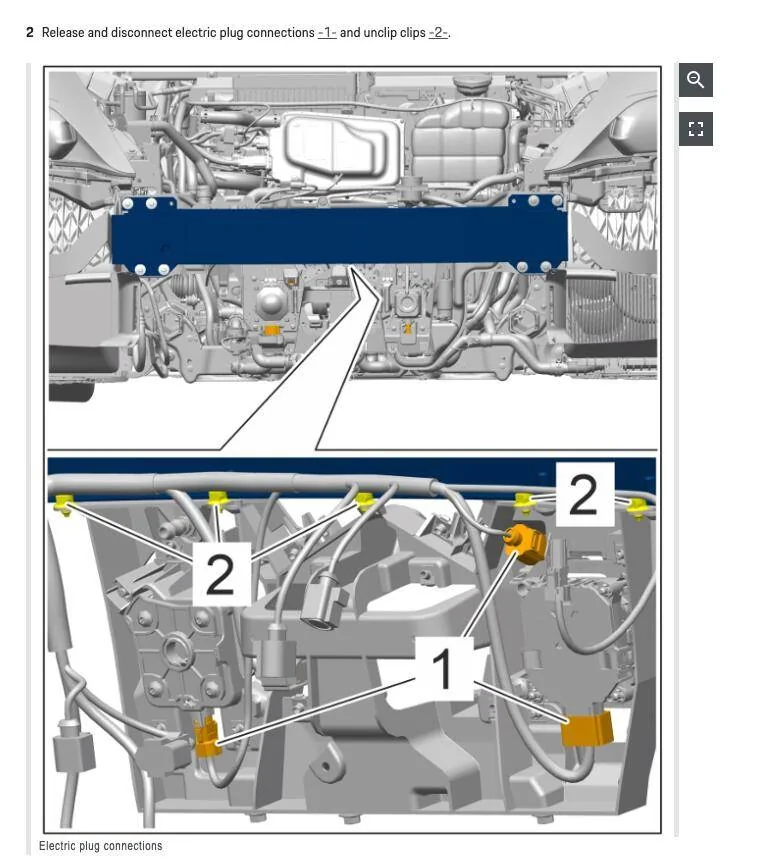

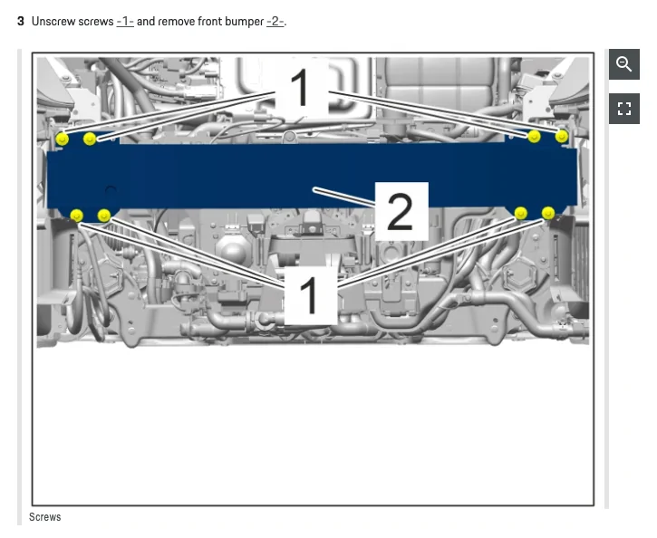

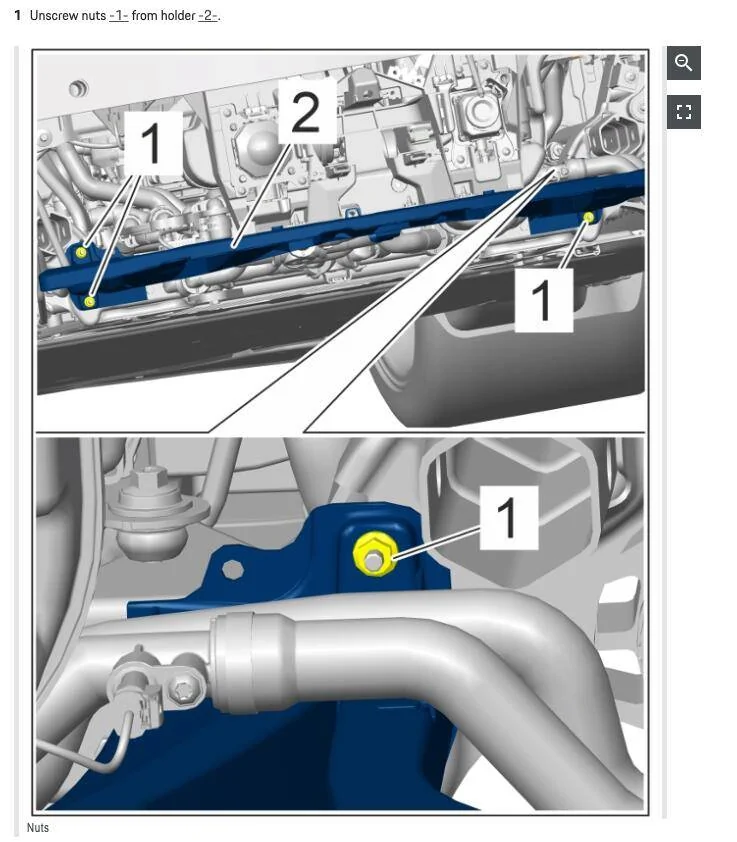

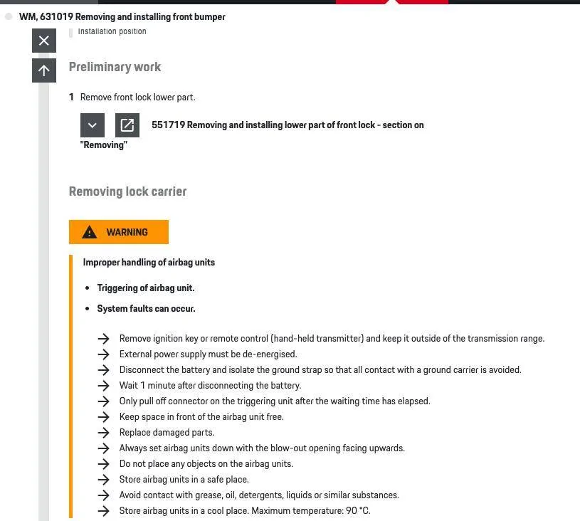

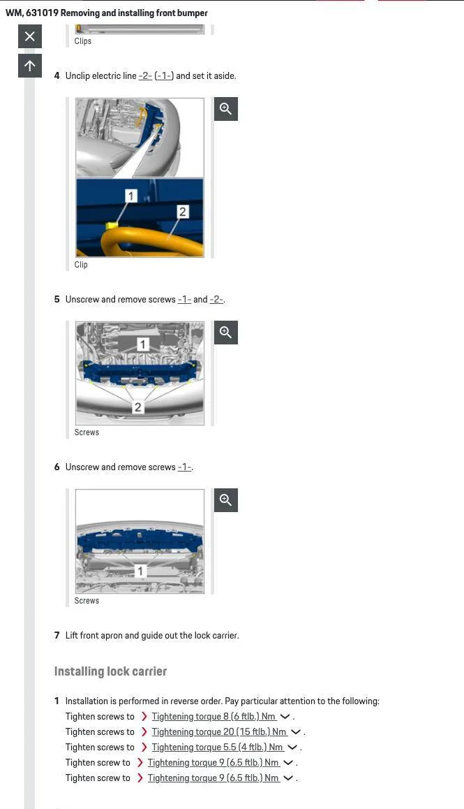

Here's some screenshots. I can't post or send the PDF because my employee ID is attached to it. Hope this helps.
