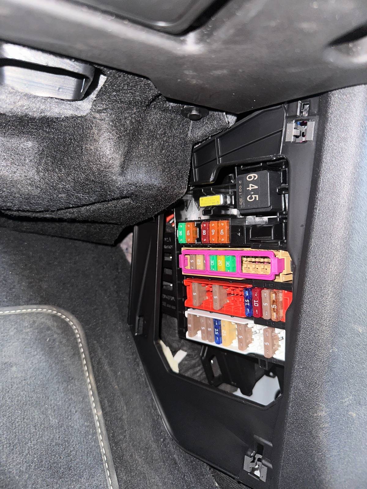

Can anyone direct me to any information on the frunk fuse block that is beneath the plastic panel just behind the storage compartment? I do not believe this fuse block is discussed in the owner's manual.

Top Left Row:
5A Prepared for AWC induction charging
5A High-voltage battery
5A High-voltage converter
15A Relay no. 30
Not used
30A Relay no. 50
Not used
Not used
Not used
5A EACC (refrigerant circuit)
5A High-voltage heater (heating circuit)
20A Coolant pump PB (TME1)
5A High-voltage heater(heating circuit)
5A Servo motor for radiator shutter 1 +2 (front bumper)
Not used
Bottom Left Row:
5A Sounder (siren)
7,5A Front charger
5A High-voltage booster
30A Relay no. 40 (TME3)
5A Pulse-controlled inverter (PE)
5A Control unit for front anti-roll bars (PDCC Sport)
Not used
10A Drive system
5A Change-over and mixing valve 2 for TM
10A Drive system
The relays are for the cooling system. Let me know if you need the info for those.

Is this the place we are talking about?
Porsche Taycan Fuse assignment for fuses in frunk? image

I want to find: 5A Servo motor for radiator shutter 1 +2 front bumper
