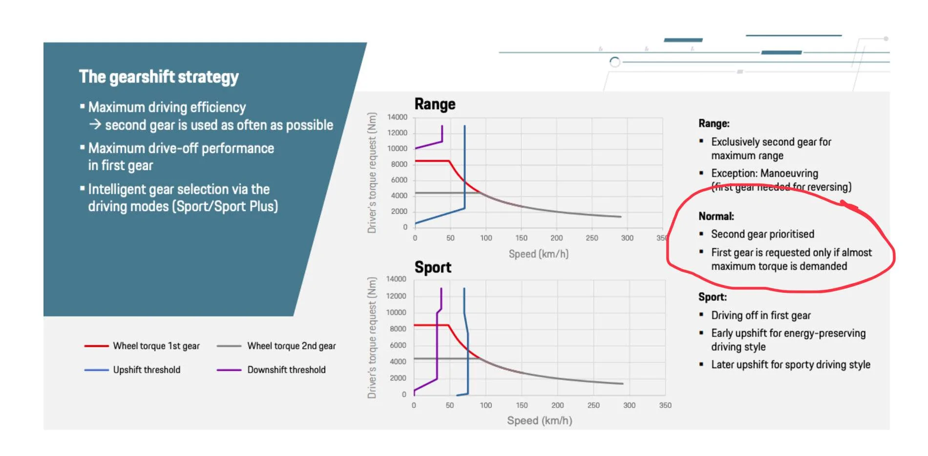

Regarding the graph and when downshifting to first gear occurs
Porsche Taycan Gearbox behaviour E6CD4277-229D-4229-BA40-B44744EC7B74
Gubbjaevel
F
Jun 20, 2020
228
368
Sweden
TaycanT'20
I was sure until about 2 minutes ago.
Read comments that it downshifts in normal before. Knew I read documentation saying normal and range is exclusive in 2nd, so I tried it. Did not downshift. Perhaps I didn't push it all the way down, perhaps I didn't have low enough speed. (Graph indicates it only downshifts < 40km/h - I might have tried it above that).
Will try again. Hate being wrong.
Edit: Ping @bgatxy1 @kreshi You are right, I was wrong.

Thanks for the info, so it does downshift in range/normal and upshifts at 75kph. There is a clear audible change, with sport sound on, at around 80mph when on full throttle, must be in the sport sound program.
