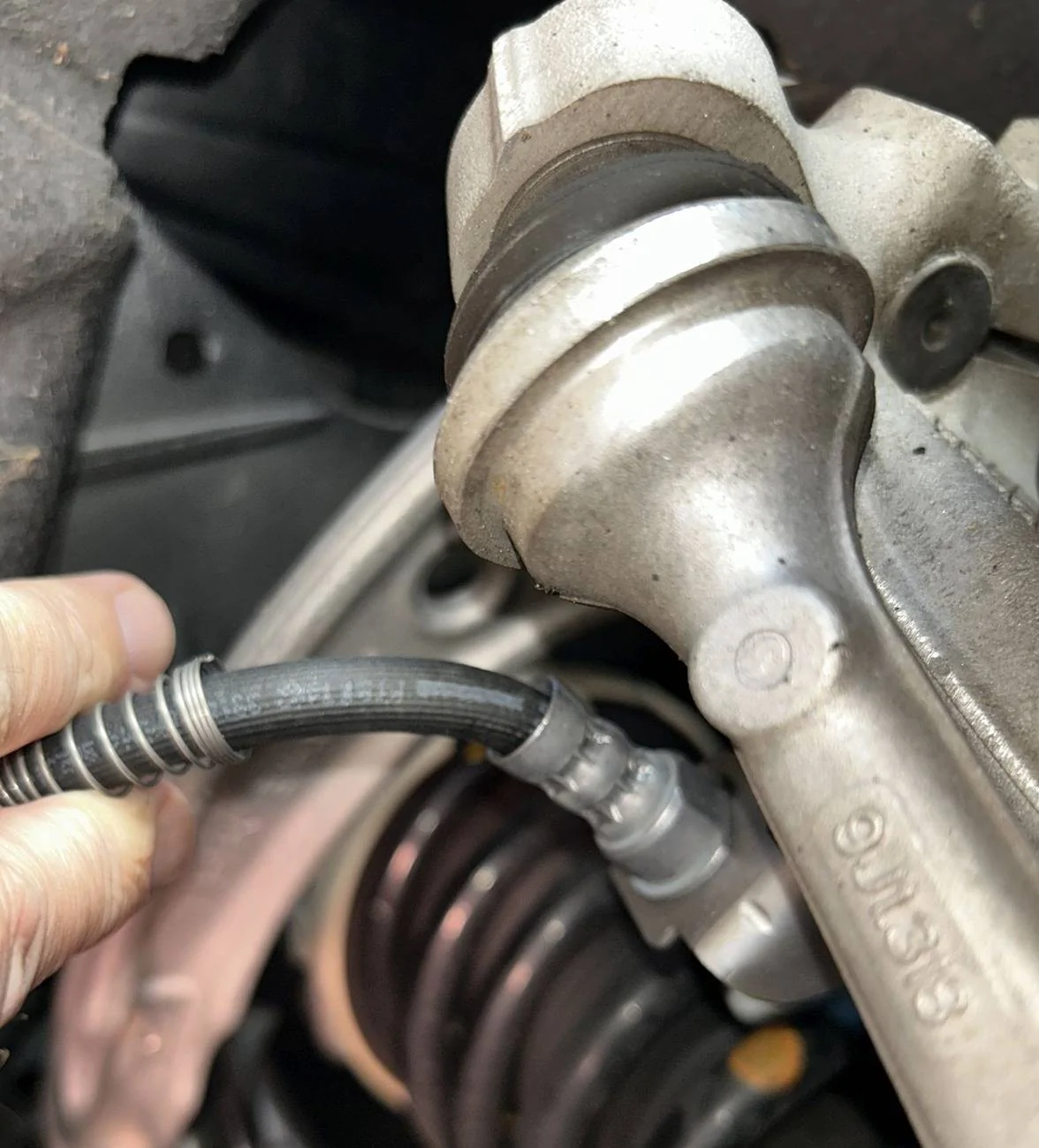

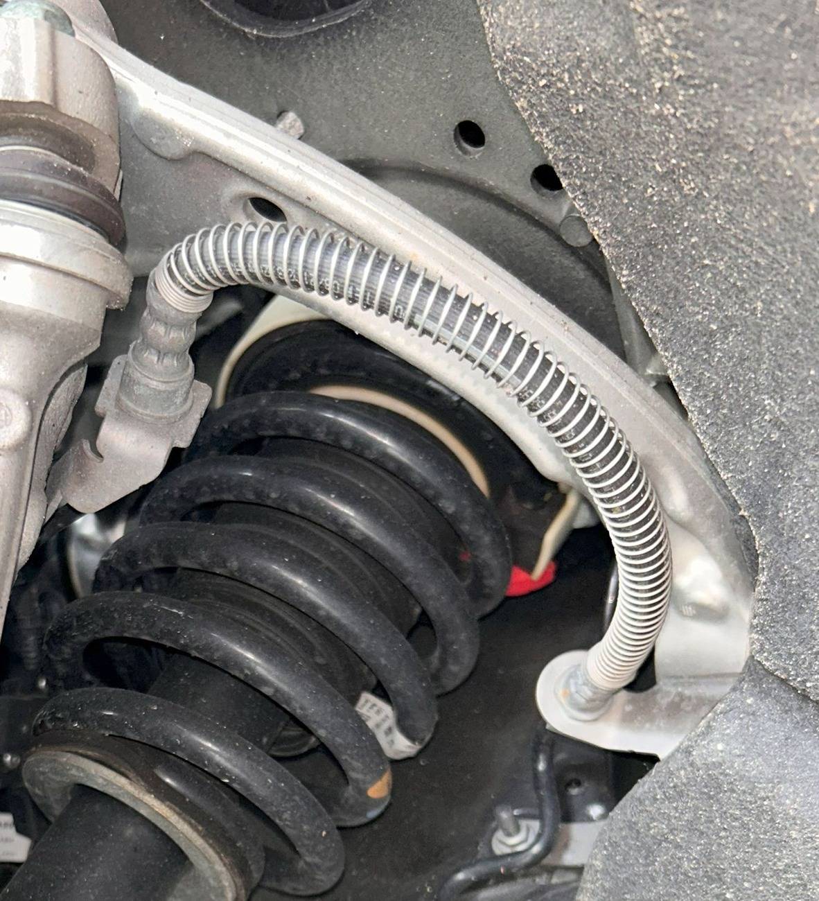

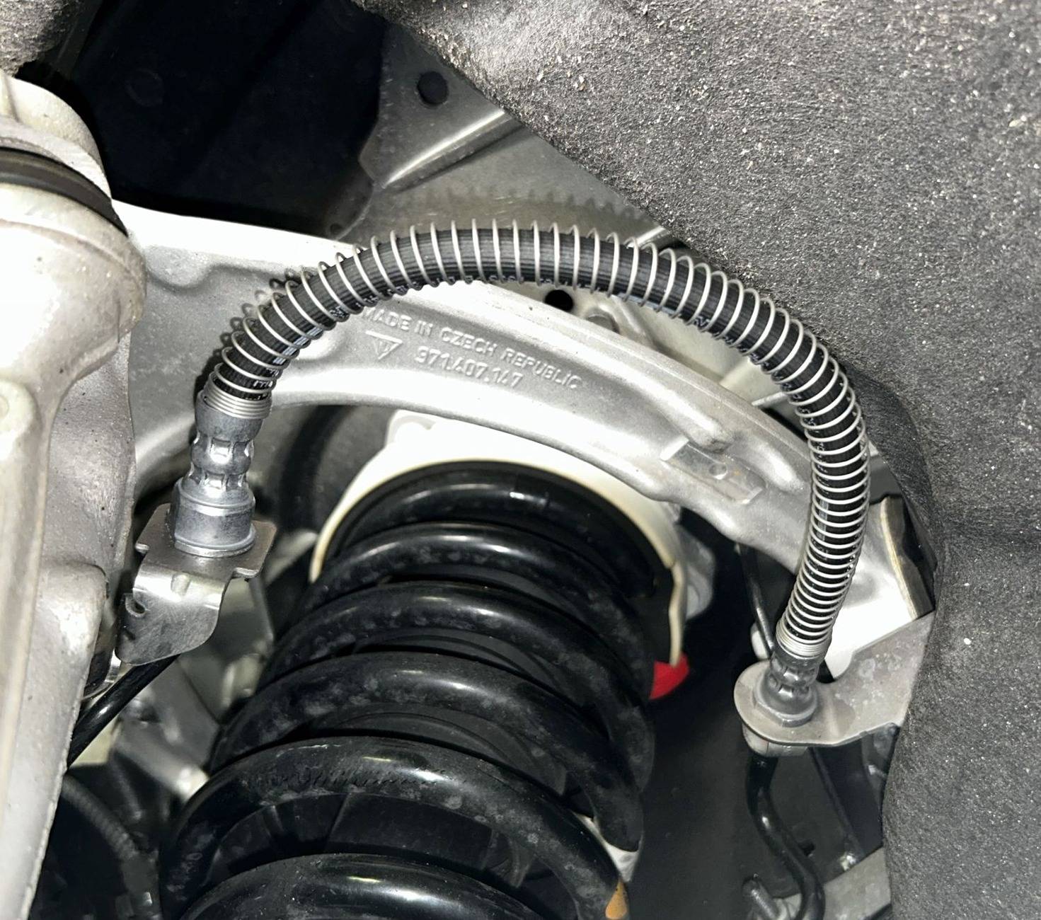

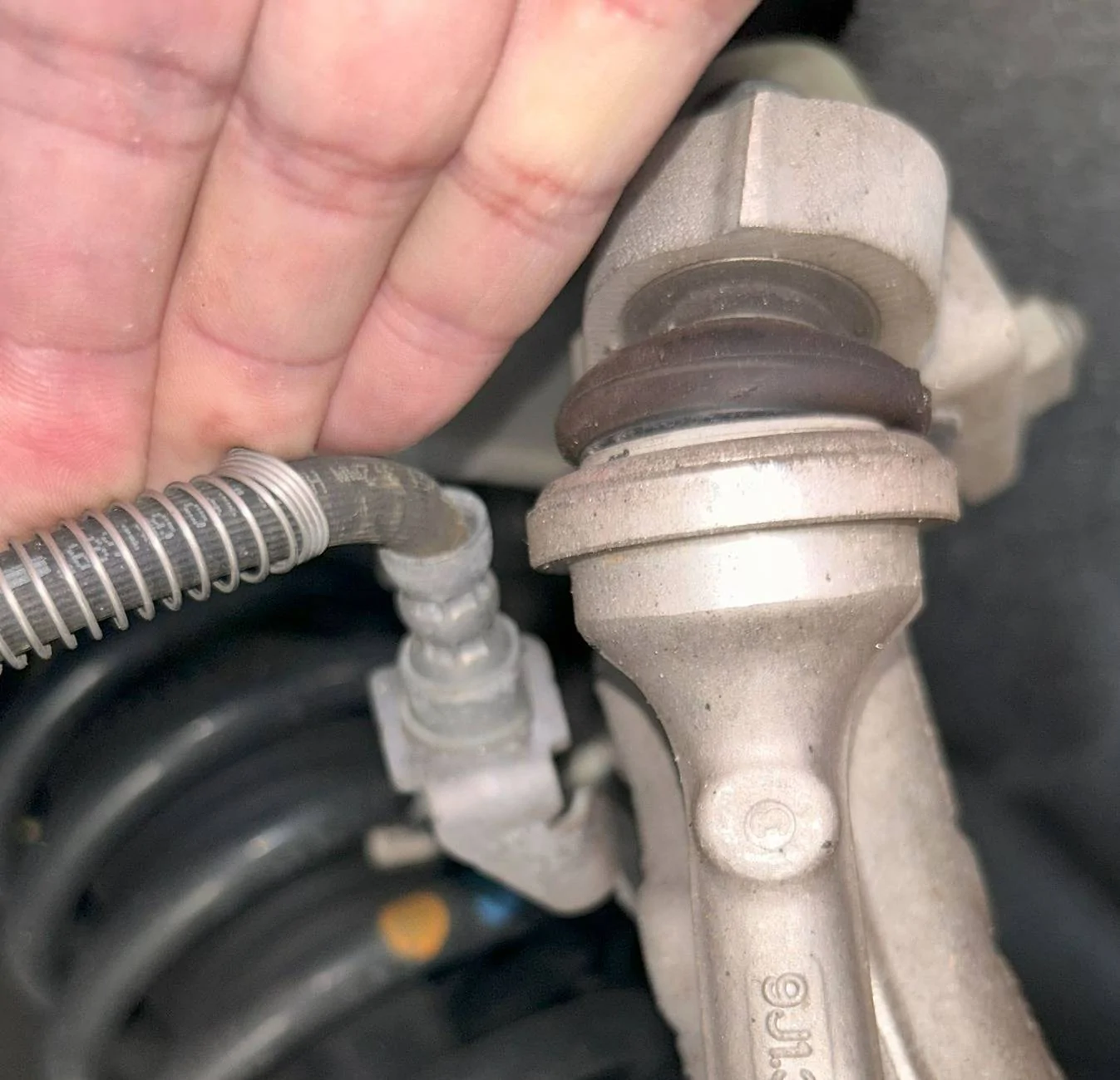

Called to schedule, and my Massachusetts dealer said they book a week out to have time for parts to arrive. They got the hoses six days later and did the work. They report doing the ARB0 and WPK0. The hoses are longer and the inboard mount is different. I had no complaints with the brakes before and I didn't feel much difference in braking action for my car. Others have said there is an improvement. Actually, after a couple of days, I do feel that at low speed, the brake pedal is higher and firmer.
Porsche Taycan got the ARB0 brake hose recall and WPK0 PSM reprogram done left_before
LEFT BEFORE
Porsche Taycan got the ARB0 brake hose recall and WPK0 PSM reprogram done left_after
LEFT AFTER
Porsche Taycan got the ARB0 brake hose recall and WPK0 PSM reprogram done right_befor
RIGHT BEFORE, sharp bend at the fitting (true for both sides)
Porsche Taycan got the ARB0 brake hose recall and WPK0 PSM reprogram done right_after
RIGHT AFTER - much better (true for both sides)
LEFT BEFORE
LEFT AFTER
I did not feel any pedal difference except a much better linear stopping deceleration between 20 and 0 mph. Less squeak Noise as well on my PSCB rotor. Overall this is a good resolution.
