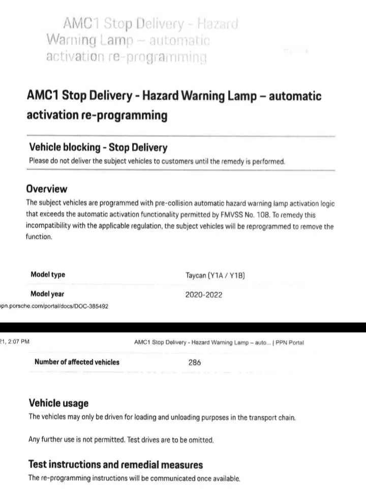

can anyone clarify exactly what this issue is? is it the one about the latest recall when you receive the red screen that says driver must assume command and power is cut?
The issue is related to the hazard warning lamp auto activation that needed to be reprogram. It was considered an stop sale. All cars in ports and dealers were waiting for this update since early October.
Yes, it is. According to everything I've read, there's an inertia sensor in the airbag control module and input from the ADAS which throws on the hazard lights when the car senses an accident is imminent it throws on the hazard lights.
This violates Section 108 of the Motor Vehicle Safety Standards and the NHTSA even went as far as to tell Porsche that the function would "confuse other drivers". The fix is apparently a recalibration of something in that airbag control module and a firmware flash (they could be synonymous, somebody that's received their car should be able to tell us).
