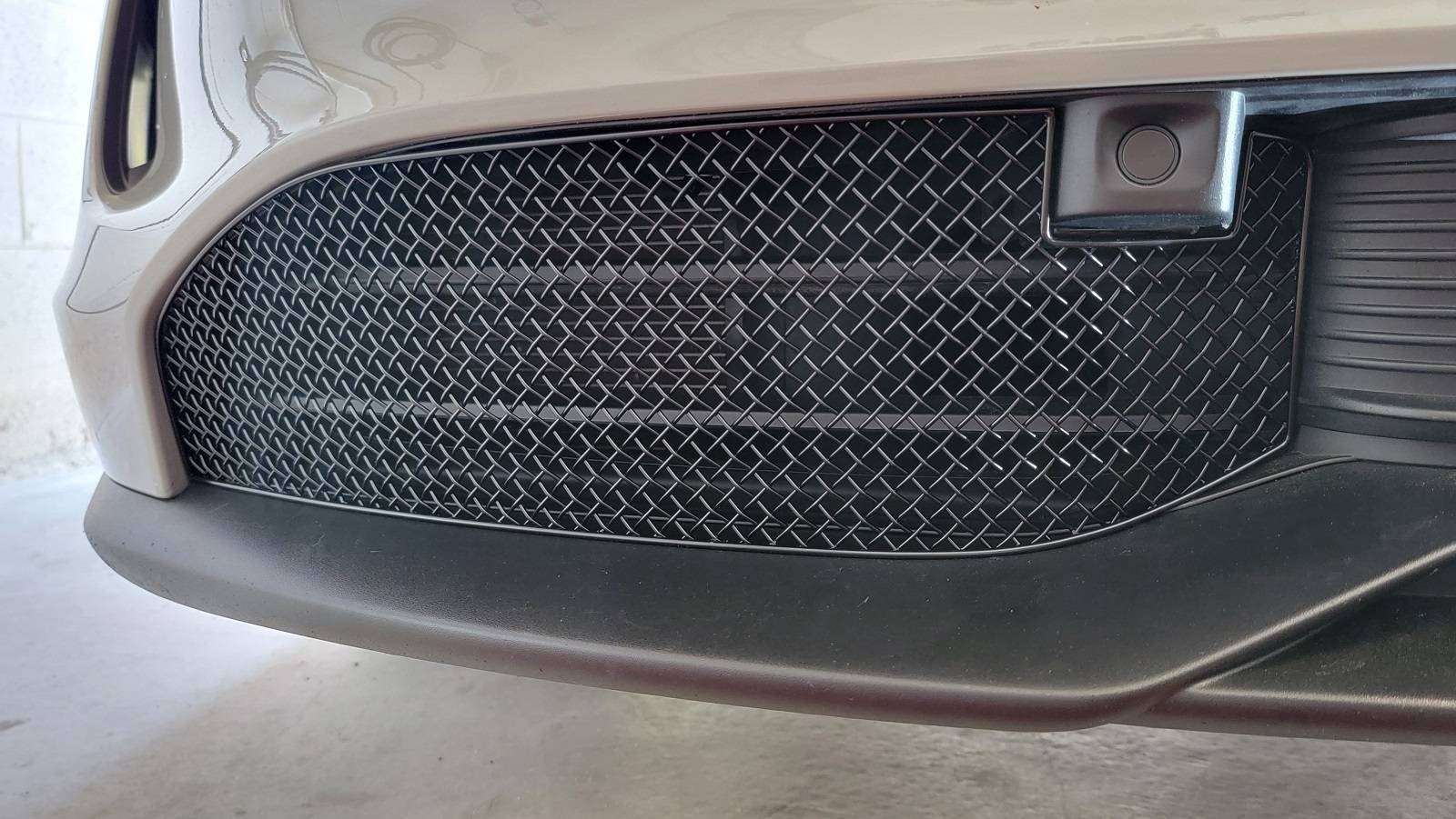

Radiator guards are my recent insurance policy against this.
Porsche Taycan Hit a rock, noise from fan 20240310_135122
they look nice although in my case it wouldn't have helped because it was the underside that got damaged. Hoping my temporary fix lasts the 2000km journey home ?

Looks well. Is there a post about that?
Yes, it's in the modifications section with photos.
Yes, they certainly won't help in all situations and sorry for your circumstances leading to the damage. Hopefully the permanent fix goes well for you.
